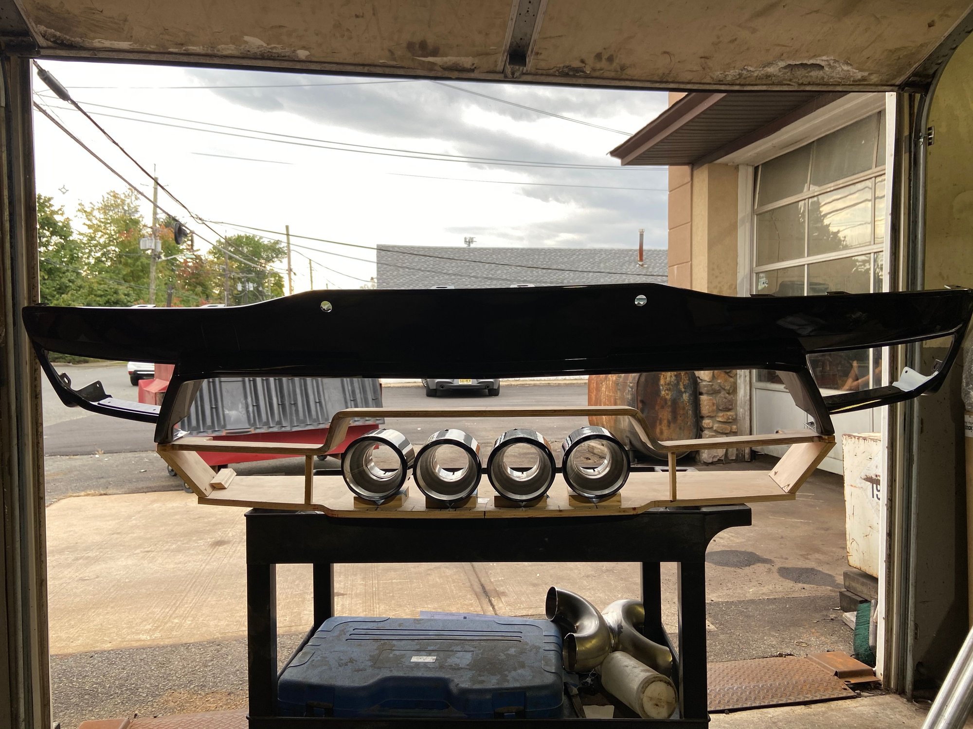

I will be making a complete exhaust, this winter. I have all the parts and will start fabricating next month, soon as the weather in New Jersey turns into non corvette Driving conditions.
I own my own shop with a bay and lift for the corvette. I started with making new rear bumper. Making them exit from the center. Where they look the best.
This is a early pic. Since then I raised the tips up. More even with the stock pipe exit hight. I will post more after the bumper is finished
