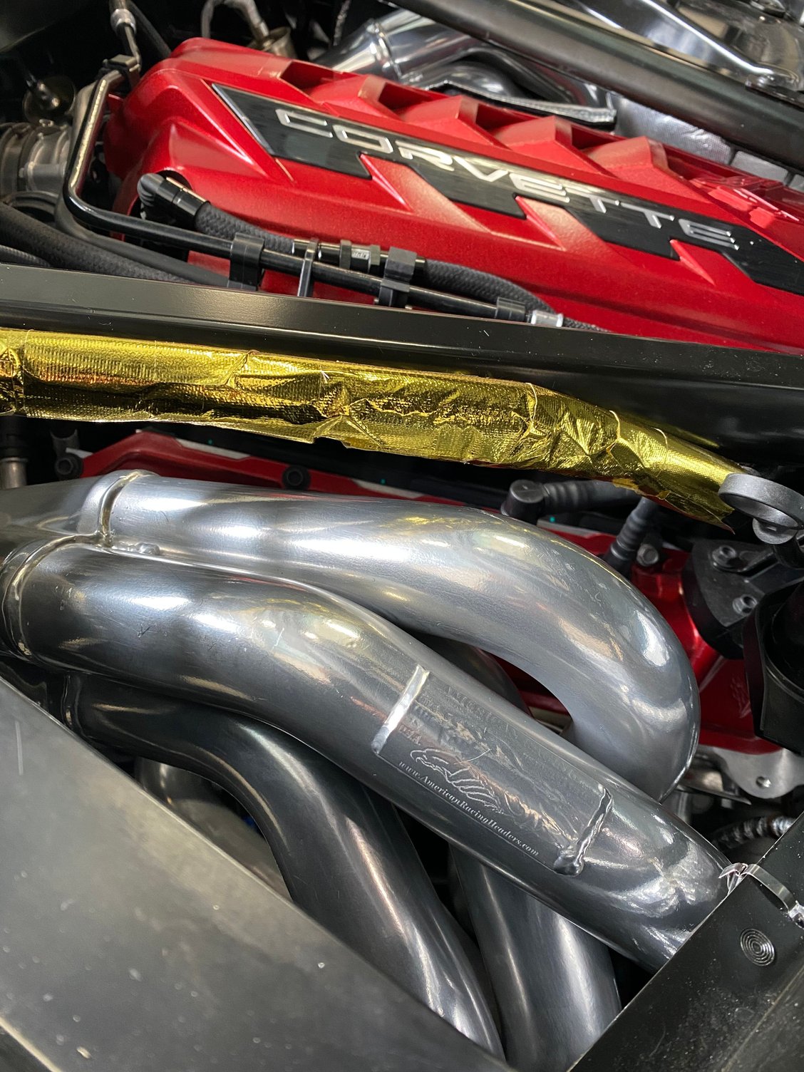

left the fuel line in the stock location, but went over the top of the brace. I have the carbon fiber covers but like the look of the headers vs. the covers.
Looks great, do they come catless?

Originally Posted by c5racr1
Thanks.
Looks great !!! You don't really need to go over the brace on the passenger side, that line is vacuum and not fuel. Also I think the reflective heat shield faces in and not out but its preference more or less. ARH FTW !!!

If the heat shield is reflective, wouldn’t it need to face out to reflect the radiant heat?

I changed the wrap on the line. Used race tech heat wrap, and gold reflective wrap on top of that. That’s that
Did your headers come with the jet hot coating or did you have it done.
To ARH headers
Old Nov 11, 2020 | 10:51 AM
c5racr1's Avatar
c5racr1
Joined: Feb 2000
Posts: 3,426
Likes: 568
From: new orleans
I got them from RDP a vendor on here. Took about a month but coating was a option. And I’m glad I did it. The engine bay is cooler than with the stock manifolds during operation, and it cools down quicker.
