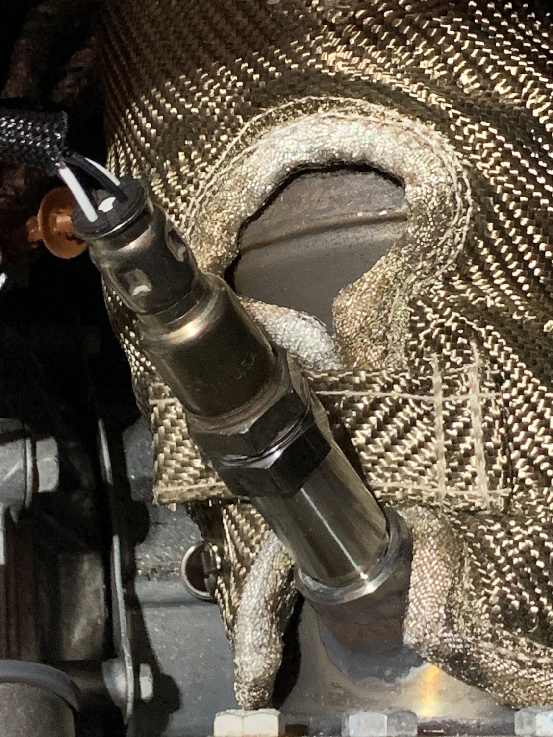

Got the Big Daddy Garage mini cats in today. After 70 miles so far I’m running good. It was coming on after just 10 miles every time I reseted with scanner/ battery. I had a great faith in this product for ever car I’ve ever ran required this particular mod rather if it was just O2 extension or mini cats.
I do feel most all cats will be fine under normal conditions. IMO after several track weekends it wears and will expose these common issues.

Glad they fit! Are those Kooks blankets?

Yes they are.
