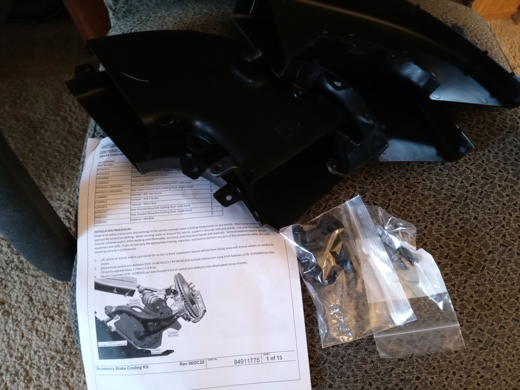

Our C8 came with the brake cooling duct in the trunk? I was going to have the Dealer install them and they said they are for Track only?
They suggested to not install them for everyday driving? Anyone else know anything about this? I guess I don't see what they would hurt?

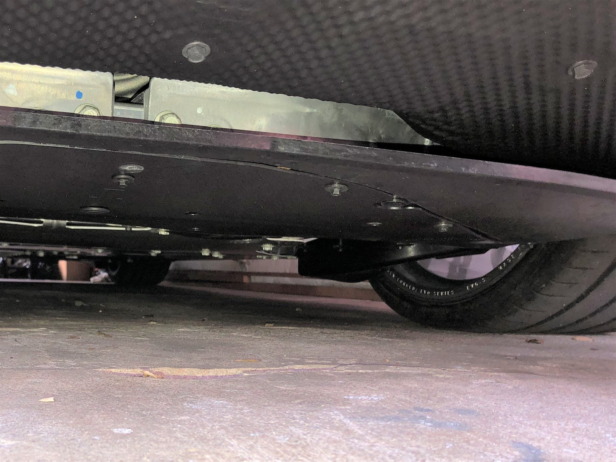

Ground clearance would be an issue on the road, you'd rip them off along with who knows. Hence track only.

I had mine installed.
Plenty of clearance even on lowered car.

I installed mine and haven’t taken them off. The front ducts don’t hang down so I’m not taking them off. The rears are 2 piece and you can remove the part that hangs down if you are worried about ground clearance.

Can someone with the rear ducts installed and standard ride height measure the clearance of duct. The place should make going over speedbumps, or driveways head-on, no problem. I am wondering is a soda can on its side a problem, a squirrel, ......?

Speed bumps are not an issue because the ducts are by the wheels. As I stated, the rear ducts hang down 2-3” so they could be damaged by road debris. Front ducts don’t.

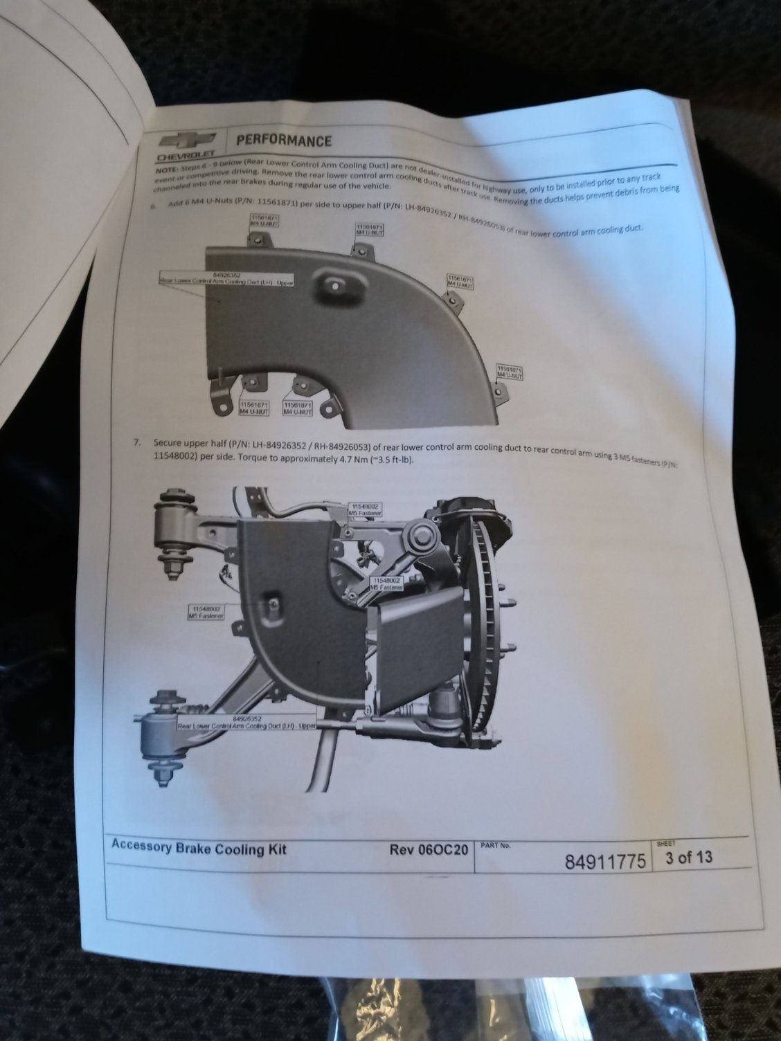

Here is the official Owners manual info. Page 183 in manual.
Brake Cooling Kit Prior to any track event, high speed driving event, or competitive driving, the following should be completed: . Ensure all brake cooling parts are correctly and securely installed. . Install the rear lower control arm cooling ducts per the instructions below also included with the kit. After any track event or competitive driving, remove the rear lower control arm cooling ducts. These parts are for track use only. Removing the ducts helps prevent debris from being channeled into the rear brakes during regular use of the vehicle. . Inspect for and remove any blockage in the ducts. . Inspect and replace any duct that has damage. Passenger Side Front Shown, Driver Side Front Similar 1. Front Brake Cooling Duct 2. Front Lower Control Arm Deflector Passenger Side Rear Shown, Driver Side Rear Similar 3. Rear Knuckle Mounted Cooling Duct 4. Rear Lower Control Arm Cooling Duct
GM doesn't want to recommend the cars have the ducts installed on the street since they might be held liable if debris did damage the brake rotor/pads. In reality, it is up to you and how much risk you want to take on with the ducts potentially channeling stones, sand or other debris into the brakes. The risk isn't high but it is there.

So I lost my rear brake duct - it a small animal on track and it took it out. Is there anywhere to buy replacement or should I just go to the dealer - I can't seem to find them anywhere - but the part number is: 84713462

I know this doesn’t help. But I have someone looking into making a one piece setup that’s a lot stronger.
