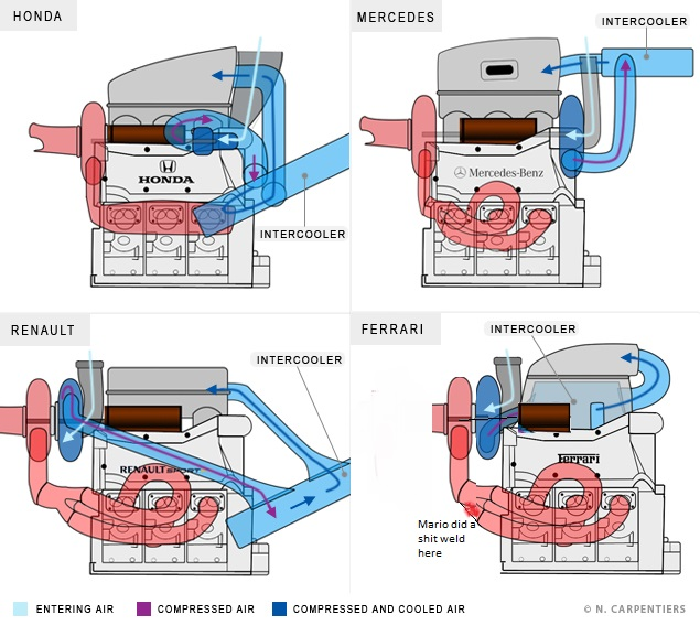

Originally Posted by SurfnSun
its a cool engine, but looks like a nightmare to work on. Hard pass from me.
Not really it has a very cool design. Where the cylinder heads are reverse. The turbos are in the valley of the engine. And the injectors are where the exhaust ports are. A awesome design, because the turbos are so close to the exhaust ports. Quicker spool up, and more power. I can not understand why no one came up with this smart design.

Originally Posted by the lark
Mercedes uses the "hot V" design on some cars. It is not ideal because it increases the pre-intercooler intake temperatures, so not ideal for power, but better for start-up emissions.
A lot. First one was a 81 turbo trans am. 301 motor. Not much to do with that. I was 17. Gutted the cats. And installed a vacuum tee that could adjust the waste gate. Allowing more boost. Also had a 87 grand national. 230 stock hp. Do the same with that. But way better results. Did a few more mods to that.
Then there was my 94 Supra turbo. 320 stock hp. I completely built that car from top to bottom. Too much to explain. Google performance auto sound September 2007. That will explain that car. Magazine cover.
I now have a 2020 civic si. Put down pipe cold air and larger inner cooler. And I did a k tune. I had a few more turbo cars. 05 sti. A old conquest.
So yes I have had a lot of turbo cars. I did a lot of Supra stuff in years past. I’ve owned a auto shop for 25 years. So I know a little about turbo cars.
Well then you should have known why the “hot V” configuration is not preferable for a performance car. They certainly didn’t show up on F1.
It seems to have worked out for Mercedes with the AMG GT models. And the new black series adds a flat plane crankshaft for 720hp and 590 ft lbs.
Do you know the engineering and packaging reasons they did that? Without that, you don't know if it was an optimization for power or compromise for packaging, or low speed throttle response to offset the low end torque. What we do know is the C8 was designed with twin turbos on the outboard side of the block. We have CAD images from GM to prove it. Hot V engines do not have room to include a free flowing tubular exhaust pre turbo, unless you want to mount the turbo well clear of the engine like they do on some Truck Pulling designs. Not optimal for a street car. It is not an a design for optimal power in a car with a low hood.
If it is optimal, why aren't they using it in F1?
I didn't say it was perfect, I said it worked out well for them. That engine makes big power and torque, has been reliable, manages heat, essentially no lag and sounds absolutely terrific for a turbo engine.... maybe the best out there. But you talk about it as if Mercedes AMG had to use some inefficient design... as if they didn't have the capital to do what they thought was best, lol. Of course they had a set of reasons for choosing it and there are always pros and cons... but they hit a homerun with the design.
Please don't throw out F1 as some holy standard.... it doesn't really apply to street cars. The packaging requirements are very particular in F1, tiny space, very small v6 and a completely different set of parameters. If anything, you would have to consider that the Mercedes F1 engine has been largely dominant for 7 years with the exception of a few Ferrari seasons and you would think that expertise and performance might demonstrate the technical wizardry present throughout the organization.
Those f1 motors are so insanely complex, Besides they have a crazy hybrid system too. No way can one of them run on the streets, properly.
Mercedes put there f1 motor in one of there hand built cars. They did but it was very detuned, so it could work on the street. Google it you will find the write up.
Mercedes used it because it met their design parameters, period. You and I do not know what they were. I do know that making your intake air hot by putting in the V does not cause it to make more power, but it will help start-up emissions. I also know cramped exhaust manifolds to make it fit in the V will not cause it to flow more air. It may allow more low speed exhaust velocity to help low end boost, but it will not help high end exhaust flow and power. Again, they did to meet their specific design parameters for power and packaging. That is what production designers do.
I brought up F1 because they have different design parameters, and low speed turbo response is not an over-riding parament. They are able to keep their RPMs high throughout the race. That is not good for street drivability. They do not have to worry about startup emissions. Their primary design parameters are producing as much power as possible at a specific maximum boost within the race operating RPM range, on a specific fuel. That gives you a pretty good idea of what types of things are optimized for producing power, excluding limitations for the things Mercedes needs to do for a street engine in one of their cars.

Gee that's interesting, Here all along I thought the MB AMG F1 engine used a split turbo design that sat in the middle of the V. But what do I know.

To RacerX Point, the F1 cars also use the battery to spin up the turbo and the battery to fill in the turbo lag. The Hot V seems problematic to me because the current car was designed around exhaust on the outside and intake in the ceneter. Not sure what is to be gained in practical terms for the C8 with Hot-V.
