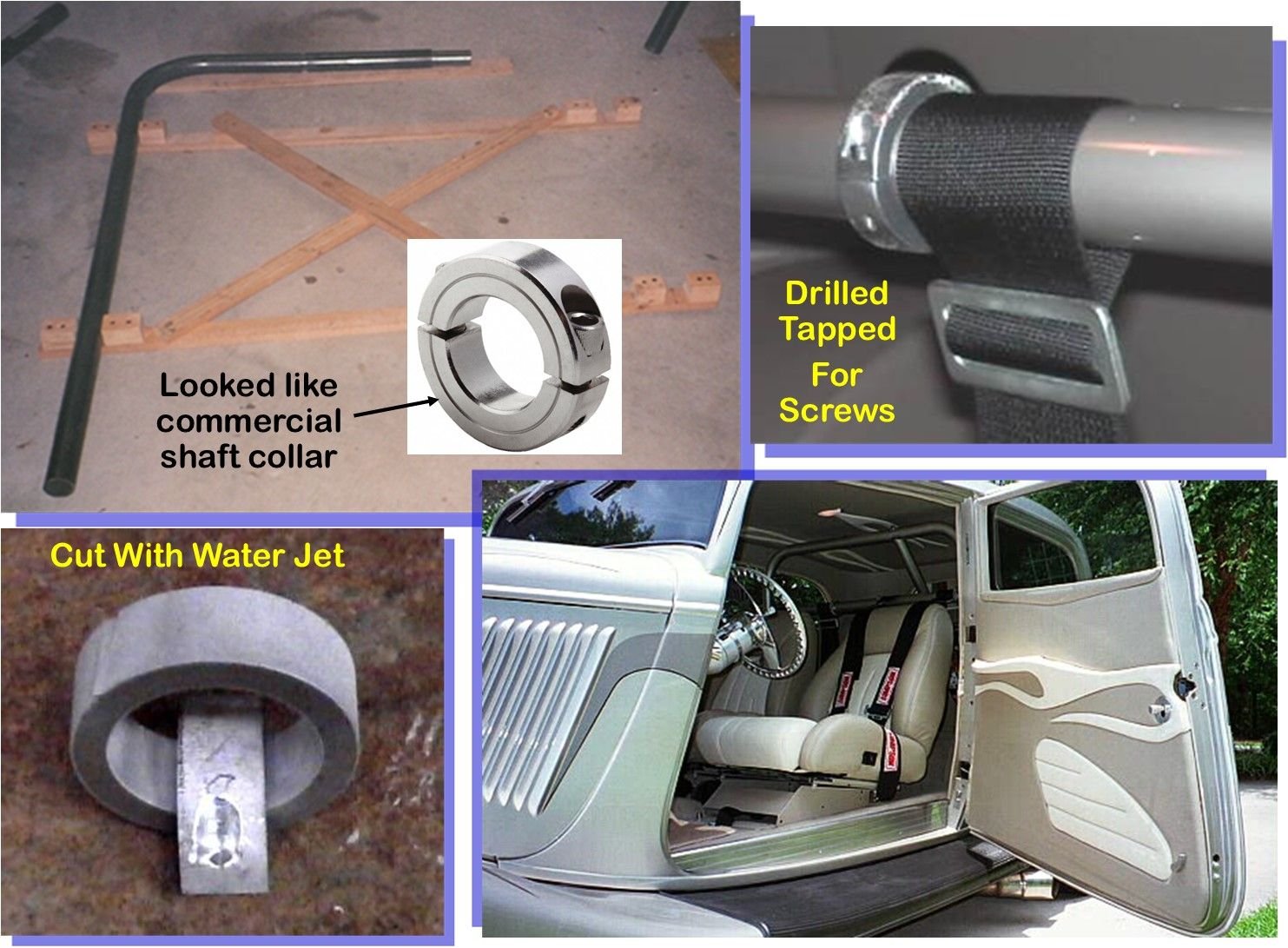

FWIW, might find this idea useful. While building my Street Rod was at the Vintage Car Races in Laguna Seca and saw a cleaver way to keep a shoulder harness in place on a roll bar brace. Looked like a two piece commercial shaft collar but could not find one that fit. Had "donuts" precisely water jet cut from alumimum stock, drilled holes for bolts, cut them in half than tapped for stainless cap screws!
Note, fabricated my roll bar from several bends and a straight section. Tubing supplier machined a piece of smaller tubing to fit the ID and act as alignment and backing for welded joints!
