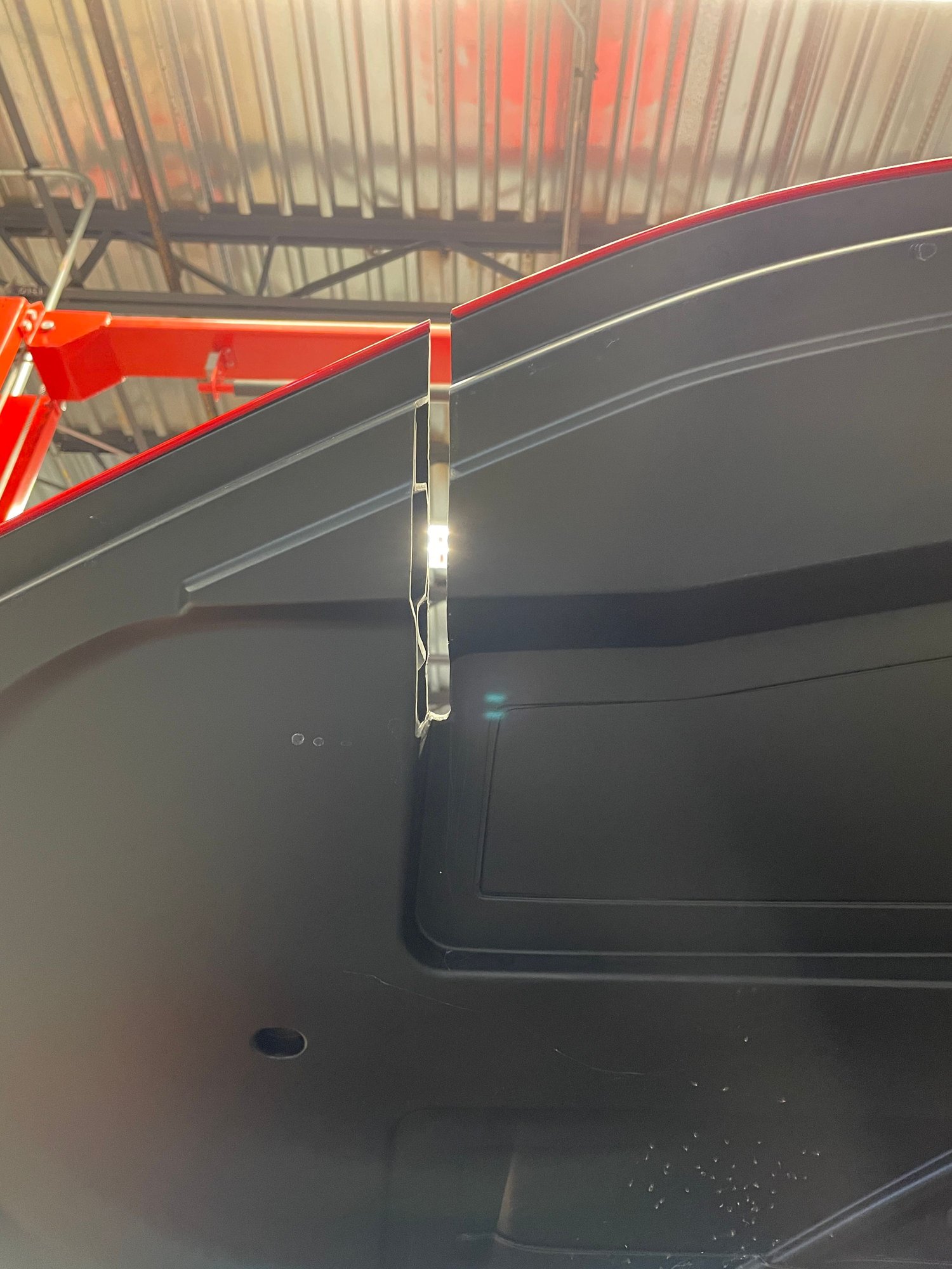

Originally Posted by SPOHN
Nice. I’d like to see pics of how the cuts have to be made for the brackets?
It looks larger in the pictures without the upright going through it but here you go!
Old Jan 11, 2021 | 05:33 PM
NoMatter's Avatar
NoMatter
What’s Next
Joined: Dec 2020
Posts: 1,293
Likes: 834
From: Reality
Big thanks.
