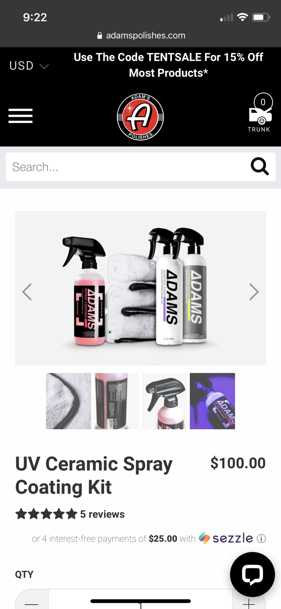

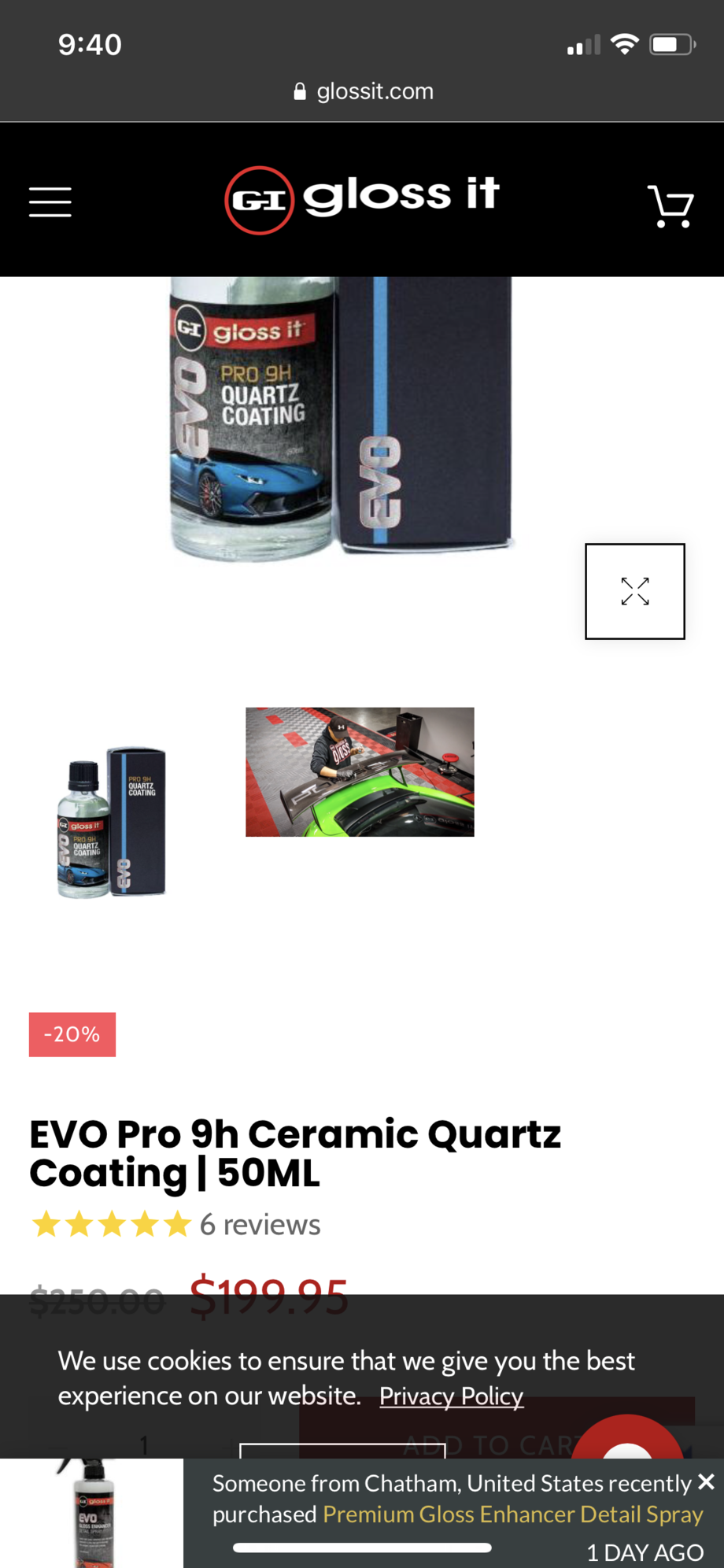

The ‘watered down’ spray bottles of ceramic is surely not the coating that lasts years and detailers charge $1200 per application for. It reads like you are confusing the two. True long-lasting 9H ceramic comes in a tiny glass bottle that will do 2+ cars and is VERY difficult to apply due to its ability to dry in with a bad buff. No driving the car (overnight if possible) and no water on the car for about 24hrs for max life of application.
The ‘watered down’ spray ceramics are diluted to be very forgiving in a misapplication and thus do not last as long.
That being said, if you are doing a spray ceramic (or even ceramic mid-cycle booster spray) a few times per year, your paint will love you (and it’s cheaper and it’s idiot-proof). Either way, a long term or short term coating on your clearcoat is the best thing you can do to prevent/deny swirl marks.

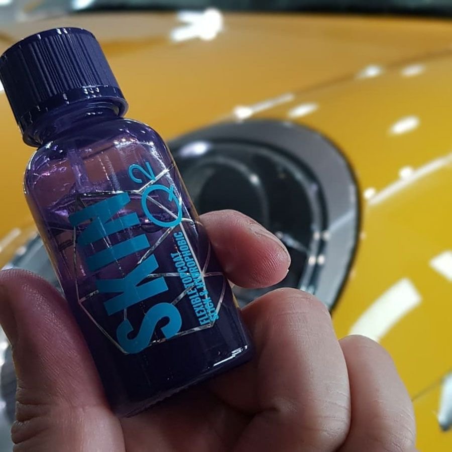

I used Gyeon Syncro on my Volvo with very nice results. I will do the same with my C8 both on the PPF sections and straight paint.

Stuff seems pretty dope!

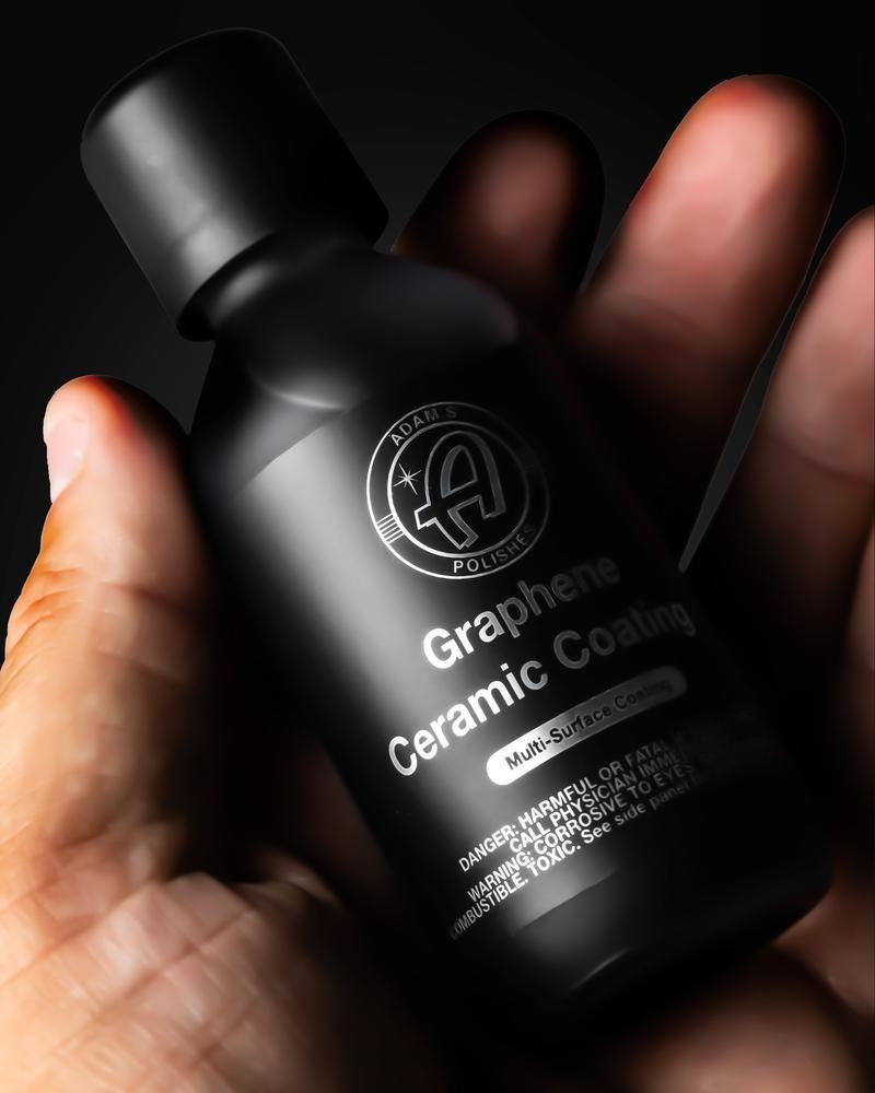

Nope, not talking about watered down spray bottles. https://adamspolishes.com/products/g...32542356275297

Yes! That’s the kind of stuff! How was the buff out?
