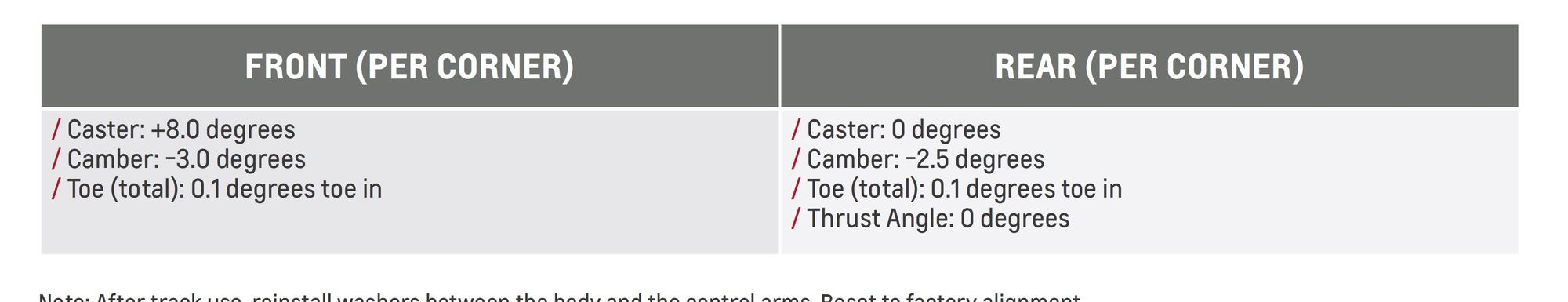

My GM service writer says their Hunter Alignment machine has a street and performance settings for the C8. Is the performance setting the same as track?

There is a track preparation guide on the chevy corvette website that you can download. It includes the alignment specs. I snipped and pasted them here. You can ask the service writer if the "performance" settings on the Hunter machine are the same as these.
