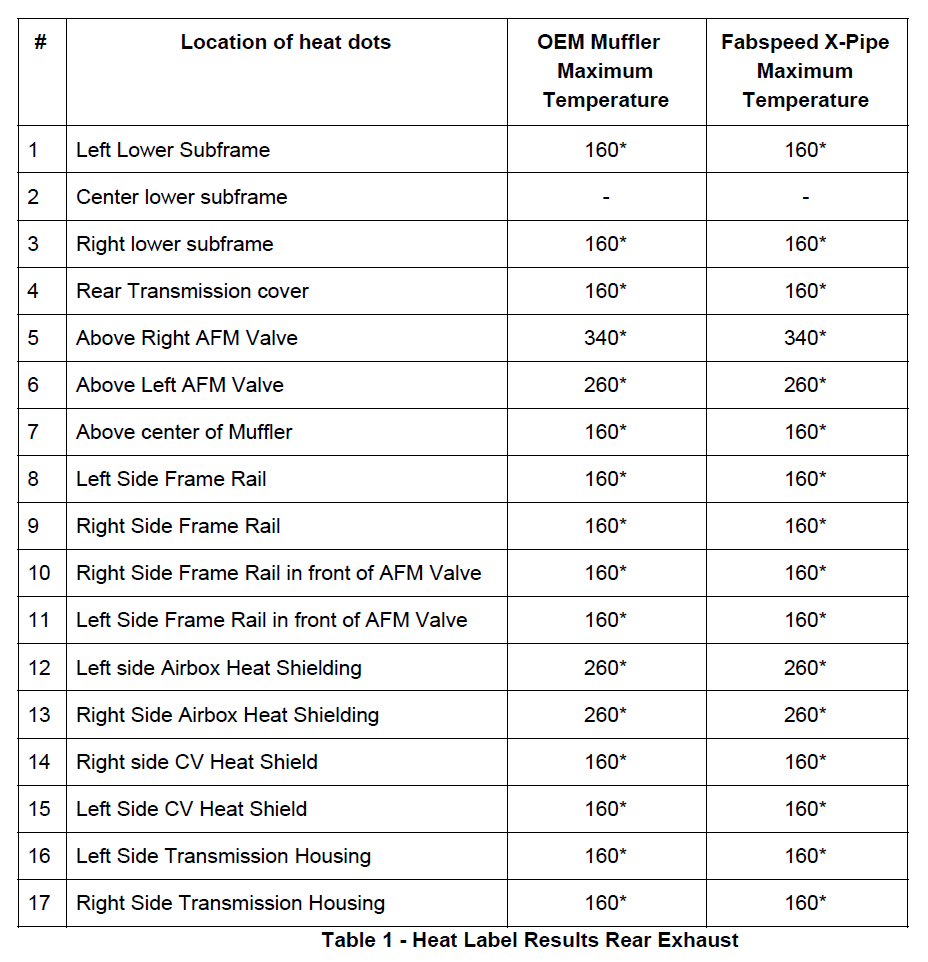

This is from Fabspeed’s test, more info found here:
https://www.fabspeed.com/blog/c8-cor...l-fabspeed-rd/
