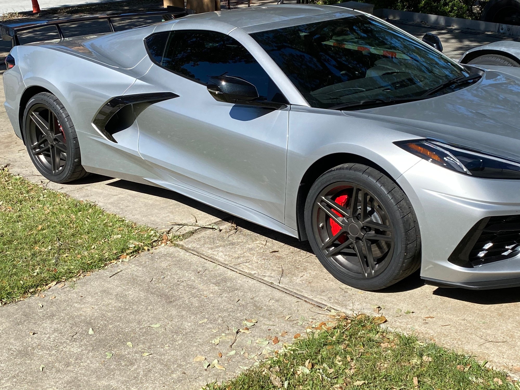

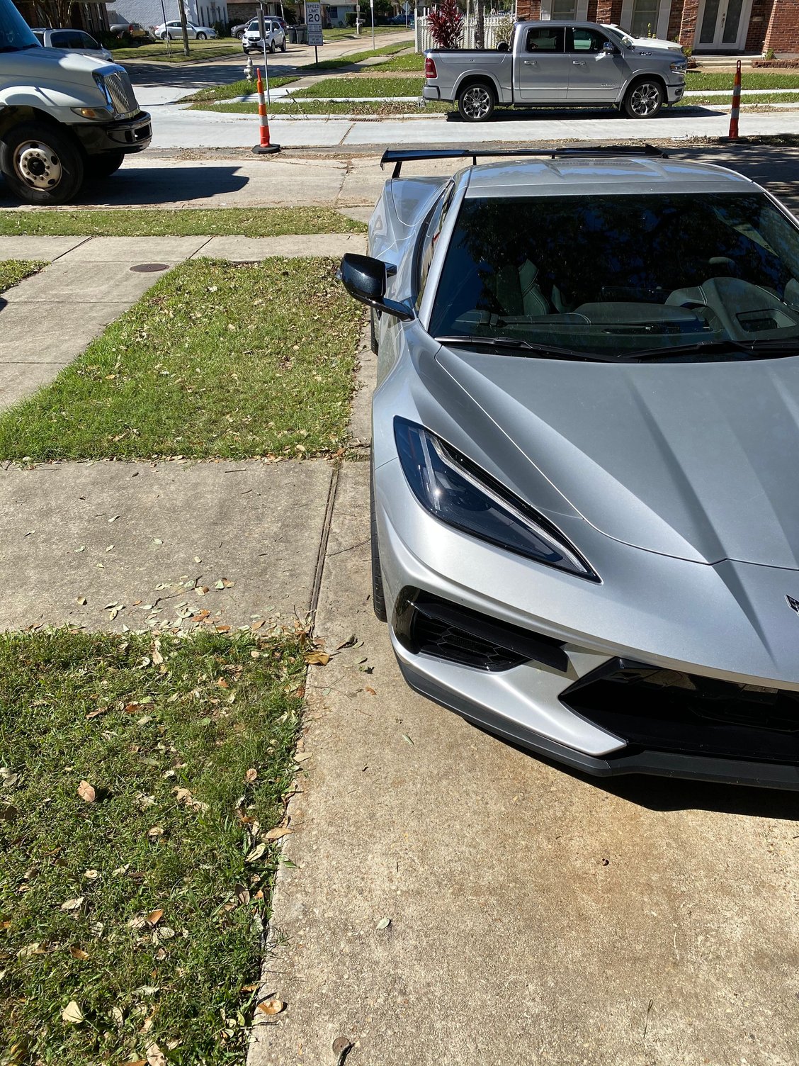

Works fine. Dm me if you want to know more. Not in the mood to go back and forth with the keyboard heros on the CF.
