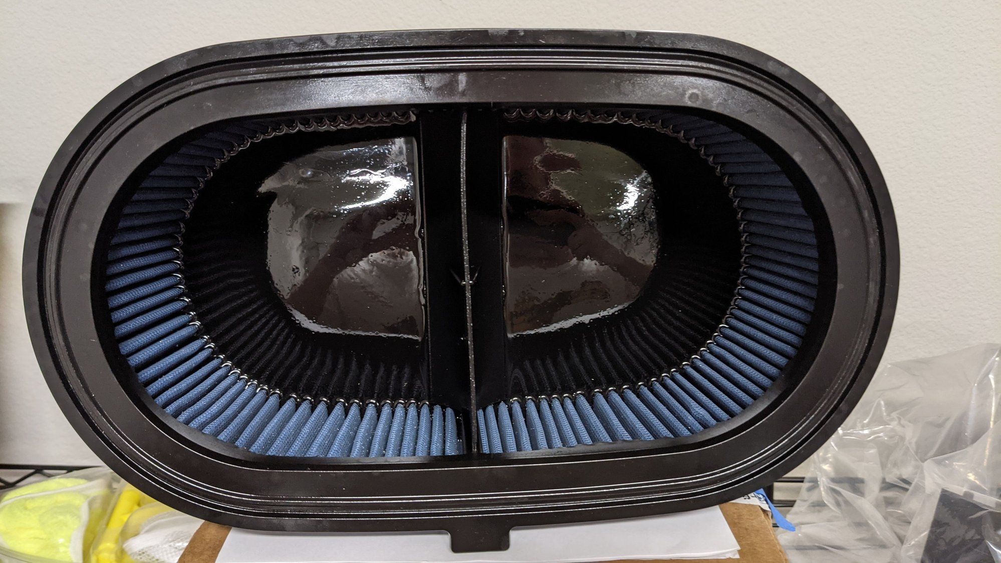

Default Air Cleaner Center Web
I have an aFe Pro 5R filter in my 2021 C8 Z51 and noticed that it does not have the center divider web of the stock C8 air filter as well as the K&N filter. What is the purpose of the center web? Does it help to turn the incoming left and right air flows to assist laminar flow to the IM?
Thanks, Bill
Thanks, Bill
I have read that is only in the stock filter to make it more physically rigid. I have the same filter as you and it is plenty rigid and won't loose it's shape. I can't see it relating to performance IMO.

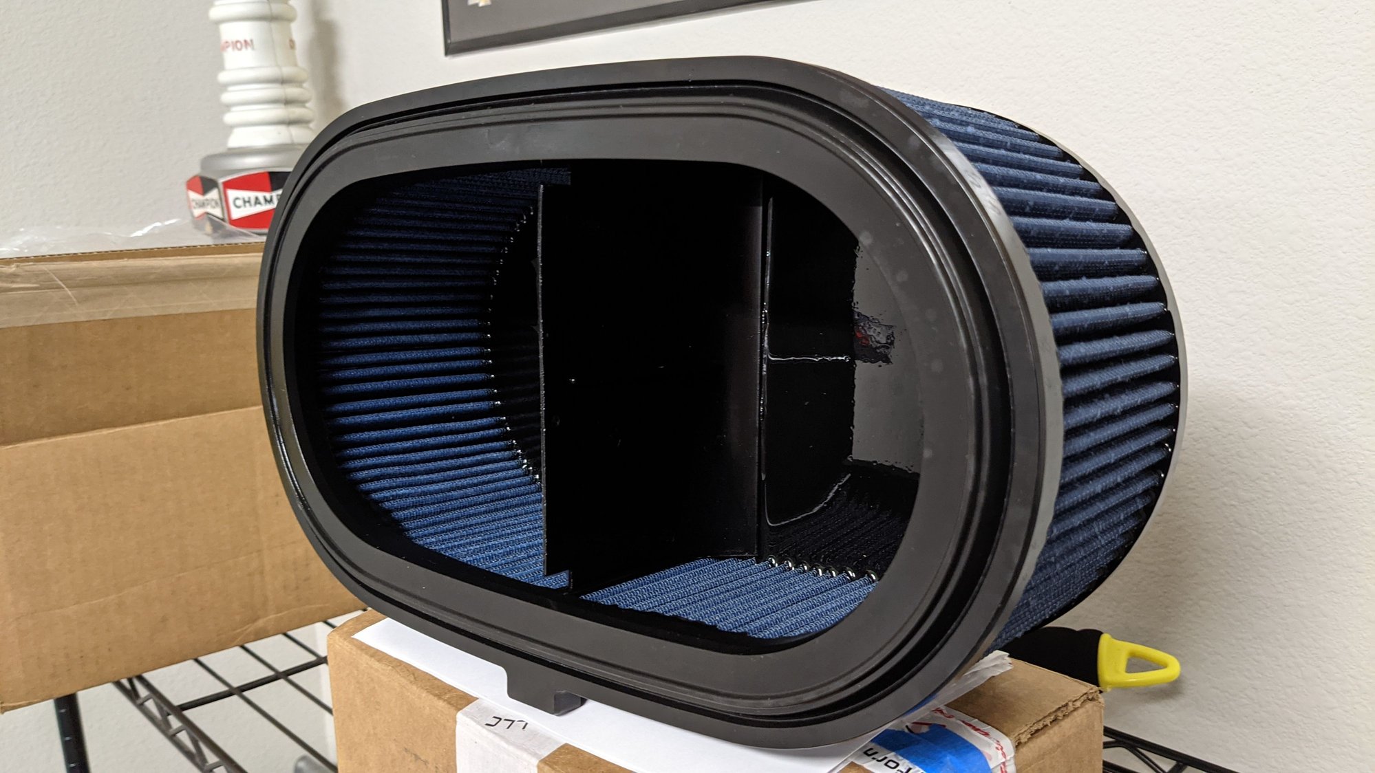

Thanks, Bill
My theory is reduced turbulence with the inlets feeding the filter from opposing sides. Attack Blue and Halltech have also both incorporated it into their designs. While normally I'm a huge fan and loyal customer of AFE products, I was not impressed with their C8 filter design due to the lack of the divider. AFE has already redesigned the filter once, I'm hoping they give it yet another try.
Here's some internal shots of the Attack Blue air filter vs. OEM:
