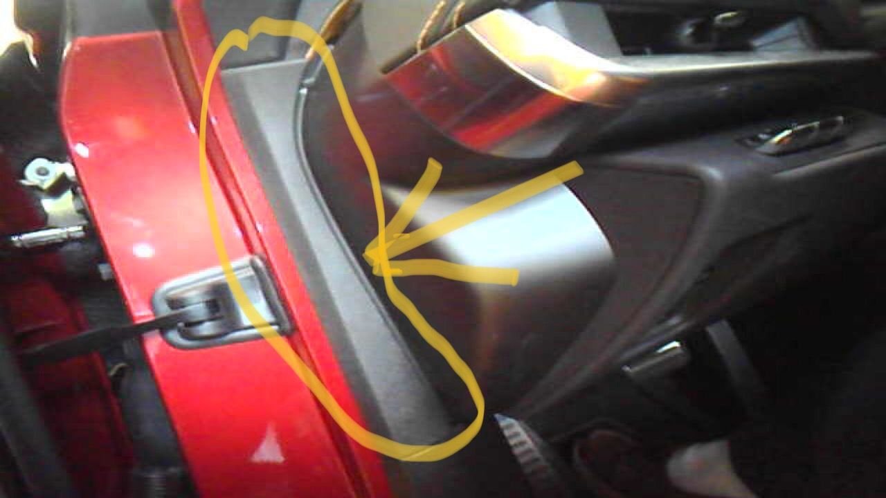

Has anyone ever removed this piece of trim just inside the door? I got the bottom to unclip but I can’t get the top to budge. I’ve pulled as hard as dare without knowing what’s back there. I stuck my scope inside and it looks like a regular spring clip, but is it?

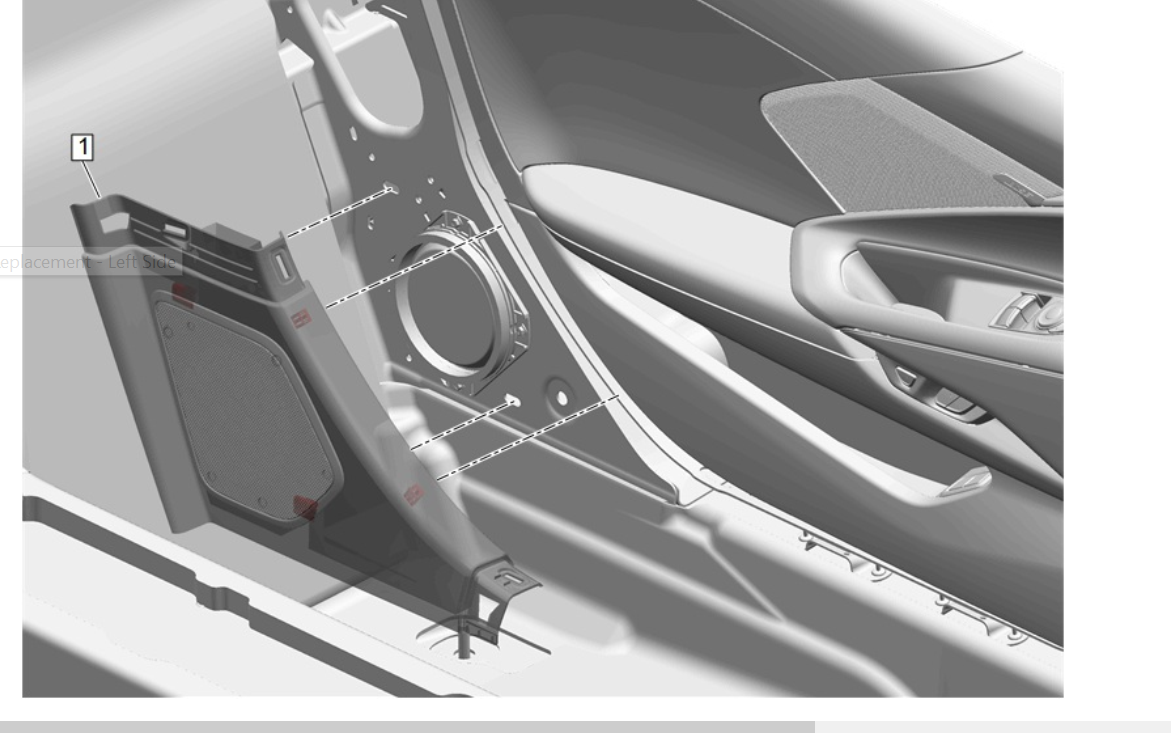

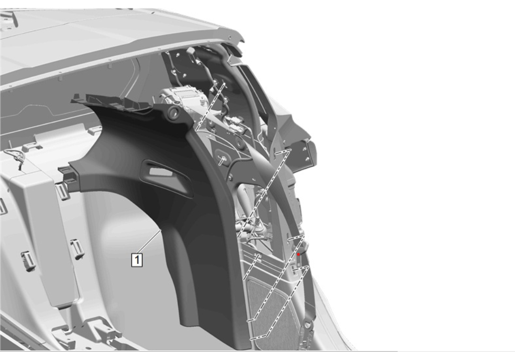

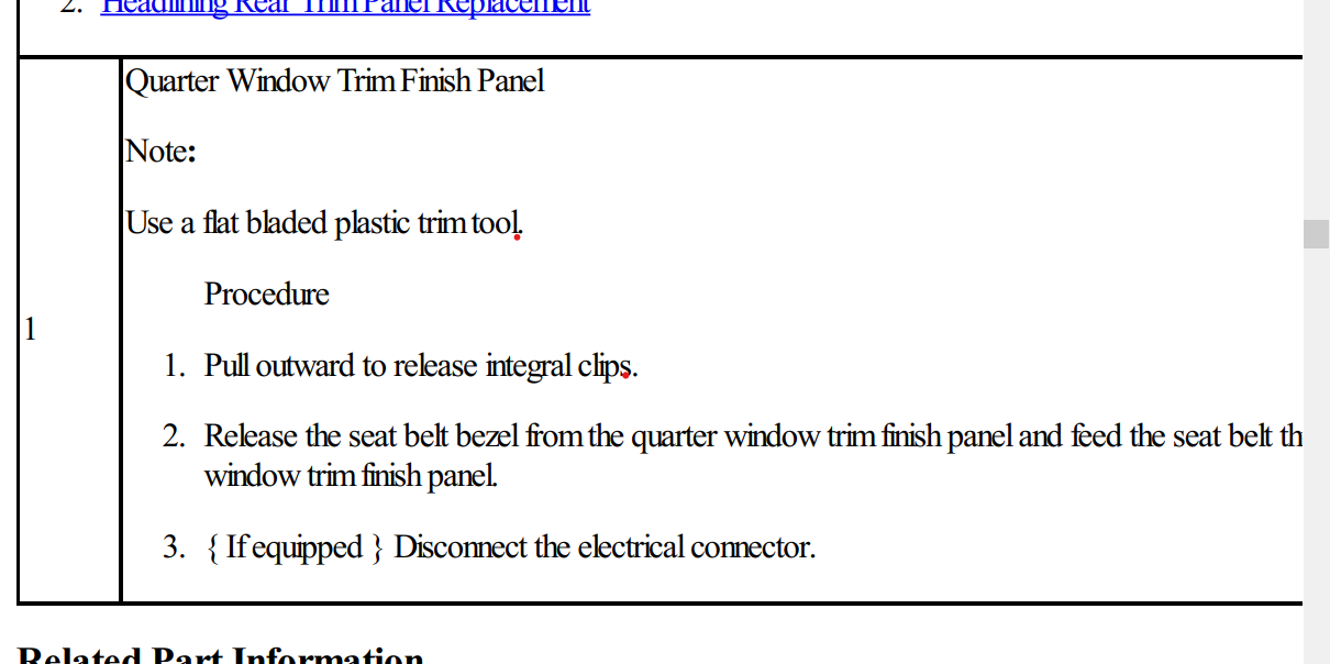

See is this helps you any

Thanks, I got it off. I appreciate the help!

The pic is the front footwell, the service diagram is the rear b pillar.
