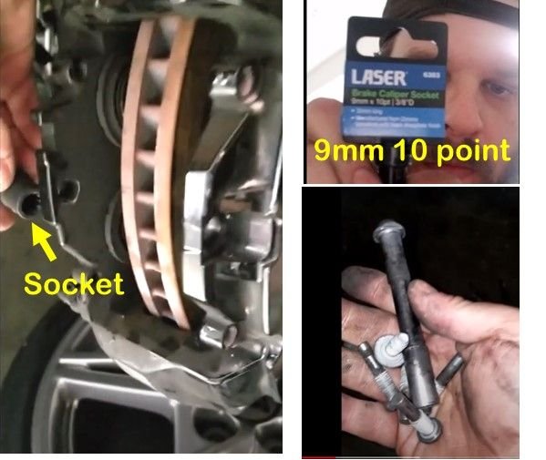

Does someone have a list compiled of brake tools needed to replace front and rear pads and rotors on the C8 Z51? Torx sockets internal or external? Size? Regular Torx or are they Torx Plus? Spline sockets?

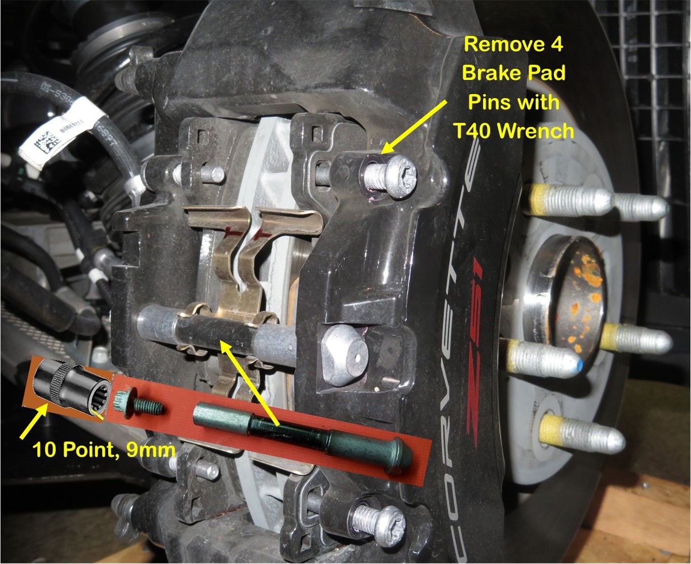

My PDF has most of the info. BUT the key first question is how will you jack it up high enough to get the front calipers off? The two bolts that hold the caliper are 155 ft-lbs and you'll need it lifted ~16 inches or so to get a long enough wrench to loosen and to get access for a torque wench to tighten.

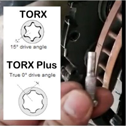

You'll also note I bought a Torx Plus bit because a poster said it was needed! It wasn't only a standard Torx BUT the recess in the bolt can be easilly rounded IF you don't keep the socket perpendicular. There is Loctite on the 4 bolts that guide the front pads. I suggest even though it is small Torx to use an adapter and a 1/2 inch ratchet to help keep it perpendicular and the internal Torx bolt. That posted noted he bought new bolts and they were only plan Torx, not Torx Plus. He may have distorted the Torx socket so could not tell!

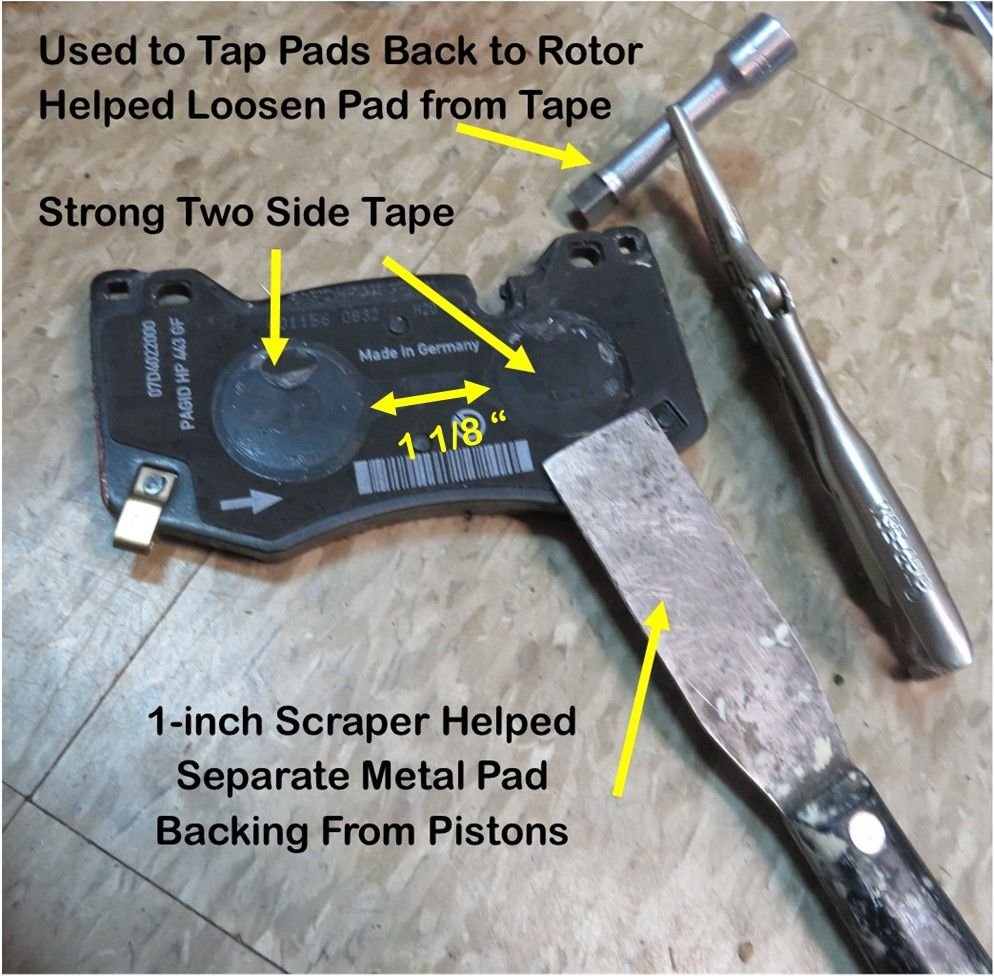

The PDF covers how I did it without removing the calipers (like I did my early 2014 Z51 that had the same very strong brake pad to piston double side tape.) I strongly suggest removing the calipers as it is much safer than risking damaging the piston dust boots. It suggests to 1st remove the caliper brace that needs a special socket (specs in PDF) as I had to do as it makes new pad install much easier even with caliper removed.
This is the many pics, detailed captions of my install. 1st 11 pages cover the C8.
http://netwelding.com/Ceramic_Pads.pdf
Poster said the 4 guide pins used for the front pads were Torx Plus. They were not only standard Torx.

Thanks Jerry, I will refer to your PDF. Lifting the car is no problem I have an Atlas two post above ground lift in my garage. I just wanted to get the tools on order. I have regular Torx and Torx Plus sockets but I heard someone mention on here about a spline socket was needed.

Yep, you'll see in the PDF I used the special scoket for the caliper brace. It's the same one used by Porsche and others. You don't have t remove the brace if removing the calipers BUT as someone PM'd me it is a PIA to get the caliper back on with the pads in place. So before you remove the caliper IMO best to remove the caliper brace and without having someone hold the caliper in their hands while you try to gte those guide pins out do as I did. Then you can put the caliper back empty of pads and just drop them in from the top. In fact for all future pad replacement no need to remove the caliper, just chage as you will the rears, which don't have that strong doubled sided tape.
Bought my caliper brace socket on Amazon.

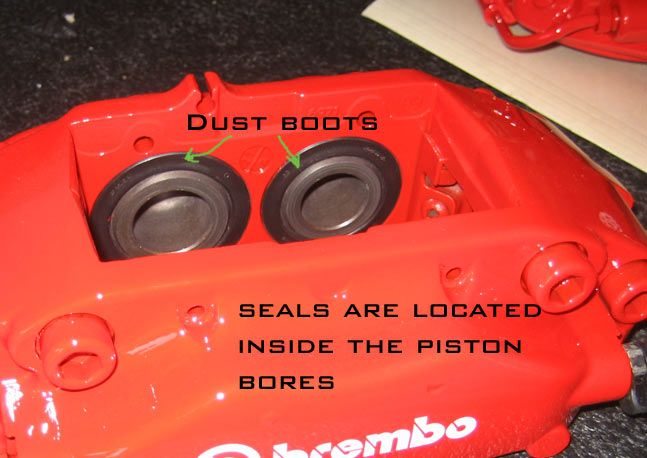

Look at my PDF, post #2. Front Z51 brakes are totally different than all but the very early 2014 Z51 (which I was lucky enough to have!) The front pads use strong double sided tape between the pads and pistons. Same tape as used by some other European cars.
PIA to remove and risk damaging the piston brake dust boots if you try to do with the caliper on the car. All spelled out with many pics in the PDF for the C8 Z51 as well as the early 2014. Now if you are getting the base C8 those smaller calipers I don't believe have the tape. But then why would you change pads as they also don't have excess dust (similar to C7.)
Easy safe way to break the tape loose is with the caliper and pads off the rotor. BTW, back brakes are like the C7.

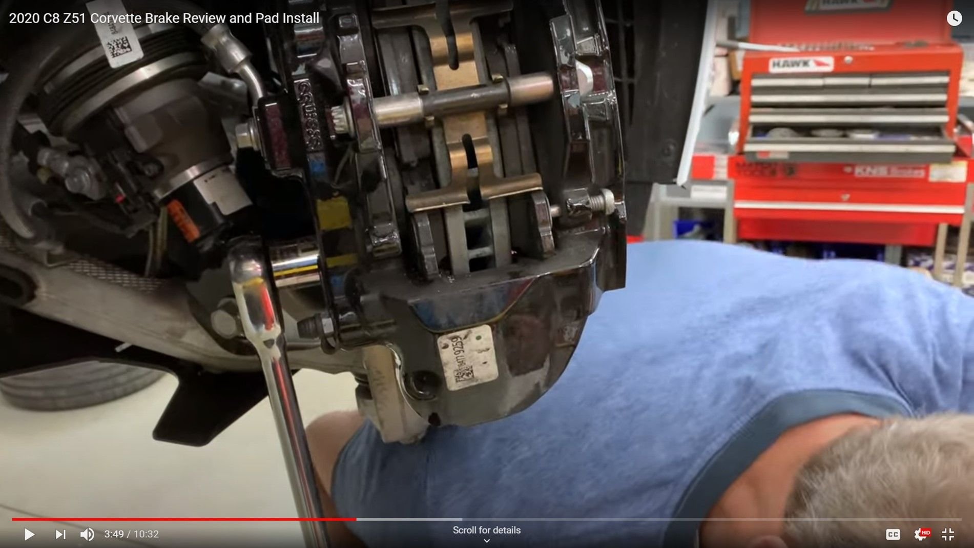

Yep. There is strong double sided tape holding the pads to the pistons. Used on some European cars as well. Was also used on my early 2014 Z51- eliminated mid 2014.
Here are a few pics from the >25 in my PDF: http://netwelding.com/Ceramic_Pads.pdf
To remove calipers two bolts hold from back side. Need room for breaker bar to remove and torque wrench to install with 155 ft-lbs. Fellow is putting his shoulder into removal on a lift!
Risk using paint scraper ground to knife edge on one side and heavy hammer blows is you risk damaging piston dust boots.

What is the purpose of the double sided tape? Do replacement non OEM pads come with this tape?
Old Oct 15, 2021 | 03:26 PM
JerryU's Avatar
JerryU
E-Ray, 3LZ, ZER, LIFT
Joined: Sep 2007
Posts: 34,860
Likes: 12,293
From: NE South Carolina

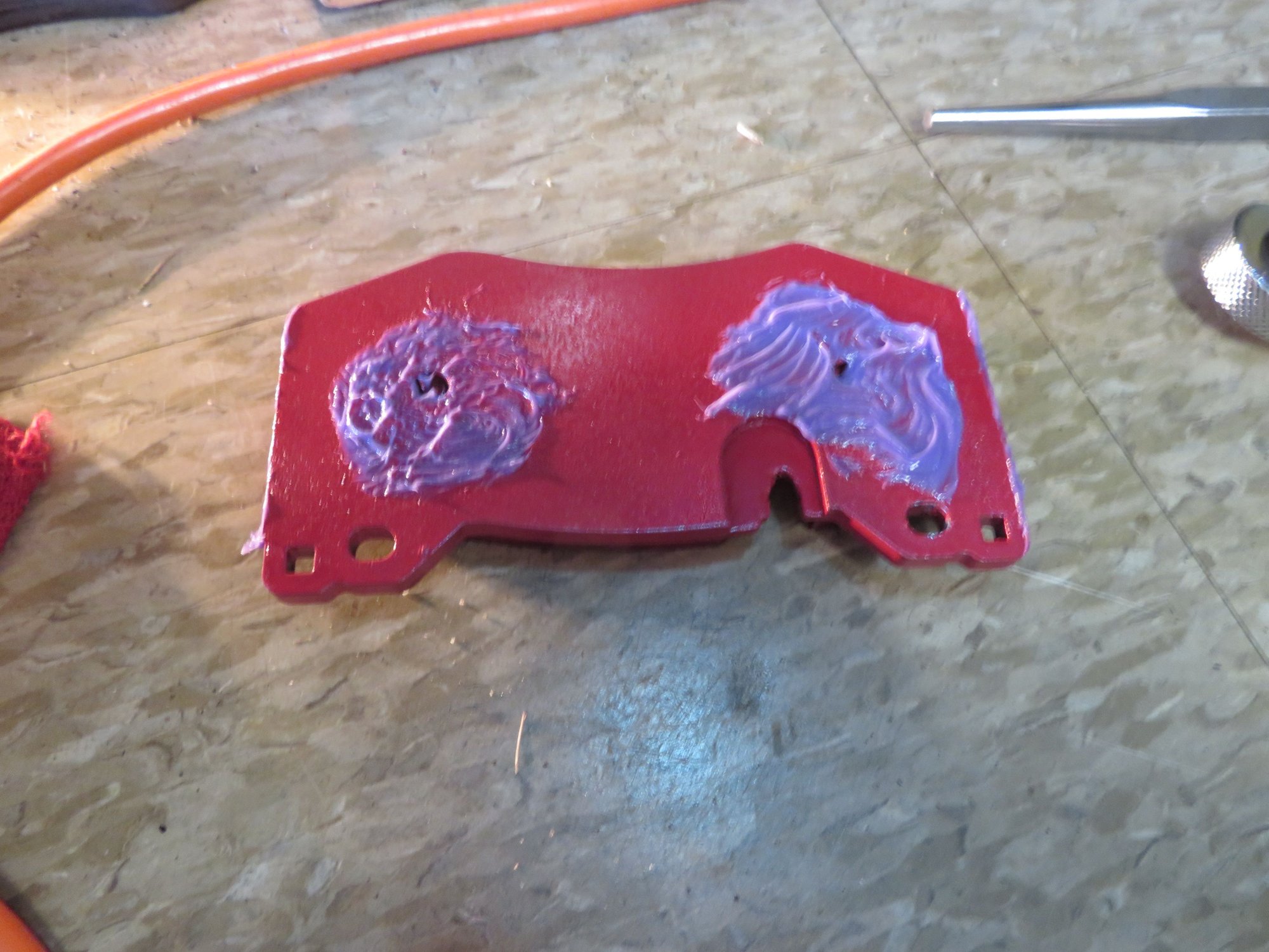

Doubt replacement pads include the tape. It is to stop vibration and noise. In my 3 installs, albeit Carbotech Low Dust Pads never had a noise issue. This is what I use not only on the sides as GM recommends but also the pad backs.

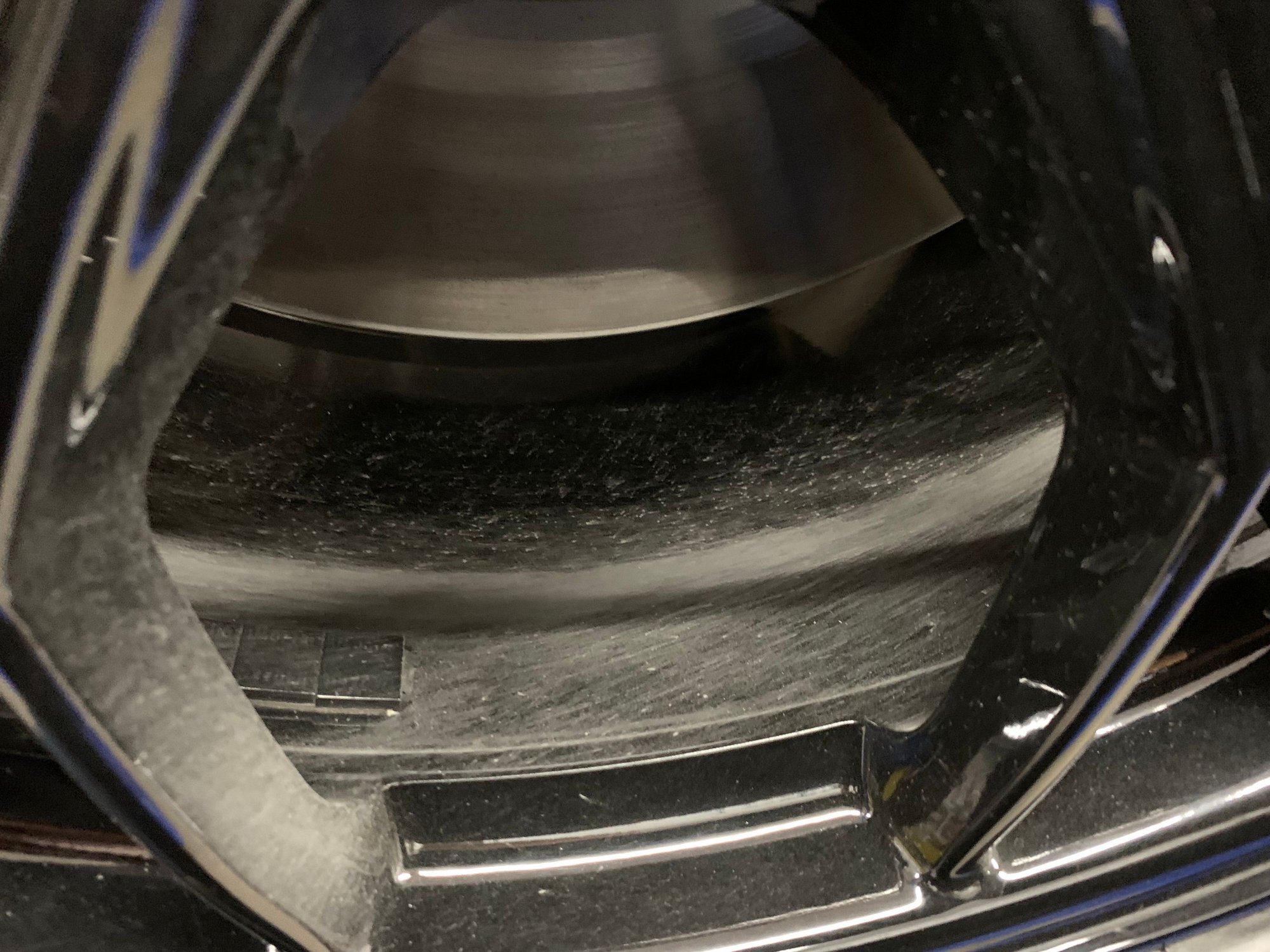

After installing the CarboTech Pads on the initial drive did the pads produce a lot of brake dust from the new pads as in the picture?
