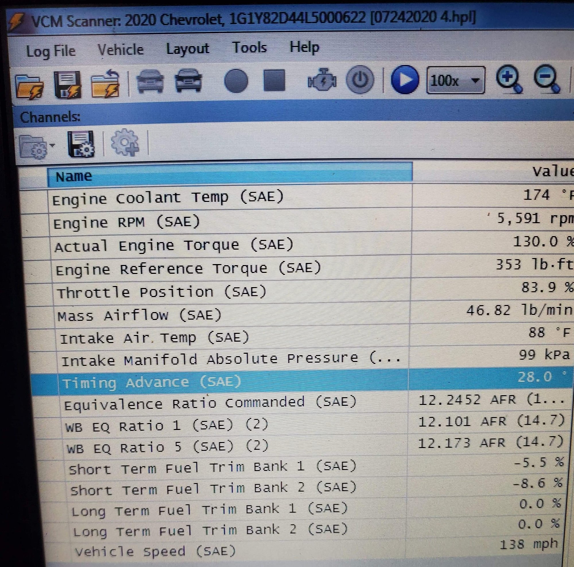

These were the available channels when I had my car on the dyno last year. Not much there, but it's something.

You are right at least it is capable of being logged. Missing the ignition timing, 99KPA is getting right up there. 83% throttle @ 5591 rpm ?

Ignition timing is highlighted in blue (28 degrees). The throttle position reading of 83.9 is at WOT, my 6th gen Camaro would show the same reading so Im not sure why GM doesn't register it as 100% on the logs...engineer logic must be at play ?!
The 99-100 kpa is consistent thru the power band with my ported stock IM/TB combo. I think GM did an excellent job with the LT2 design and the added clean up/porting I did gained about 10-13 hp.

Yes it was on 93 (I'm at sea level) and I'm not sure that channel is available. I thought the screenshot would generate a bit more interest...the fact that we are seeing 28 degrees advance is crazy imo, the downside is that we are so pig rich (12.1-2 commanded) it sucks !! If we could find a way to lean us out we definitely could pick up a few ponies. Not to mention that if we could also tune for e85 you wouldn't even need to bump timing, I think I was only running 30 degrees on e in my 6th gen. 25hp right there alone, these motors love the corn !!

Yes, with 28* I was a little surprised too. I guess GM engineers commanded 12.24 A/F to keep the engine happy with 28* timing while using both 91 and 93 octane.
