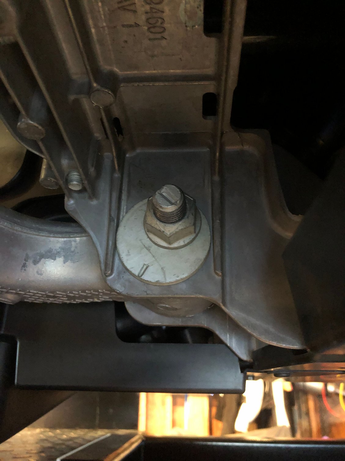

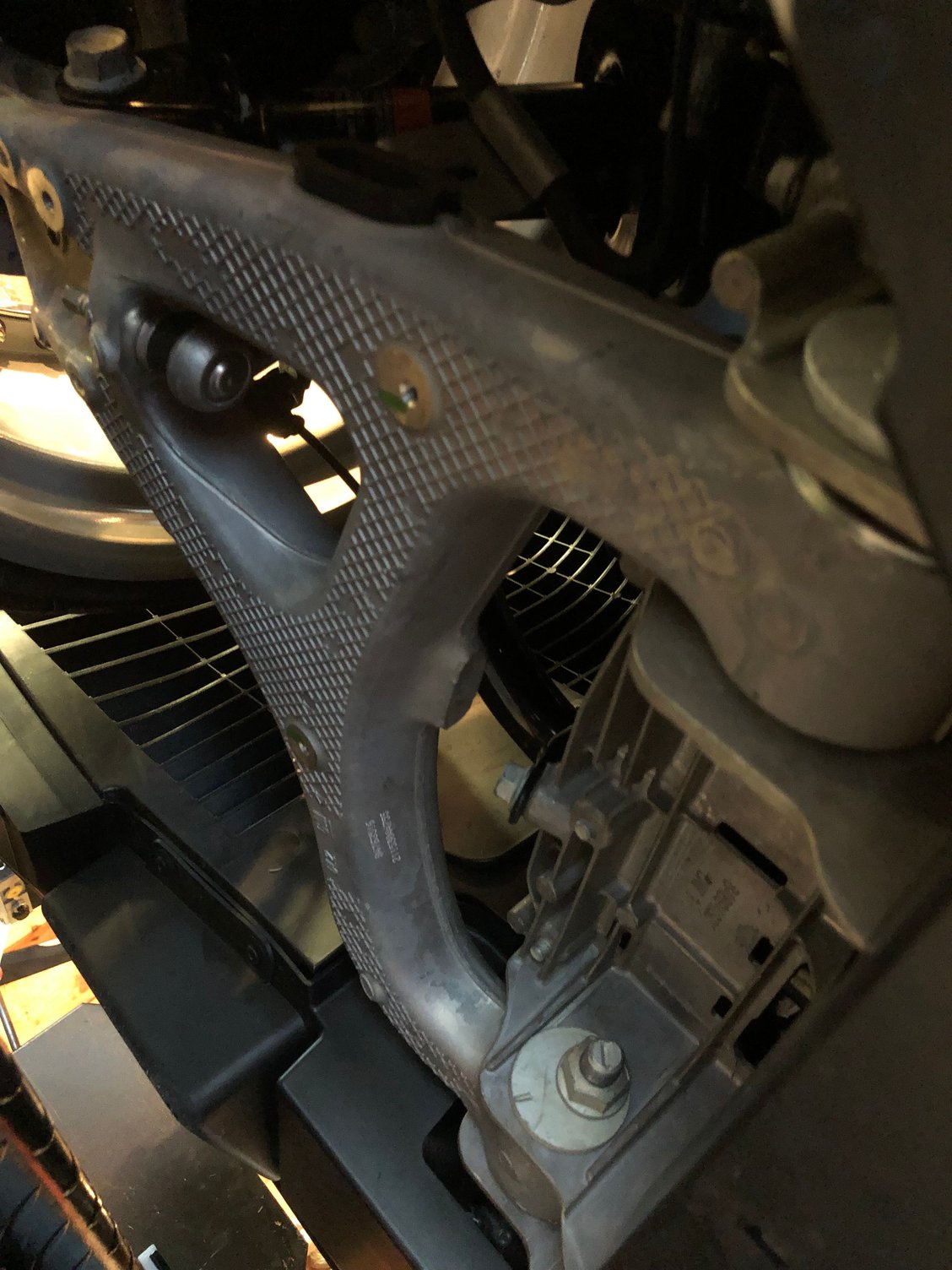

Plastics to remove for alignment
That link is to another vid showing which plastics have to be removed for a proper alignment. Z51 brake ducts add time to the process, I don’t have those.

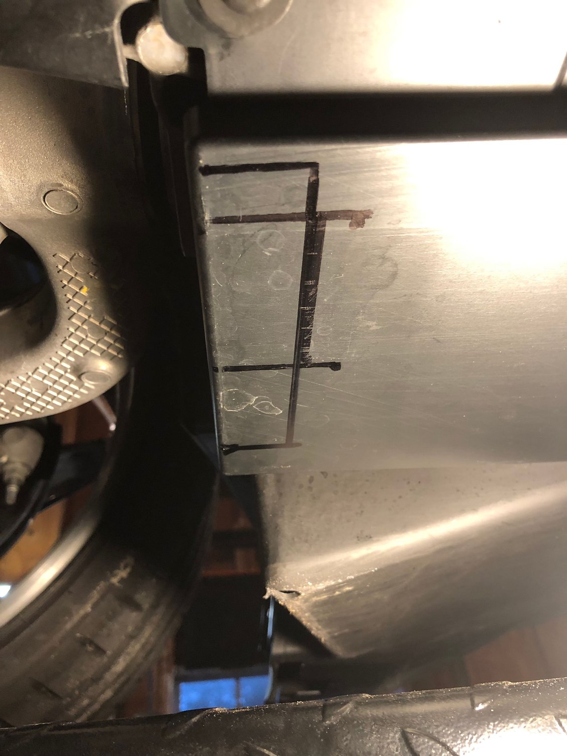

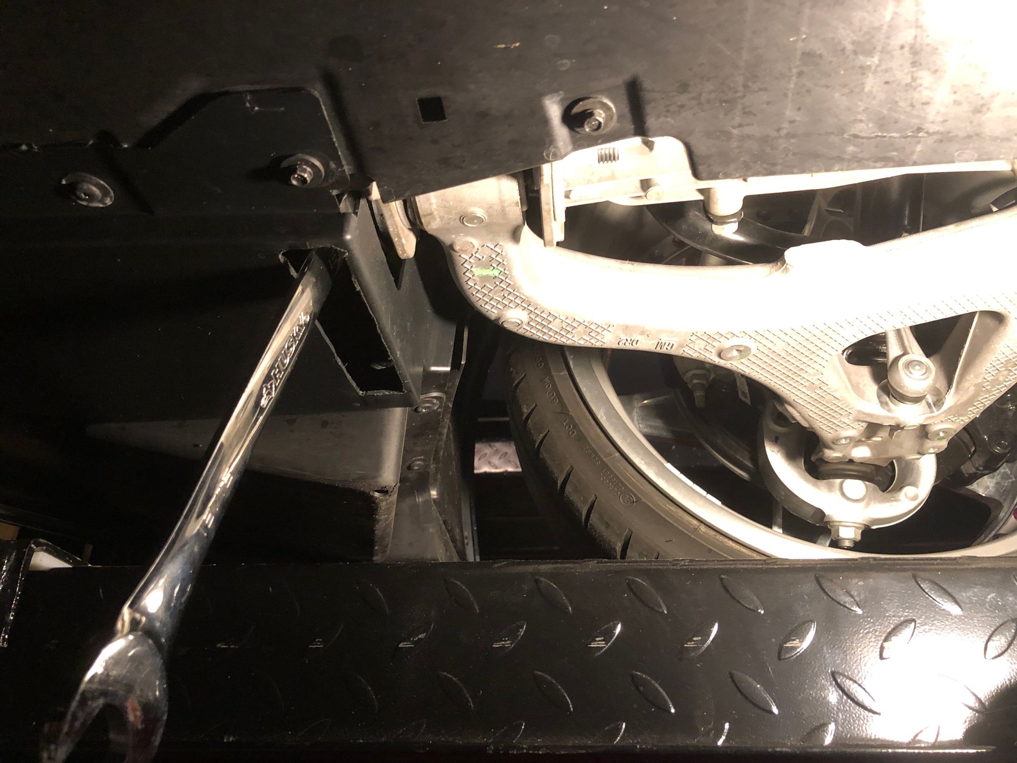

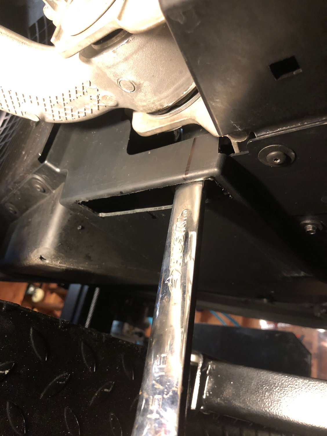

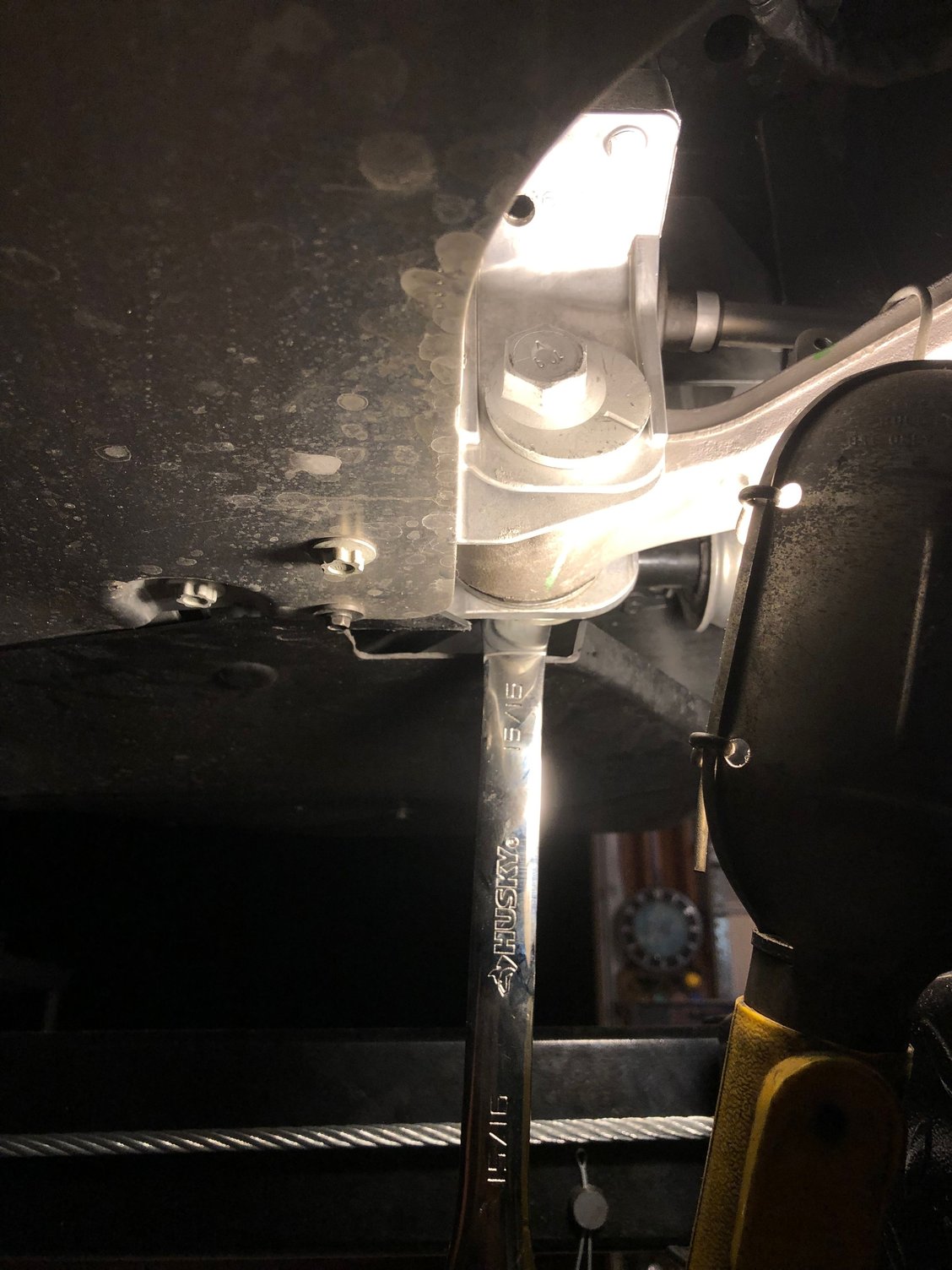

Regardless, I decided to cut my plastics to allow for access to the eccentric bolt heads/nuts. I don’t think there will be ANY discernible downside to the open access holes, but make your own decisions about your own car.
If you decide to undo the access holes in the future, then new plastics (3) would be needed. The front two air spats get beat up anyway, and the rear muffler shield should not be hard to source….or even fabricate if need be.
My advice would be to at least remove these pieces yourself before an alignment instead of relying on a technician to remove and replace all the screws and bolts. But, for me, less work is better and as a long term solution access holes just seem like a good compromise.
I made a video here showing more detail. I used a dremel with a side cut bit and a sanding barrel. The above pics with the wrenches hanging show the access/swing points now.
