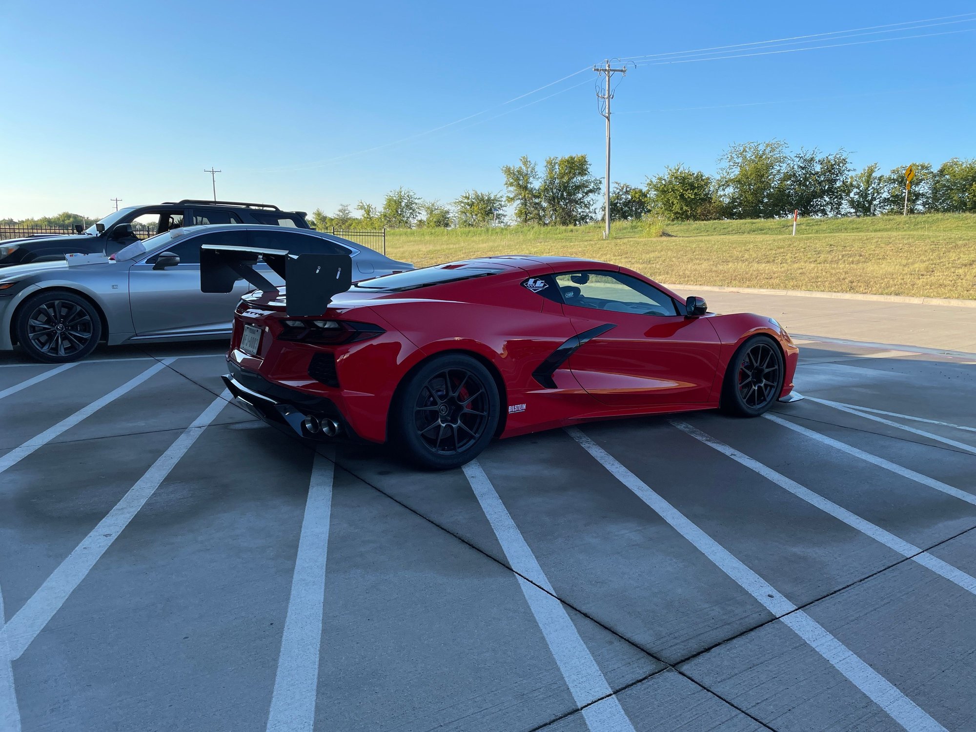

Pretty sure i have it right.... The spacers would reduce the wheels offset, think of offset as how far the wheel attaches to the hub from the centerline of the wheel. If the wheels offset was +30 and i added a 30mm spacer, the offset of the wheel would be effectively 0 as it would be back to the centerline.
The wheels do sit further outboard. Here is a pic. Also keep in mind if you are tracking you are gonna be running nearly 3 degrees of camber all the way around.
Tires in the picture are 285/30F 305/30R Nankang CR-1's

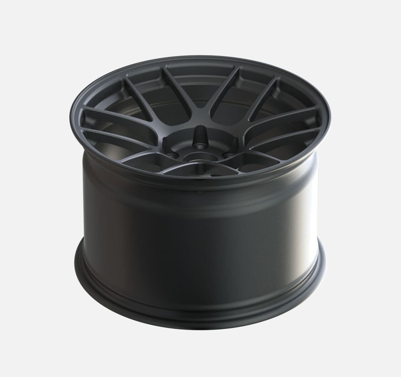

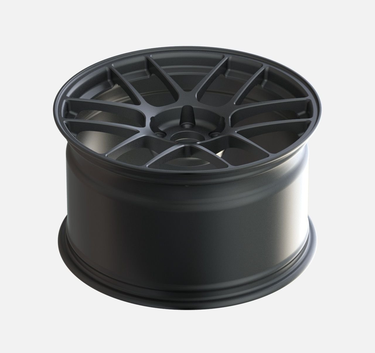

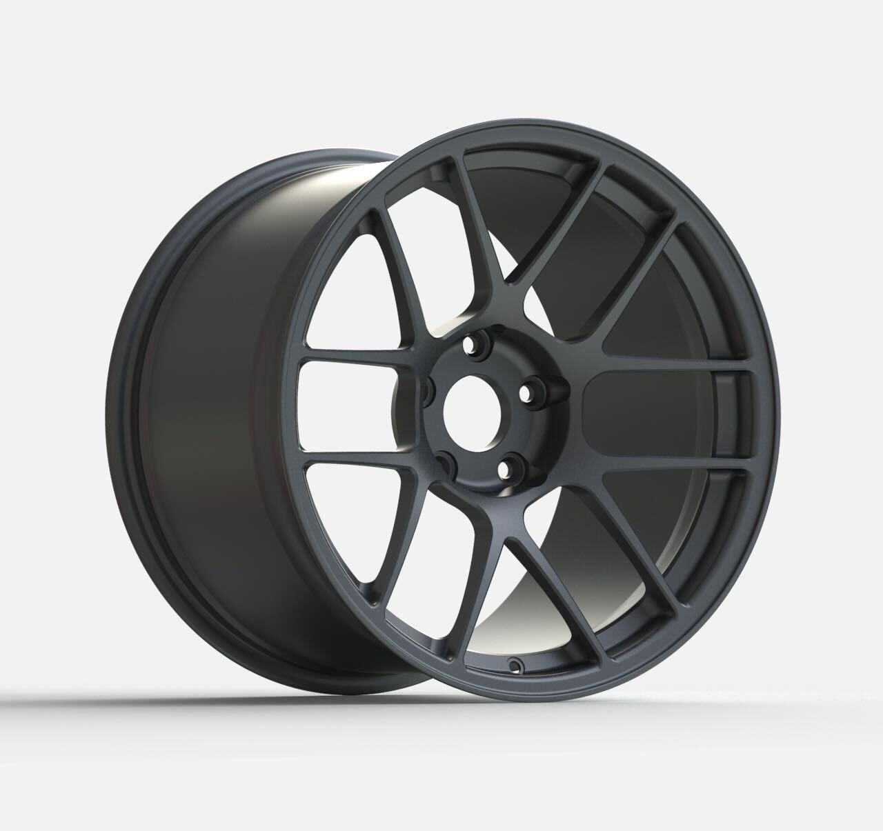

Just FYI guys, thanks to many of the forum members we are currently working on a limited run for a track set up, this might be of interest to some of you, our first run is for 10 sets only, below is the initial 3D graph to show the official design. Big thanks to @J5isalive as his info really made a change on what we where going for, Here is the wheel information. i was not trying to high jack the thread was actually creating a new one soon, this is limited as our first run is only 10 sets
Brand
MRR Wheels
Construction
6061-T6 Forged Alloy
Size and specs
18x10 5x120 40et 66.9b Front and 18x12 5x120 42-45et 66.9b
Wheel Weight
18x10 17.86 lb
18x12 19.62 lb
Special construction details
Knurled tire bead to eliminate tire movement
Deep bowl center pad to minimize weight
Rear back pad pocketing to minimize weight
Color options
Gloss Black, Matte Black, Bronze, Gunmetal
Optional custom colors also available
18x10 side R
18x10 laydown
18x10 side L
18x10 Straight
18x12 laydown
18x12 straight
18x12 side R
18x12 side L
