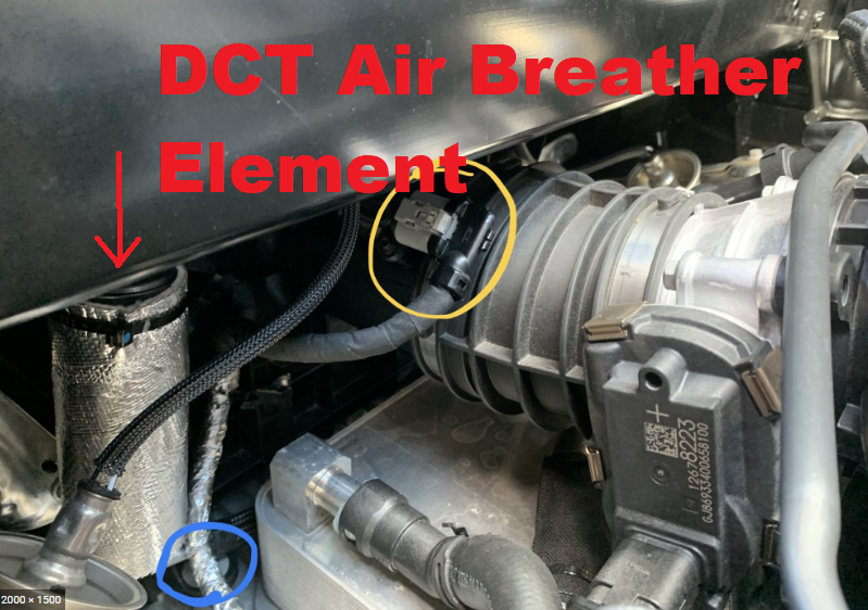

I hear that Ron Fellows / Spring Mountain does all of their extra 2qt's of DCTF fills via the air breather for the DCT. You can see the tube just to the passenger side of the throttlebody and "zip tied" to the back of the airbox.
I really wish I could fill mine this way, however I want a "record" at the dealer that their service team installed the 2 qts per GM specifications to avoid any sort of potential "warranty" issue with the DCT.
I would rather they not tear apart the trunk and potentially damage something, when the air breather looks super easy, but unfortunately that would give GM an out since I plan to track the car this year.
What are the parts outlined in blue and yellow?
heh, I stole another pic I found online and just added the red text showing the DCT air breather location.
The blue and yellow stuff is unrelated.
It seems a lot easier and less likely to cause any damage to me to just fill via that air breather line. Just need a funnel and a little more patience for the pour, but certainly faster than taking apart the trunk and air box.
Supposedly Ron fellows hasn't experienced a DCT failure, and they are obviously pushing them harder than a daily driver. What I want to know is how often they are changing out the DCTF fluid?
I believe you are supposed to replace the filters and fluid after ~24 hours of track use, correct? If they had to tear apart the trunk routinely, that would be silly stupid. Wish GM would bless this approach with a field notice.

This is an easy way to do it. You need to add in steps and allow the air to burp out between fills.
