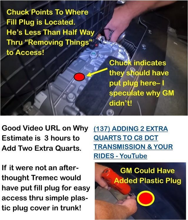

I added 2 quarters to the transmission by jacking up and removing the rear driver side wheel. The bottom of the rotor should be about 16 inches off ground. Ran a tube to the lower drain plug and filled. Piece of cake and didn’t spill a drop. Took 20 minutes.

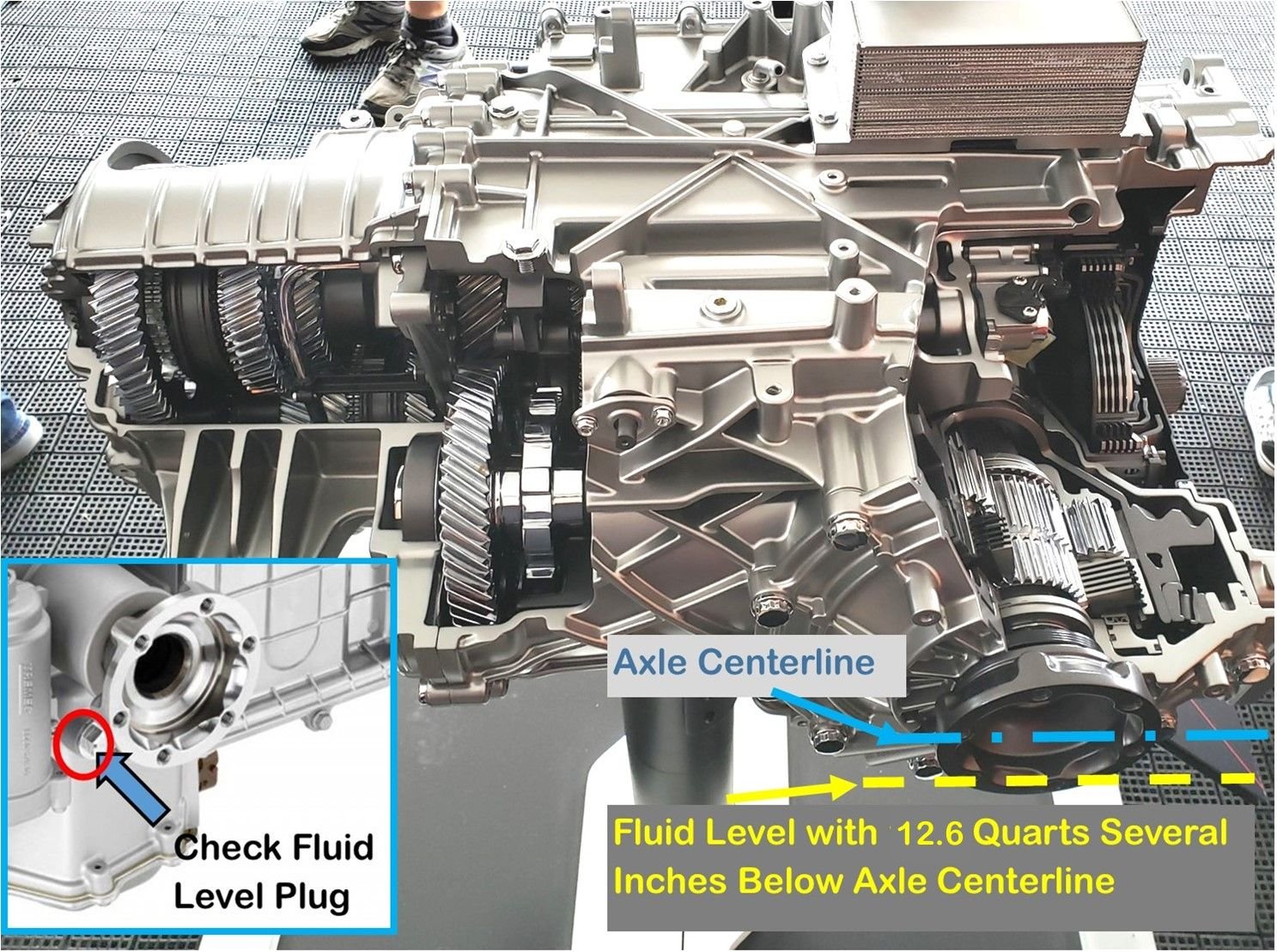

Note where the fluid height using the fill plug. Adding 16% more height is not like filling the case but will increase drag!

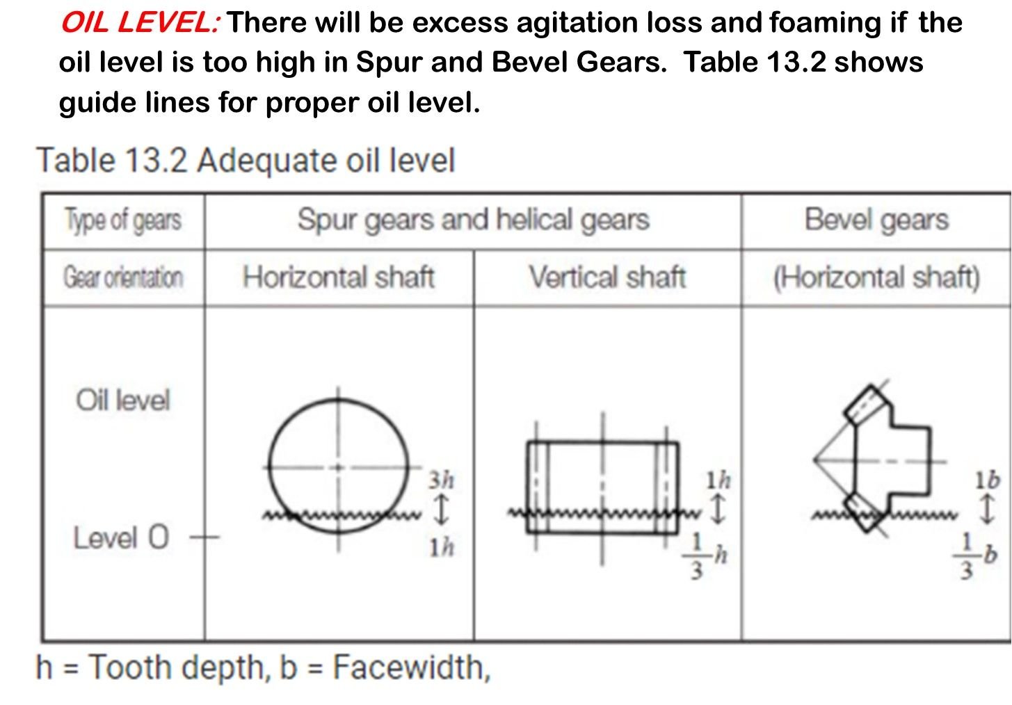

Yep, have been following the issue before I got my C8 in September 2020. Along with others have "speculated" why GM "probably" recommended adding for Tracking! GM has not said why! One well known YouTube posted said "he heard it was that GM found someone doing sustained donuts"- assume like a NASCAR winner! Foolish but would match what I thought "might be" the reason, high lateral "g" force causing fluid go go away from the oil pick-up. BUT GM has not said that is the reason. And my early Z51 Vettes did not have a dry sump and did hove special pan baffles (patented) like drag racers that kept engine oil under the pick-up! Been done for many years. The ONLY thing I have seen from a GM rep was quoted from a Carlisle Event where there was a talk and the rep said it was added if your Tracking going downhill the fluid will go to the top of the case! Since I don't "jump" by C8 not a credible reason to add!
Frankly although your Tech said GM recommends removing, Tadge said although the extra fluid reduce mpg somewhat (due to increased drag with gears running in more fluid) it's NOT required to remove after Tracking. Also did not see GM every saying not to add BUT a knowledgeable Tech posted he had taken like 50 DCTs apart for various reasons with and without the extra 2 quarts. Said there are many sensors, including 3 pressure sensors that will prevent damage if the pressure is several areas is insufficient. He sated several time in his long post NOT TO ADD UNLESS TRACKING. He showed there were like 100 CEL codes it will generate to protect itself!

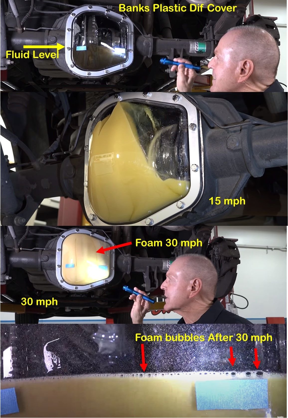

Here are two pics that also make me NOT add as I drive aggressively BUT don't Track. No sustained like high "g" turns. Yep hit over 1 "g" lateral acceleration for short time BUT not sustained and I don't make foolish Donuts! Your car but consider WHY DO YOU WANT TO ADD1 If GM says to add (like they do if tracking) I'd add BUT NOT because some folks think it's a "good idea but have no reason!" IMO, as Chuck, Rick Conti's Tech showed all Thermic had to do was put the add plug about a foot further back on the case. Appears to me to be an afterthought, for whatever reason!
Geared transmissions are NOT designed to have the gears in more than a low level of fluid!
The pics were taken from a good video by Banks who were designing a larger dif cover to hold more fluid to reduce max temps. The shape was very critical so as speeds increased excess oil foam was not created. Foaming oil reduces it's lubrication ability.
