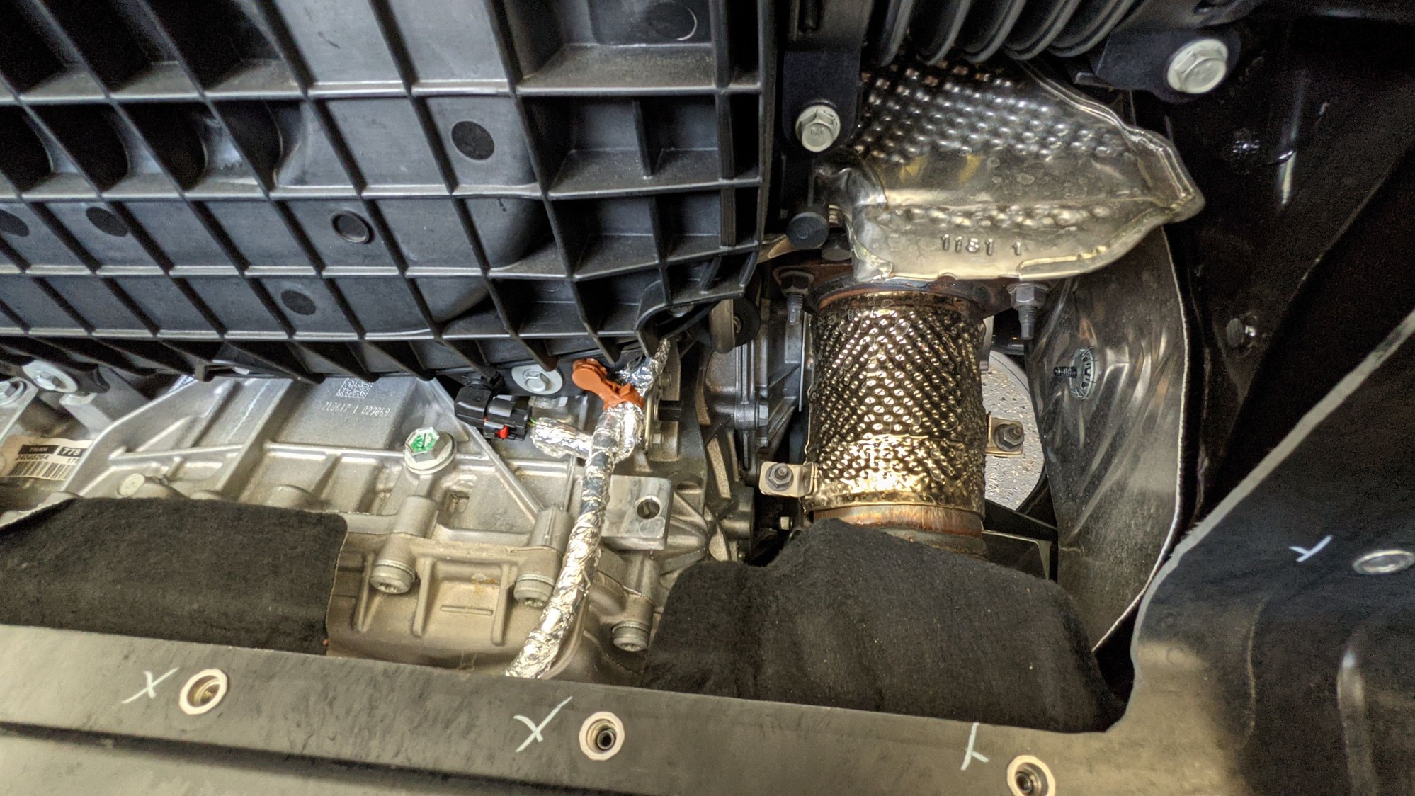

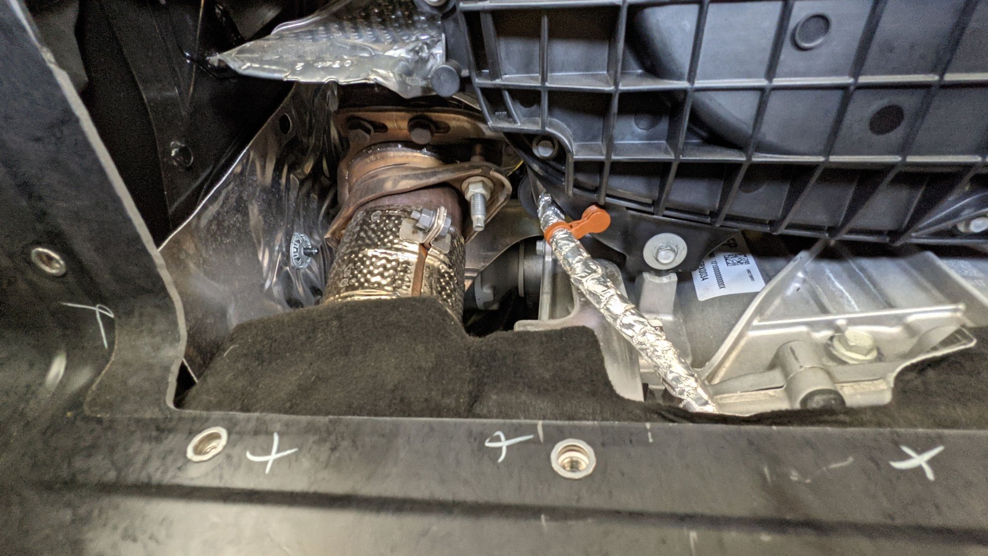

Old Feb 26, 2022 | 11:05 AM
iwantaz06now's Avatar
iwantaz06now
Joined: Jul 2011
Posts: 2,800
Likes: 166
You can gain access to the cats from the trunk

Paragon's video above shows it, but when you remove the trunk access panel to replace the air filter or intake system you have pretty good access.

Originally Posted by SECLT22021
is there a video showing that?
I would look at the instructions to install a c8 intake like from corsa. It's like 14 hex screws in the trunk and voila...access to the cats
Yup, Corsa & especially AFE has mega detailed intake install instructions. See attached documents and below video:
