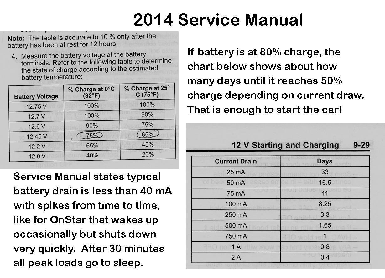

Here is what I find, driving 3 to 4 times a week. On the 25 mile trip to town the alternator will read ~14.5 volts. It's doing all it can to charge the battery. If I have driven the day before still read 14.5 volts on the way to town. On the way back will drop to ~13 volts! The charging in the C8 as it was in the C7 is controlled by a computer. IF it's charge 80% it will lower the current to save energy.
Pic is from my C7 Service Manual. Charging was the same, controlled by a computer.
It notes with an 80% charge (since that is all it will charge to save energy) about 30 days is all you can bank on to still start the car.
For my street rod I installed a high amp alternator (125 amps.) Thought driving once a week would be OK. So to get the oil hot to evaporate most of the cold starting blowby water I have a 20 miles route I take. Battery died! Measured my parasitic current draw, which was about 50 milliamps. Then calculated starting power to crank the 8.2 Liter BB. At the rpm's I was using for that 20 mile drive looking at a graph of alternator output versus rpm I was NOT charging enough. Now the street rod with it's Yellow Top Optima AGM battery is on a charger 24/7! It does extend battery life as was mentioned.
Bottom Line: Depends on how many miles you're driving each week! I have the equivalate of the GM sold charger (bought on Amazon at ~40% of GM price.) Only use it occasionally as it's a PIA when I want to use the car I want to get in and drive! IF I used it once a week, I'd plug it in!
