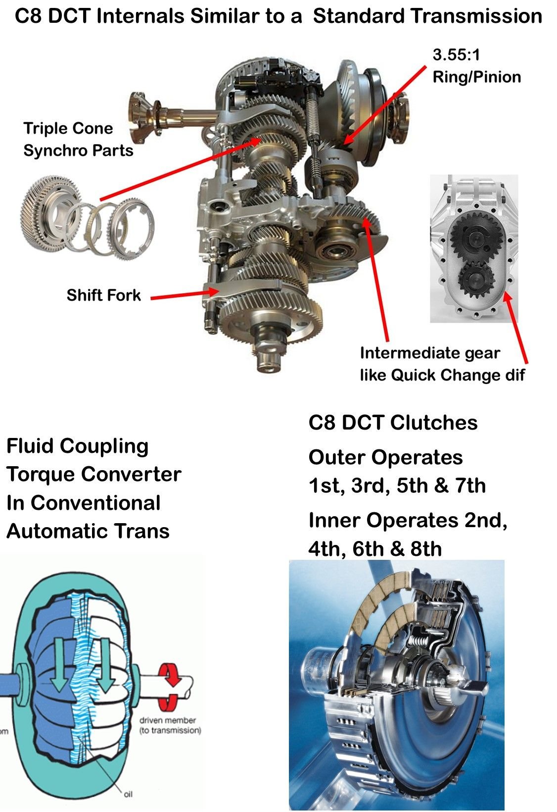

No that is your definition of an automatic NOT mine! Don't care if Porsche or Kamala Harris calls it an automatic!
My definition of an automatic is the traditional "slushbox" with a fluid coupling torque converter and many clutch packs, sun gears, bands clamping gear cases etc which in 60 years I never had as a DD!

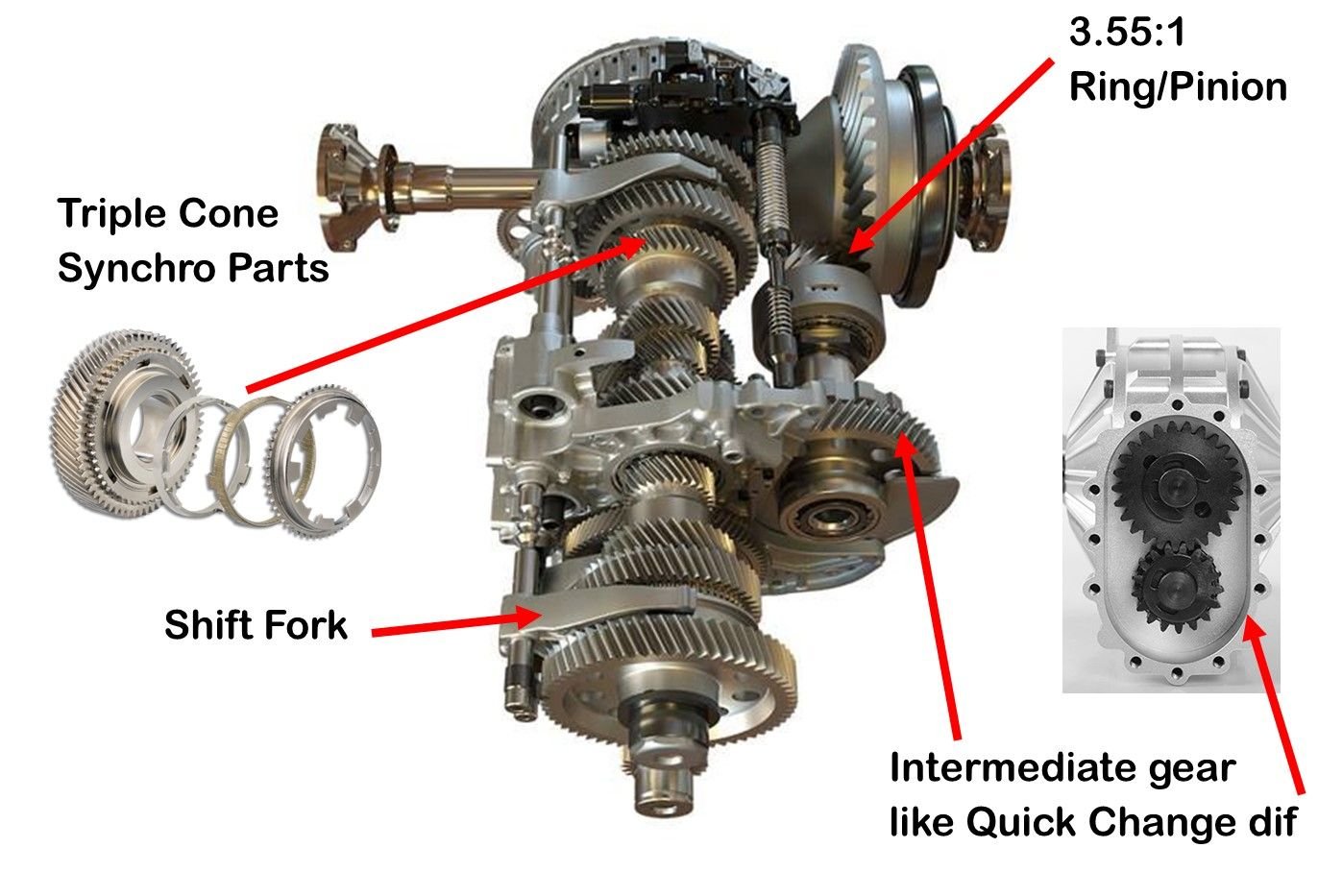

This is what is inside a Tremec DCT. Shift Forks, Synchro's with triple cones JUST like my two C7 M7's. A difference is instead of a manual lever moving the shift forks with my hand etc it has hydraulic actuators. AND IF I drive in Manual Mode and use my hands to pull levers I decide when they move NOT some computer!
It does not even shift by itself in Manual Mode when you hit the Rev Limiter! Just like my C7 M7s you hit a brick wall when the DI shuts off all fuel!
NOW I understand it's a question of semantics. And you and Kamala can call it anything you'd like. BUT for some of use "mechanically inclined" there is a world of difference and we'll call it what reflects what we know is inside!
Yep DCT has same main elements as my two C7 Tremec M7s!
Yep lots of always in mesh helical spur gears. Shift Forks, Synchro's, Triple cones etc

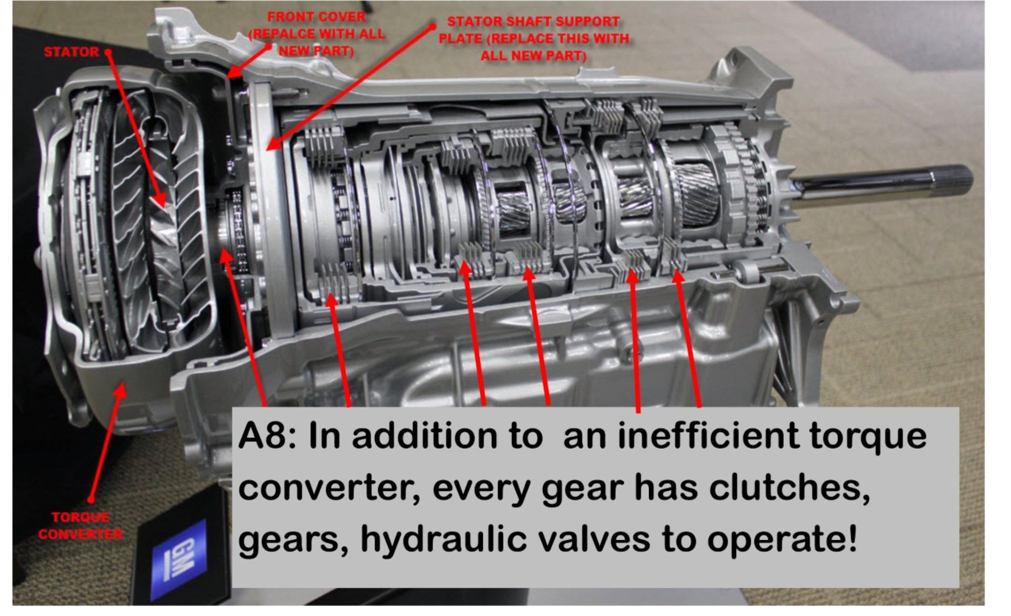

"Slushbox" Automatic

Try starting in 3rd gear. Try shifting from 3rd at 6500 to 2nd gear. You will find it won’t allow either, whereas those manuals in your C7 would allow it. Heck, try driving along in 4th gear and coming to a stop and tell us if it stays in 4th all the way down to zero. You will find it is indeed an automatic transmission as it will not follow you commands.
You are too smart to really believe your position is accurate.

As the dog and I took our several mile morning walk around the Lake, thought: with the DCT becoming more popular believe it needs a better definition than automatic or manual. WHY? Some of the ~80% Corvette owner’s who have conventional fluid coupling torque converters are confused about the operation.
When the early build C8s arrived there were questions like; "Why in bumper to bumper traffic is it not operating like my “Automatic Vette.” Had to suggest they treat it as I did all my standard shift cars in that situation. Let the car in front get a car length or so ahead before moving up! Don't modulate brake pressure and crawl forward staying close to the car in front! Once they understood why, those folks accepted it’s differences!
DCT Definition:
"A DCT (Dual Clutch Transmission) is two standard shift transmissions (with constant mesh gears, shift forks, synchro’s etc) that are activated by two concentric clutches (wet or dry) by engaging one when the other is disengaged. Each is connected to one of the two transmissions and can be operated:
  1. manually by pulling a paddle (switch) to have hydraulic actuators operate the shift forks etc.
  2. automatically where the shift forks are moved by the hydraulic actuators controlled by a computer algorithm based on speed, throttle position etc."
IMO this is a much better definition than the simple Automatic or Standard Shift label. Similar to the Passport Office now accepting X not just M or F based on a person having an appendage or not!
