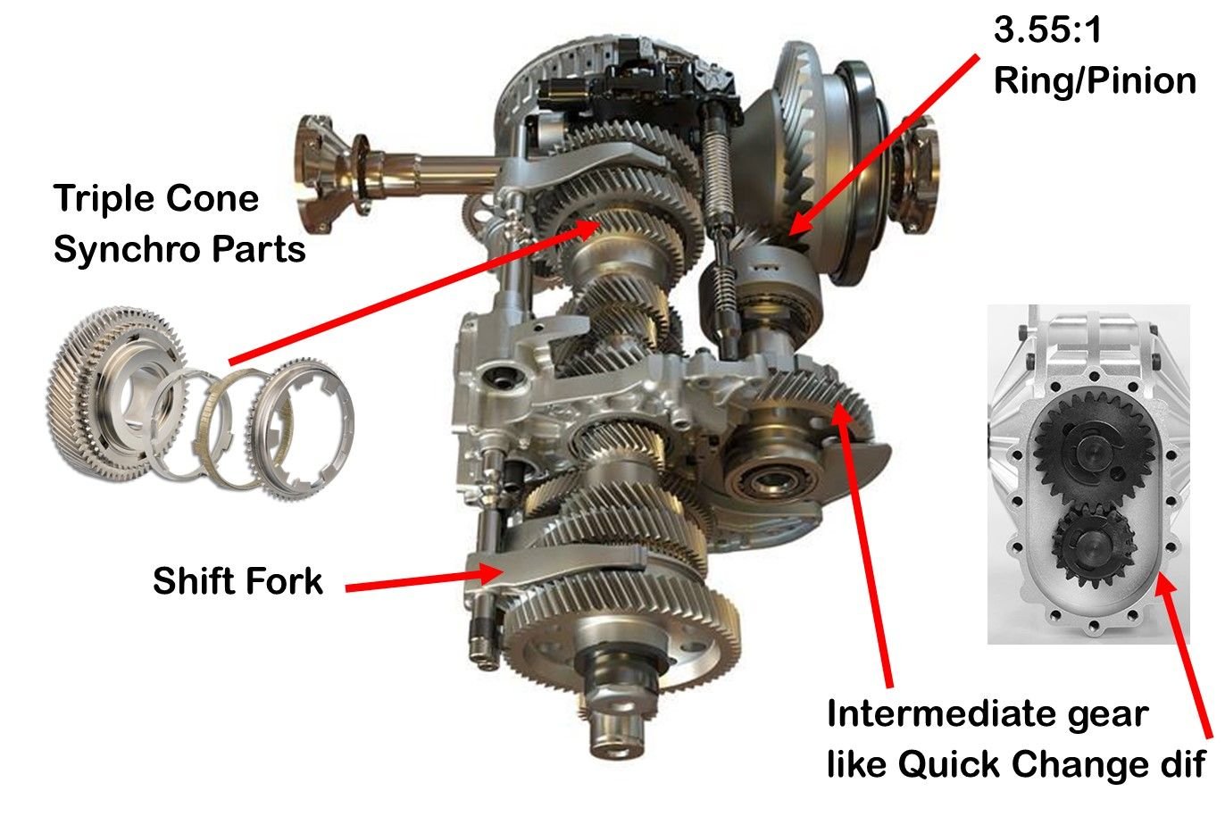

Launch Control is logically the fastest considering GM’s Chief Corvette Engineer, Ed Piatek statement: “We found that during very aggressive launches we can drive torque through both shafts/clutches simultaneously which improves the 0 to 60 times.”
SIDEBAR
Perhaps I'm reading more into the words Piatek used, "WE FOUND" but I was very surprised at that statement when a DCT MUST disengage one clutch before engaging the other- or so I thought! His statement makes me reflect on what the R&D Lab I managed (totally different field) would do if given the assignment to define the minimum time before one clutch was engaged after one disengaged.
Would set up the DCT in the Lab with a dyno measuring output torque and powered by a mensurable controllable power source. Then control the shifts and clutch engagements while changing the timing in millisecond steps! There are delays in the hydraulic circuit timing, valve and clutch actuator activation etc. So not too surprising that we might get close to zero planed dely.
But would not have anticipated we could actually engage the 2nd clutch before disengaging the 1st! However would run the test until something broke! Then depending on what it was make the part beefier of say we reached the minimum time.
Perhaps a surprise they could go past zero! They have not given details and things like the gear cluster shaft having torsional defection, slippage of the triple synchro cones etc would cause a delay in activation, perhaps deferent than deactivation.
Some day GM may write an SAE technical paper and give more details. But for now it is what is creating the very fast 0 to 60 times. I do recall reading it operates in 1st and 2nd, which would be logical as a Z51 shifts at redline in 1st at ~35 mph and out of 2nd at 60 mph.

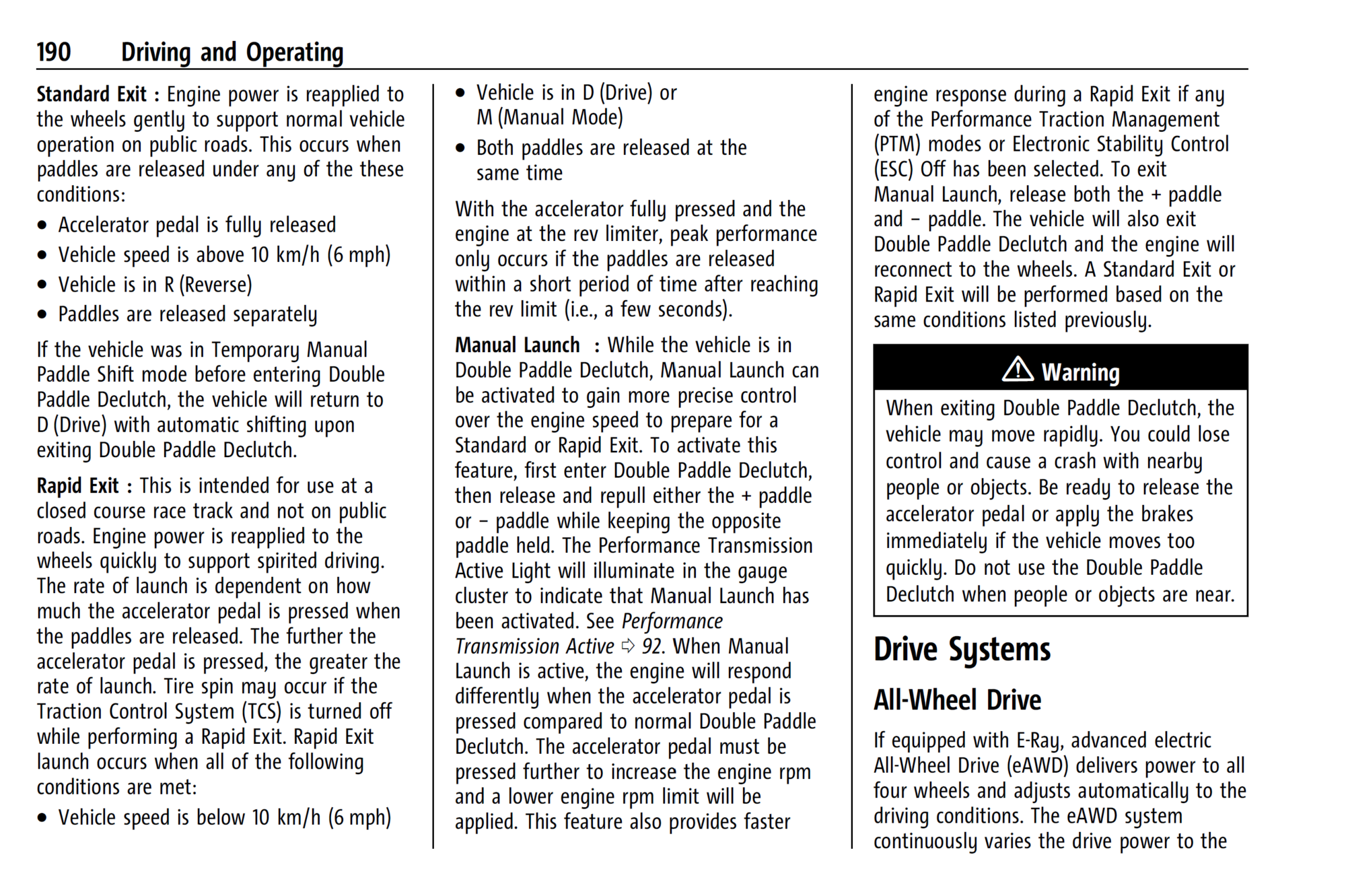

Interesting. The 2024 now goes a step beyond the rapid exit description in the earlier manuals (that already seem to legitimize the rapid exist approach). In the 2024 Manual there is an entire paragraph on Manual Launch Control. It sound just like rapid exist, except for an extra step of releasing one paddle, which then initiates the Manual Launch Mode, to be distinguished from the rapid exit, described on the same page.
