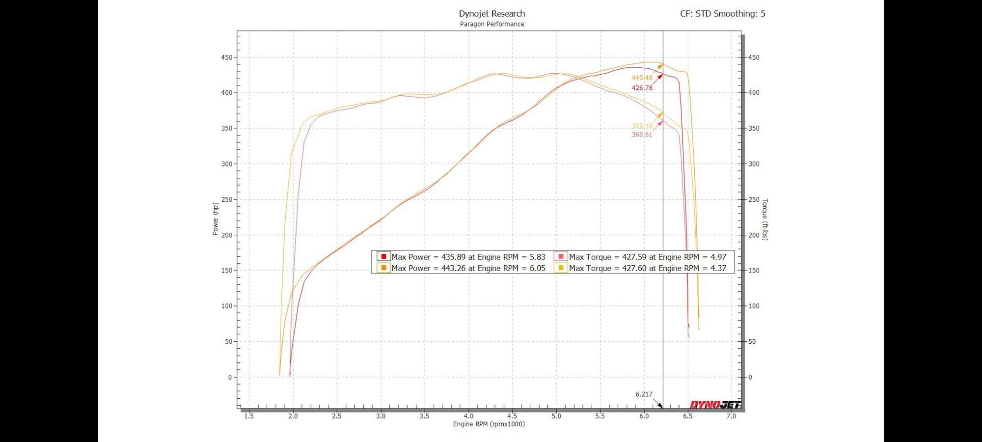

If the absolute top-end is what you're after, here is a comparison I made Halltech vs. Corsa from just 5,000 to 6,500 RPM.
Halltech:
Corsa:

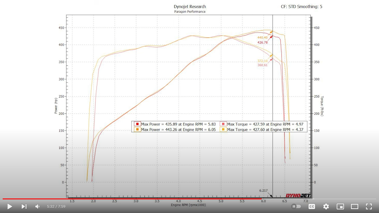

Heres another dyno from paragon on the same dyno with the Halltech...
Same intake from the shootout...
Basically all the intakes are within the margin of error of even the stock output.

The rpm shown above illustrates the comparison rpm line (which is operator chosen) @ 6217 rpm which is the drop off point.. You left out the peak RWHP for the Halltech Hornet in this dyno, which is 443.26@6050 rpm.

I did not leave it out, it was included in the portion of the graph I highlighted plus mentioned in my peak number summary back on page 1 of this thread. My comment, which you quoted, explains the purpose of the small chart segments.
Originally Posted by Kracka
Quick summary of peak numbers so we have it documented (in order of appearance):
Brand / WHP / WTQ
  • stock / 436 / 428
  • K&N / 441 / 430
  • aFe Pro5R / 441 / 429
  • aFe ProDryS / 444 / 435
  • Halltech / 443 / 428
  • Corsa / 448 / 431

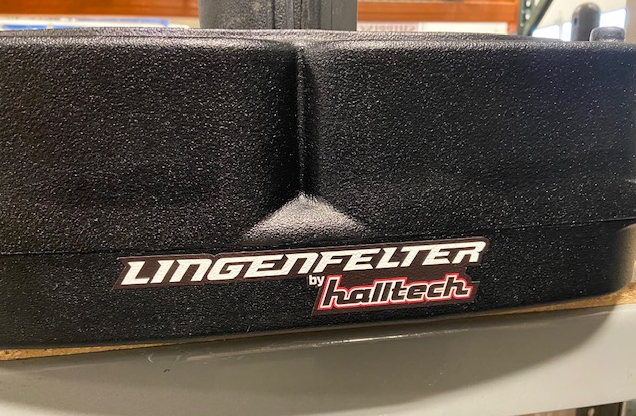

After all the dust clears, you can see which intake is being used by Lingenfelter. We are now marketing partners.

Nice move......i really like Lingenfelter customer service and their products. Speaks volume.
