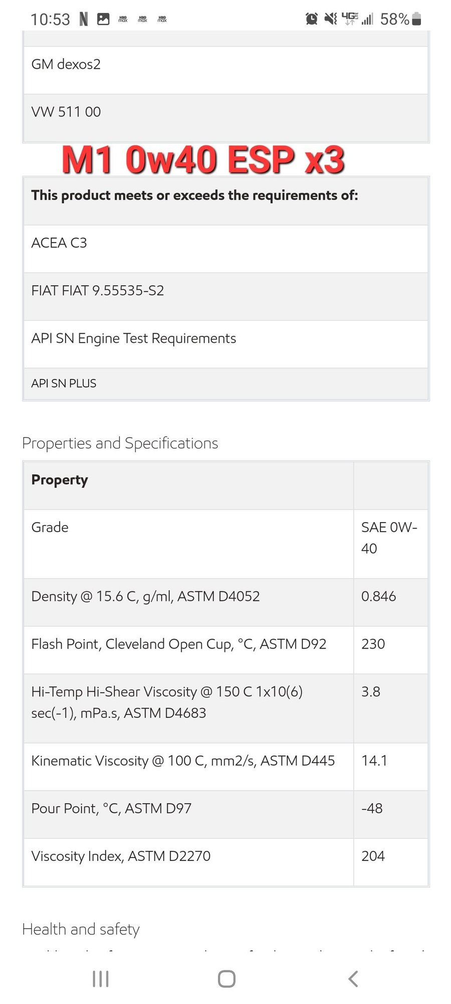

I just ordered the esp x3 which is also dexos 2 but has a 3.8 high temp shear vs our esp that has 3.5.
https://www.evolubesupply.com/mobil-...bottle-124798/

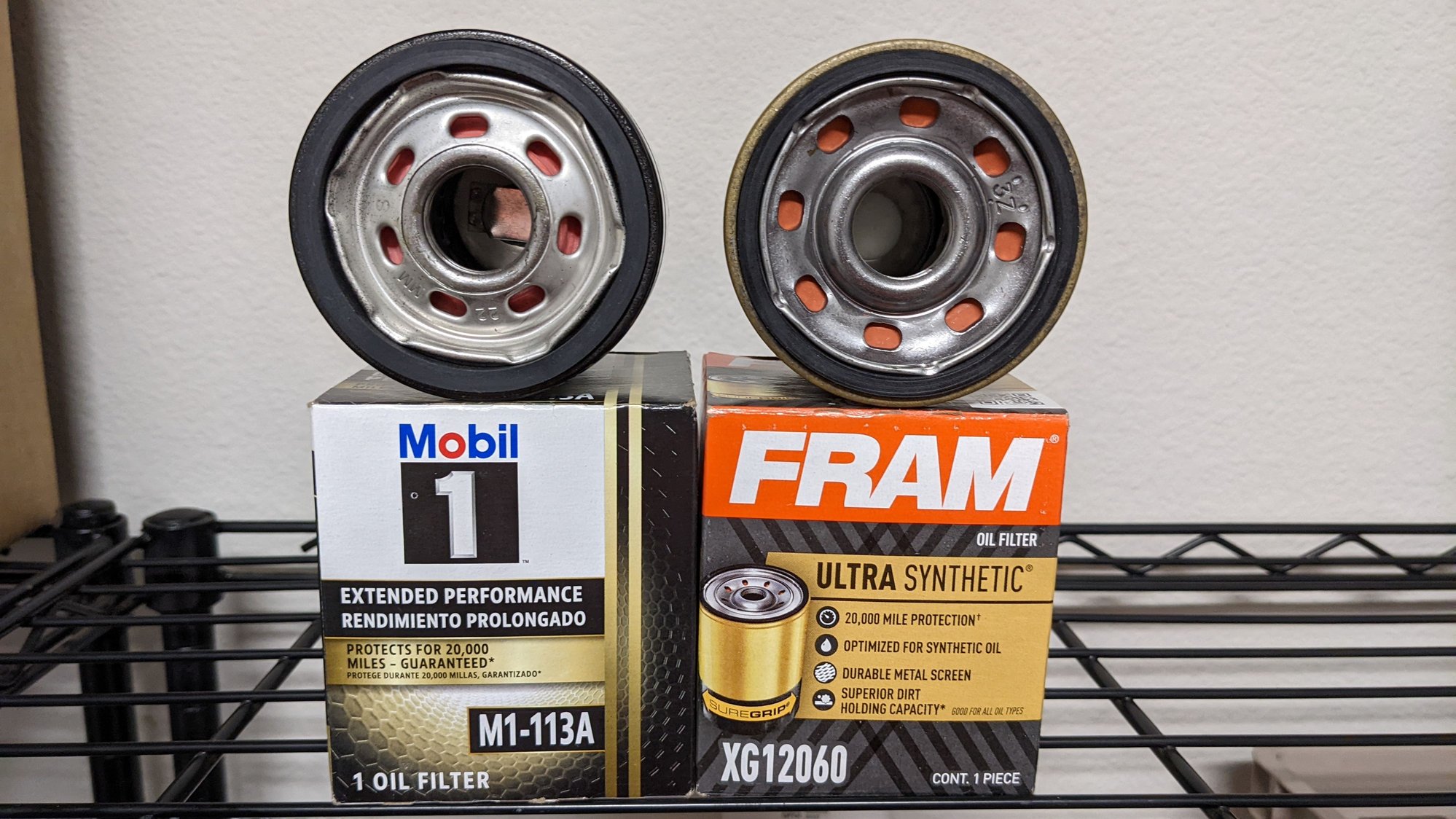

My shipment from AutoZone arrived and they actually sent me Mobil 1 0W-40 ESP x3 along with the oil filters.
Is this oil truly an "upgrade" vs. our factory oil or should I exchange it?
The M1-113A filter appears to have been redesigned since I last saw one, now with larger drain holes. Still not as large as the Fram XG's, but the inside tube louvers actually look better. Overall, the XG canister is slightly larger, but the M1 is heavier.

My shipment from AutoZone arrived and they actually sent me Mobile 1 0W-40 ESP x3 along with the oil filters.
For me, the biggest controversy with the M1-113A oil filter is how they can specify it for the C6 with a lower bypass pressure but also for the C7 and C8 with a higher bypass pressure requirement.
Is the same Fram XG listed for the C6, C7, and C8 also?
I know Champion Labs used to make the M1 filters but I believe Mobil 1 switched suppliers.
Fram XG12060 is specifically for the modern GM vehicles requiring the higher bypass pressure. The bypass is rated 19-25 psi. This is my preferred filter for C7 & C8 applications. Fram does not list it for the C6. It also is rated 99% down to 20 micron while M1 is rates 99% at 30 micron. I am getting more annoyed they sent the wrong oil and may go return it... I want the stuff specially engineered for the C8.
https://www.fram.com/parts-search/XG...%20muhl5p2gXSA
the X3 is the best oil M1 makes, it meets the stringent Porsche test levels and certification and is dexos approved. Ive been running it for a few months now. Superior to std fill esp, keep it and consider yourself lucky....most people dont know about it yet.
the x3 is a better oil.

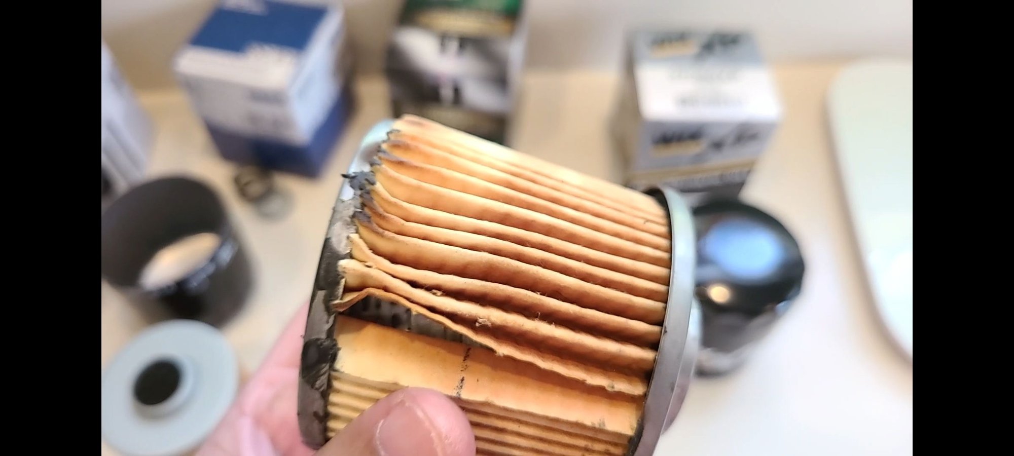

Id use oem filter only under warranty. If the oem oil filter shows a failure you're still fully covered on an engine replacement. If an aftermarket oil filter fails they would not have to cover you.
​​​​​​Heres the last brand new m1 filter i cut open anyways...

Well that filter looks like a steaming pile of garbage! BITOG is big on the Fram XG filters so I think I am going to stick with them. Honestly haven't seen or heard anything bad about them; no horror stories anyway.
For anyone who is running the M1 filters (I used to on my C7), here is what I was directly told by Champion Laboratories (the maker of the M1 filters) back in 2017:
The Mobil 1 M1-113 or M1-113A both use a 22psi by-pass valve.
Paul Ankenbrandt |Catalog Editor | Champion Labs |o: 618-445-5638 |
230 East Walnut Street, Albion, IL 62806

I ended up returning 2 of the 3 M1 filters to my local AutoZone and got about $30 back. End of the day not a bad deal considering I got 15 quarts + 1 filter for about $100! I kept one and will use it to give it a shot since it's the new redesign with larger oval drain holes. My local store had the new box on the shelf, but the filters inside were still the old style with smaller circular drain holes. Here's a comparison of the "new" M1-113A vs. the XG12060 (original style with metal screen backing on the media):
Both filters are made in the US of A
Mobil 1 also has a warranty when using their filters. So if GM were to deny coverage of an engine failure due to a M1 filter failure then you would have documentation that the failure was caused by the M1 filter. Additionally, we have documentation the the M113A meets the GM requirements. But this is highly unlikely, and I don't think GM would throw their strategic partner under the bus.
