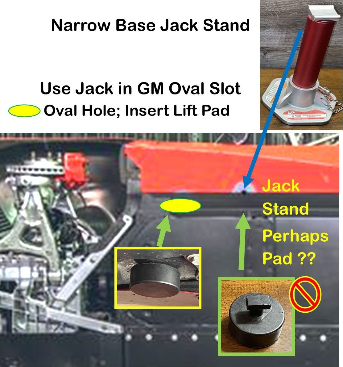

Yep both ReenStand and JackPoint work BUT require you to buy their Jack Pads that fit the C8 and their device.
A member posted his cheaper method I put in my How Too Install Brake Pads PDF on C8 Z51: http://netwelding.com/Ceramic_Pads.pdf
If careful in placing GM Jack Pads and Jack Stands can do much cheaper. Pics below.
BTW as the LT2 oil pan drain plug is on the front of the engine NO NEED to have the car level to change oil. May get more oil out with just the rear wheels raised and put on stanchions (my preferred safe lifting method when not removing wheels!)
Forum member used both jack pad, jack and narrow base jack stand close together to remove his brake caliper to change pads. If careful, can also work in reverse without (as he did) modifying GM spec Jack Pad to insert in round hole.)
I reversed the pad jack stand position so no need to modify Jack Pad to fit. If the jack stand is placed close enough to the Jack Pad/Jack should be fine. For sure in front, where forum member used to remove front caliper when changing brake pads. If careful should work for rear. IF just to change engine oil wheel stanchions would be very safe.
Where with my C7, I got the car level with stanchions in the rear and jack stands on the front crossmember, not needed with the C8. C8 engine drain plug is in the front of the engine so you'll get slightly more oil out just putting the rear wheels on stanchions. Place on the stanchions with jack pads and jack! Cheap!
