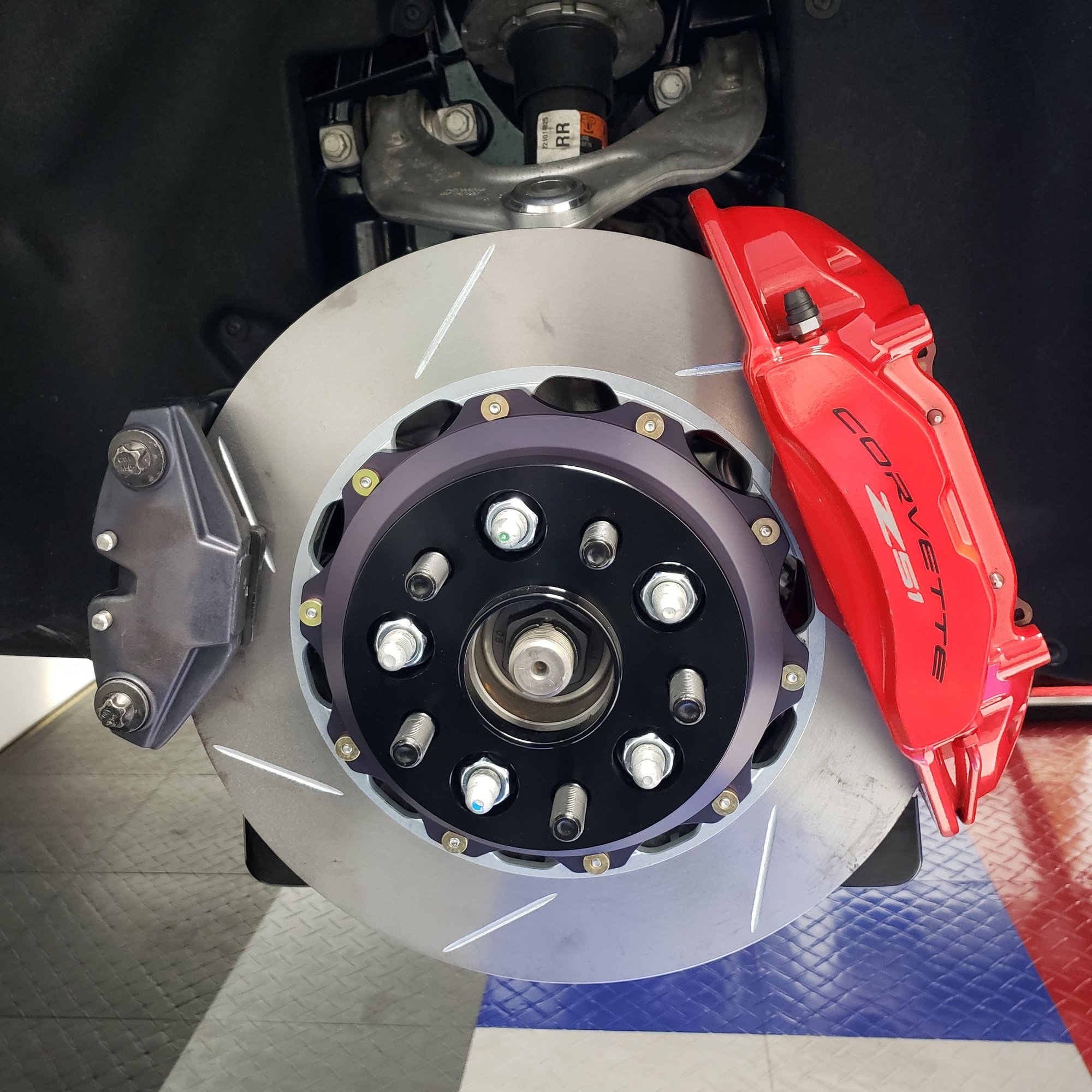

I have a 22 C8 Z51. I installed Paragon lowering collars and Paragon wheel spacers. My wheels are the spectra gray tridents and I did have to grind the studs. I just ground down the outer rounded portion of each stud with a grinding wheel mounted in a drill. I didn't have to remove much material. I think lowering the car about .75" and spacing the wheels out 20mm make the C8 look like it should oem. IMHO.
