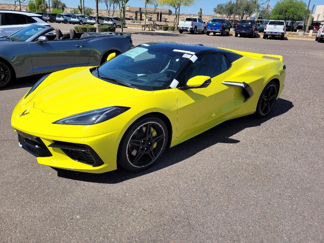

Originally Posted by Kracka
The car hasn't been prepped through PDI yet.
If the car hasn't been prepped through PDI yet then where did the dust come from?
Old May 22, 2022 | 03:54 PM
Kracka's Avatar
Kracka
Joined: Jan 2014
Posts: 10,709
Likes: 7,102
From: Fulshear, TX
[QUOTE=MarkMeHopeful;1605167766]
Originally Posted by MarkMeHopeful
So what makes your C8 a Stingray R? That usually implies that you have the Stingray R appearance package from GM (which you don't).]
The picture above... That's why it doesn't have the front splitter, Stingray R decals, etc. You can also see some of the shipping protection wrap had yet to be removed.
