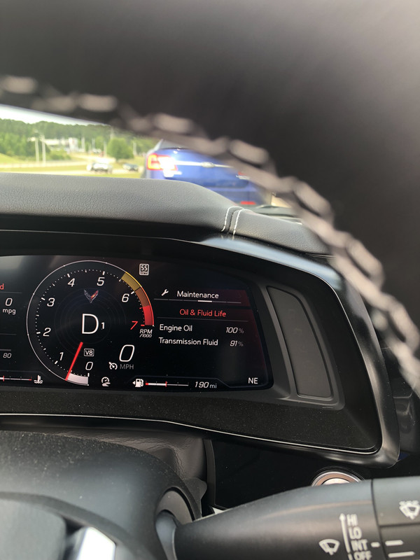

Engine Oil is 100%, transmission oil is 91%.
Is this right or do I need to go back?
The don't reset the trans oil if you just had the hydraulic system flush and trans filter change. The trans oil was not changed.
I was told it was. Let me check the work order.
Nope you're fine. They changed the OLM back to 100% but properly did not change the DCT fluid life.
Agree! My DCT fluid life did not and should not change with just my flush and filter change.
It will probably still show ~70% life left when I have all the fluid changed as required by GM at 3 years (Note 4 in Maintenance Table which says 45,000 MILES or 3 years WHICHEVER OCCURS 1ST.)
The DCT % Life does not consider time as does the engine OLM (Or after 1 year of 3 years required change would read 66% Life Left! So if I have ~12,000 miles at 3 years when the DCT fluid gets changed it will probably still read (45,000 -12,000)45,000 = 73% life left! We'll see.
