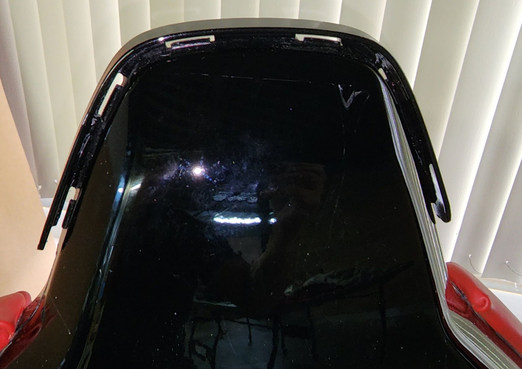

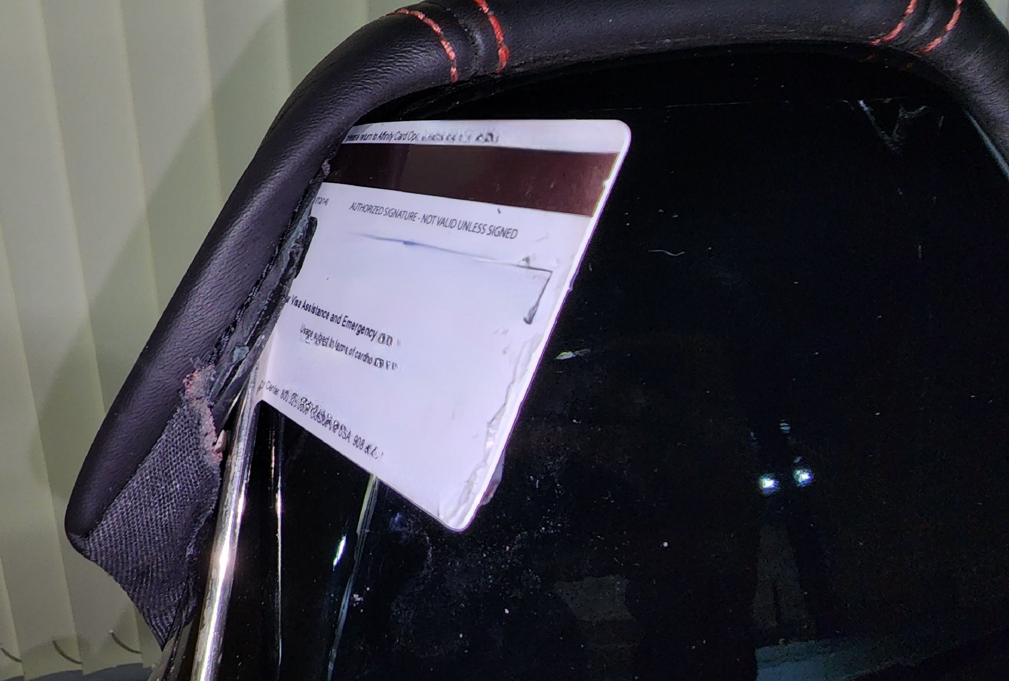

Like Jeff V. said, there's a semi-rigid plastic ridge along the edge of the leather cover. I used an old credit card to protect the seat backing and pushed it under the ridge. Then with a long thin flat head I slowly worked it out.

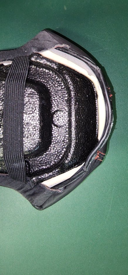

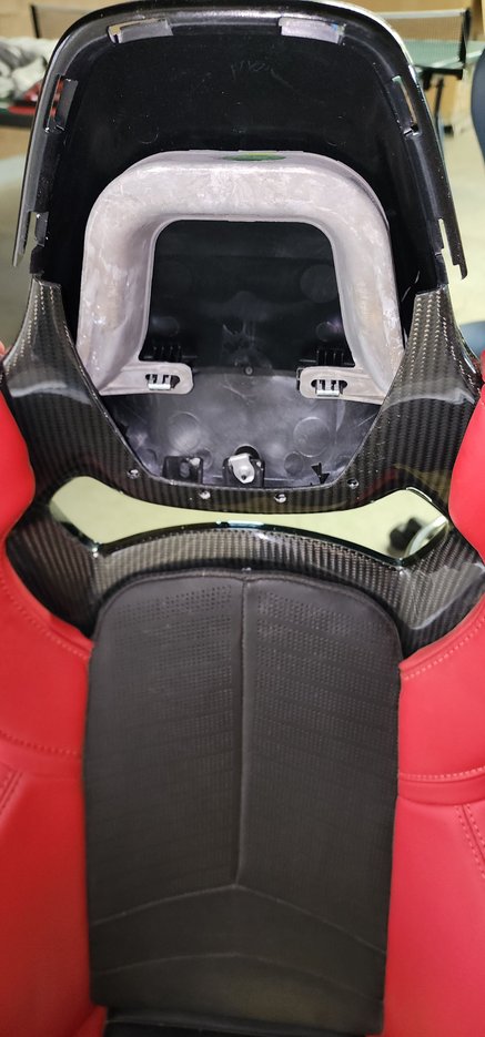

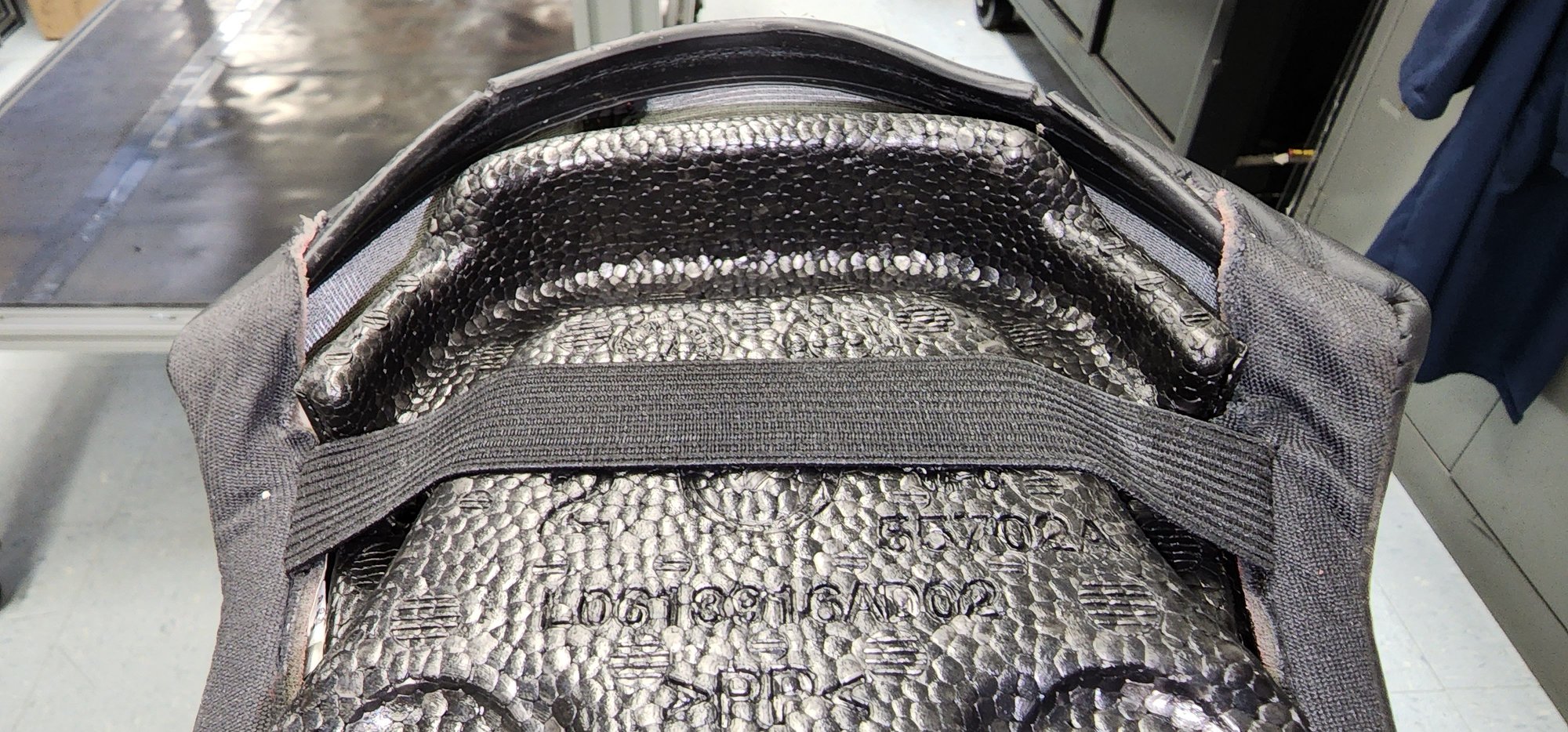

A few pictures of the headrest removed. Hope this helps.

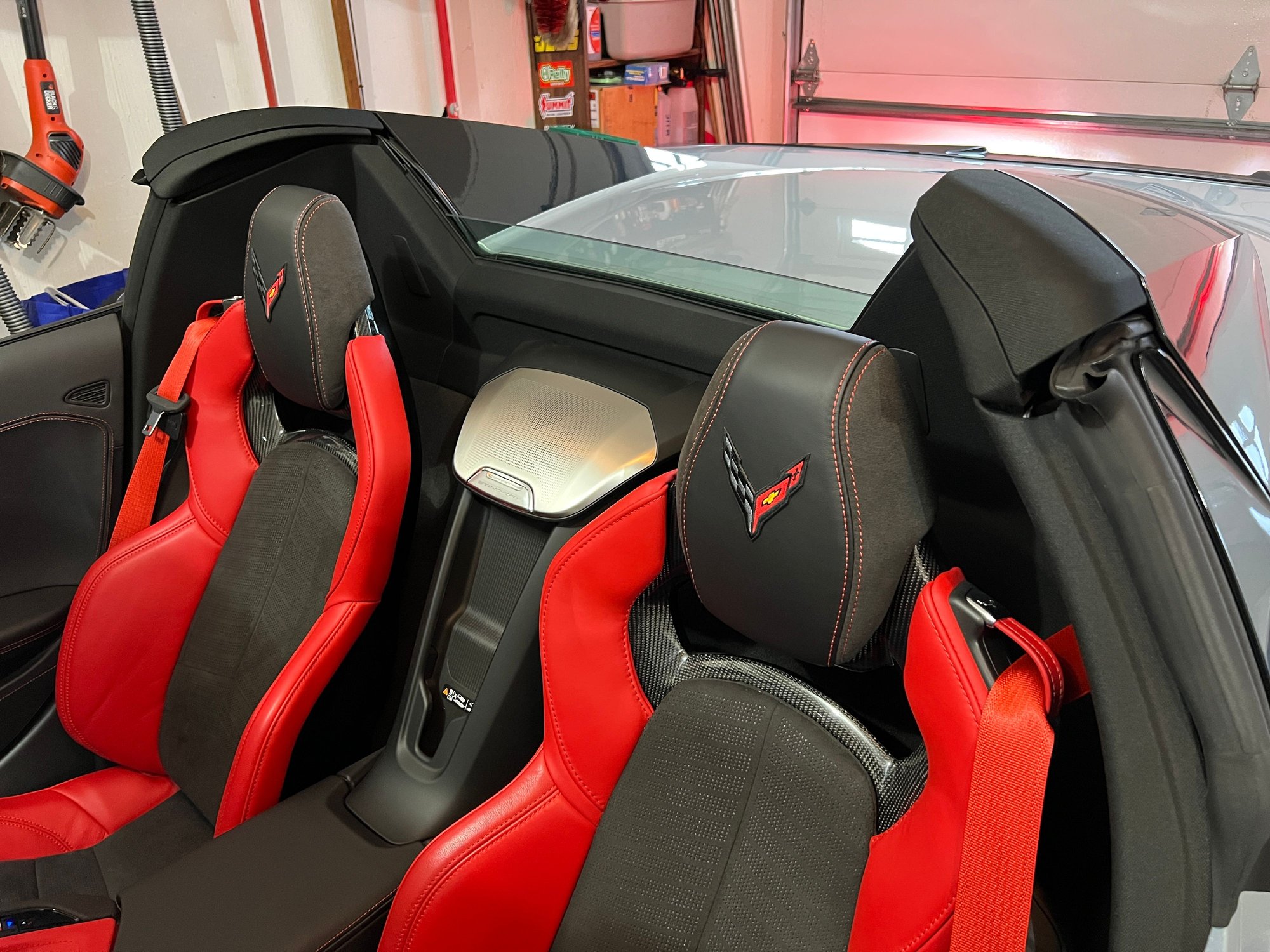

Boy, seems like a lot of work. I bought some embroidered Corvette Flag stick-ons last year. They fit over the embossed flags on the head rest nicely. No issues so far.
