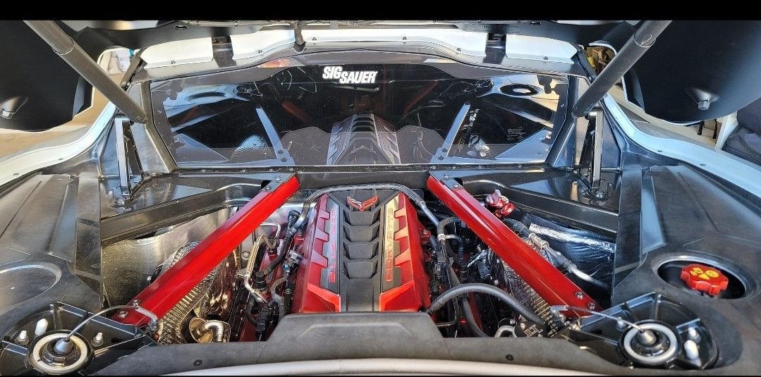

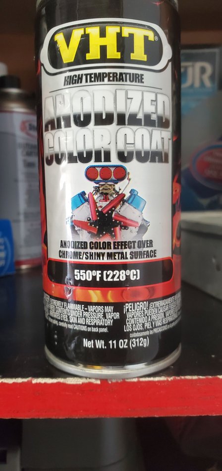

Originally Posted by loutruffa@gmail.com
I would like to paint my engine cover the same edge red as my calipers and the valve covers . I can’t seem to find a high temp spray in edge red . Has anyone done this ? If so what paint did you use ? Thinking caliper paint or an engine paint ? I know I can buy a cover for $550 but I figure I Have little to lose to try and paint it myself if I can find the right paint
Old Jul 8, 2022 | 08:06 AM
loutruffa@gmail.com's Avatar
loutruffa@gmail.com
Lifetime member
Joined: Feb 2022
Posts: 180
Likes: 70
From: Palos Heights IL
That looks great TR VET I like the red braces too what paint did you use ? I was also thinking of painting those A shaped brackets holding the struts

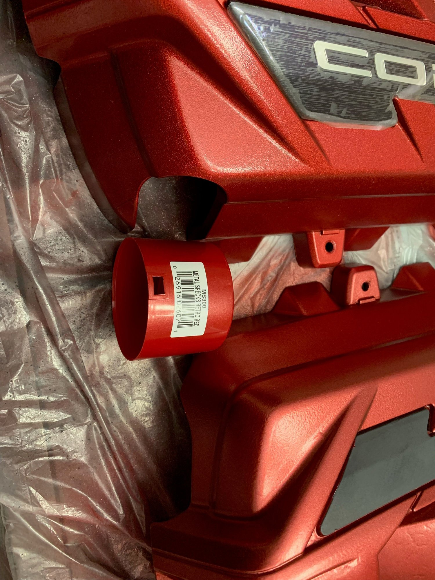

Default Metal specks retro red MS300
I used Dupli-color Metal specks retro red MS300. Below are comparisons of the OEM Edge Red cover and the one I painted.
