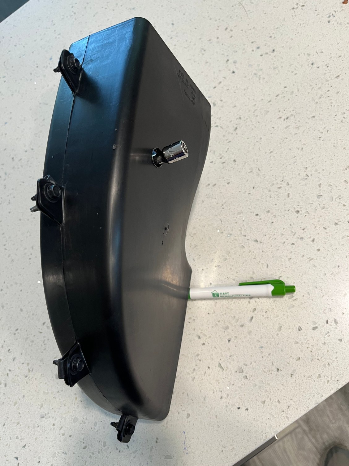

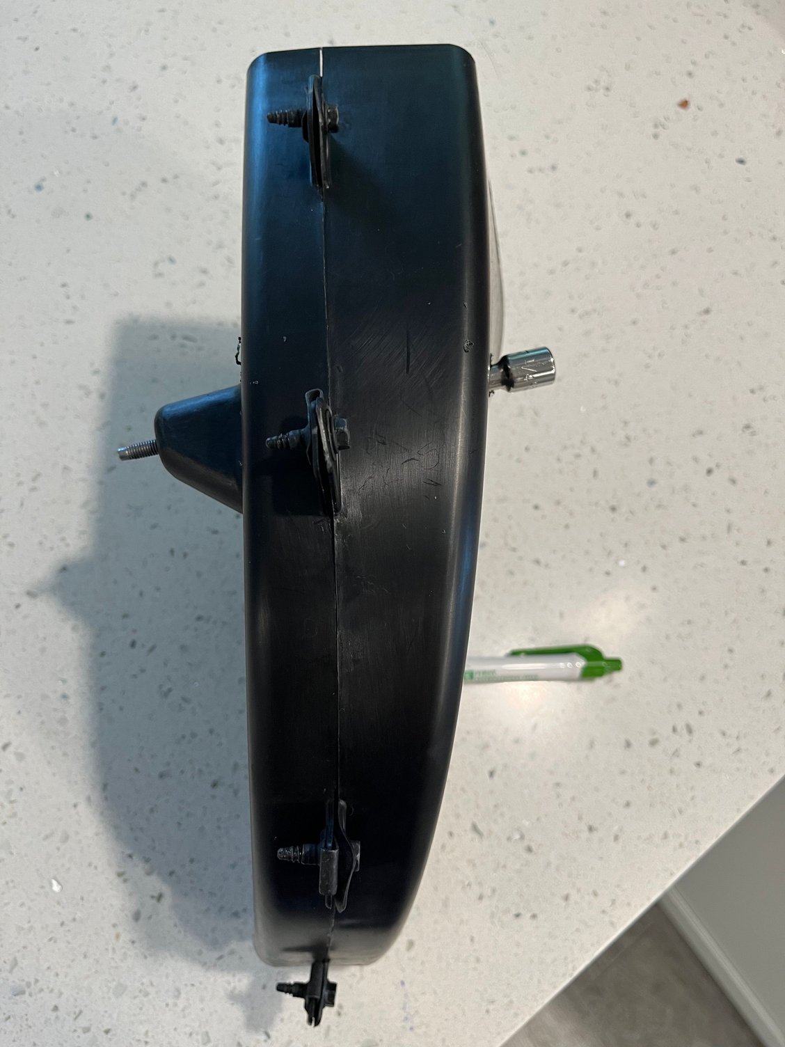

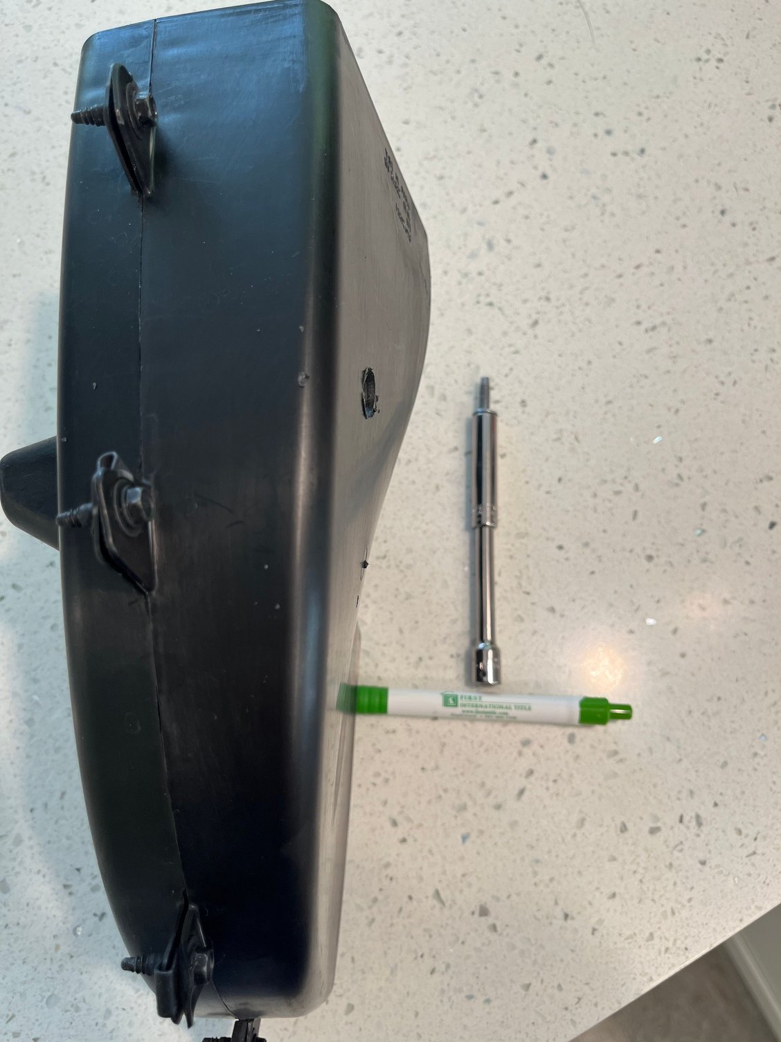

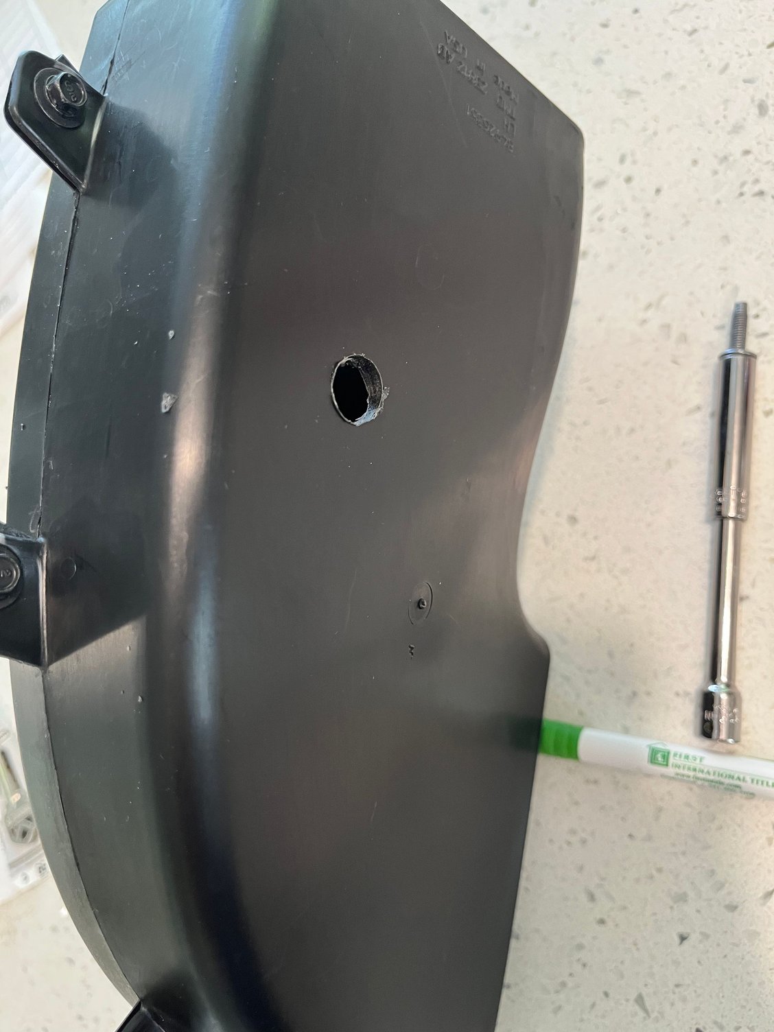

I thought it would be interesting to know what others are doing to make things easier or better after I did this:
on my 2022 Z51, installing the rear brake cooling ducts one piece at a time, attach upper with three bolts, attach lower half, repeat other side and reverse for removal. Why not leave them assembled and attach/remove with the three bolts? Here what I did…

This is what I've done also. But I seal the hole up with metal heat tape that I use on my wheel weights so it keeps all the air in. Still wish someone would make a solid direct one piece.

Great minds think alike...lol Did the same thing on my '21 C8 Z51, duct taped the hole.

I did this as well. Bought half inch plastic plugs at the hardware store.
