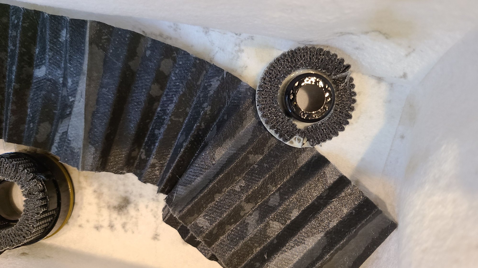

Posters have autopsied their dct filters in the 2k mile and up range in mileage and they reported seeing dark fluid with transmission debris that looks a bit like jewelers rouge polishing compound bits.

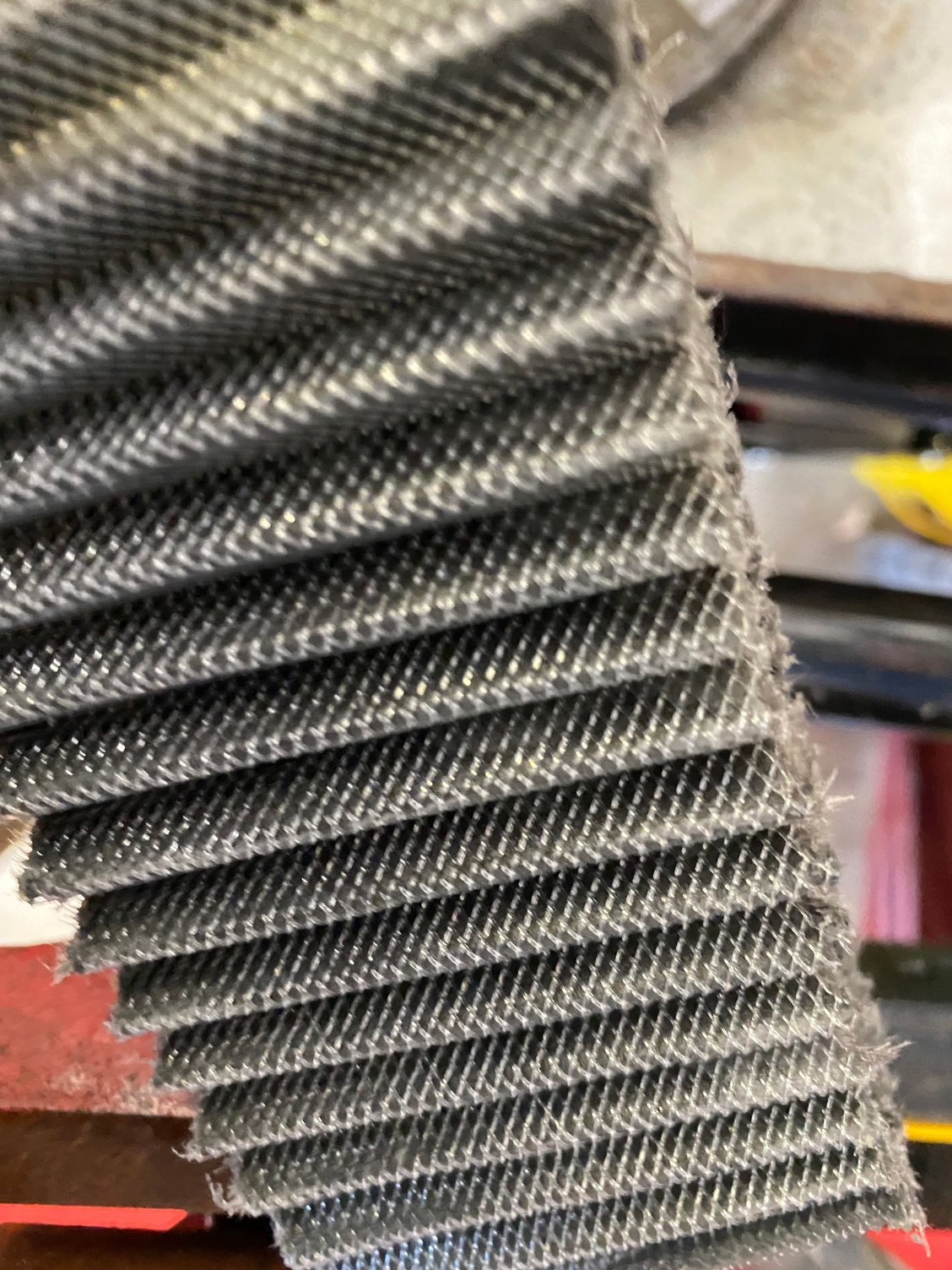

Example from Warp Ten

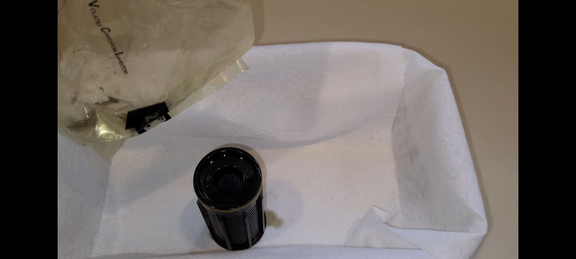

My Story
I took delivery of the car with 2 miles on it. From the moment I drove it off the lot I put the transmission in TRACK mode purposefully during break in. I did this for two reasons:
1. Touring mode seeks out the highest gear for fuel economy meaning more gear changes and lugging the engine at 1200rpm. Bad for the engine.
2. Touring mode means smoother shifts and smoother shifts means more clutch slipping. Bad for transmission break-in.
Ive now driven the car 2912 miles with probably 20-50 quarter mile passes and launch controls. Being stuck in traffic on a road trip. Multiple high performance (150mph plus) datalogging sessions and below are the results of my dct filter change...
I found zero visible solid debris/ contaminants.
Yes we did the hydraulic system flush into the filter.

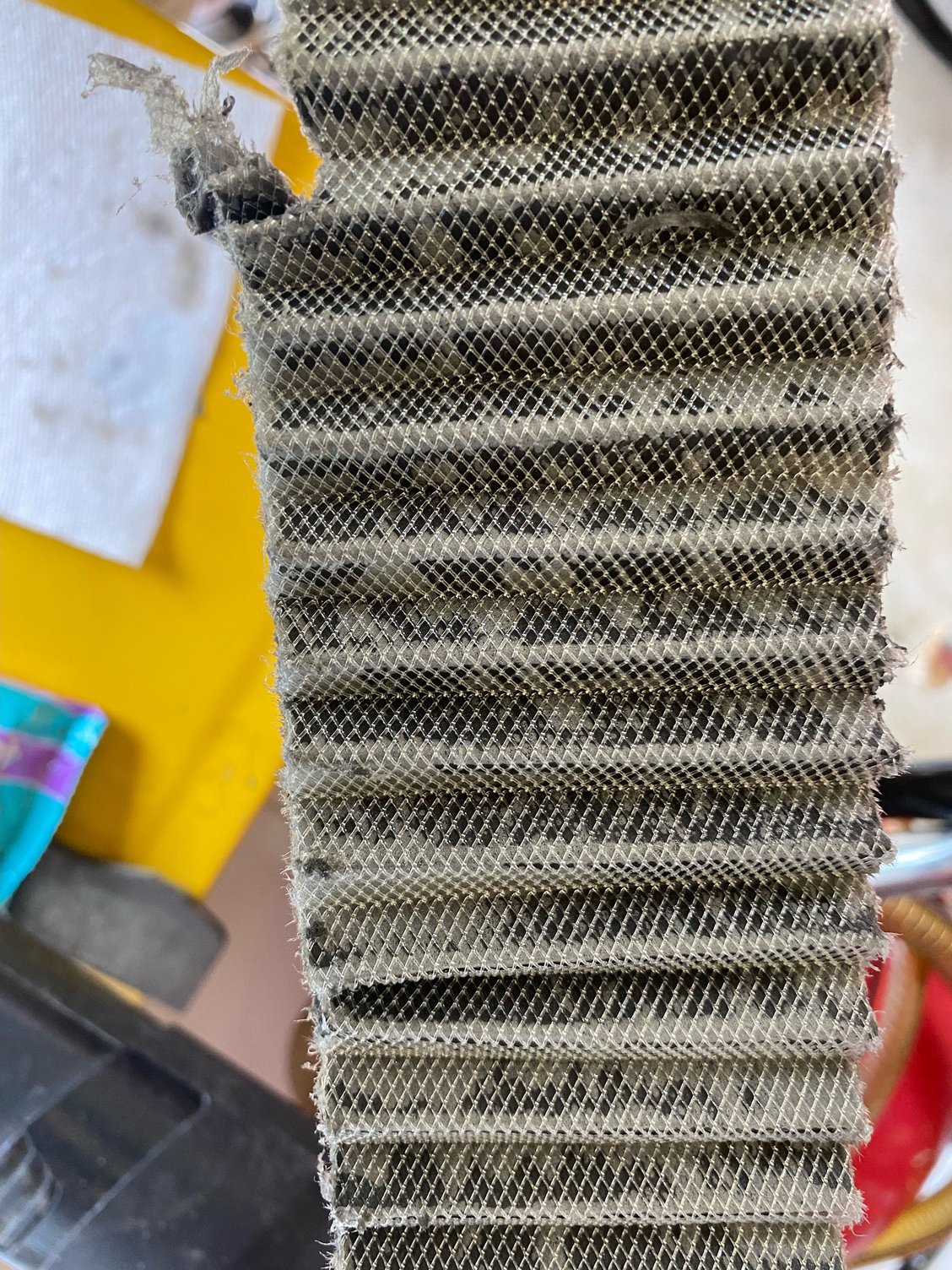

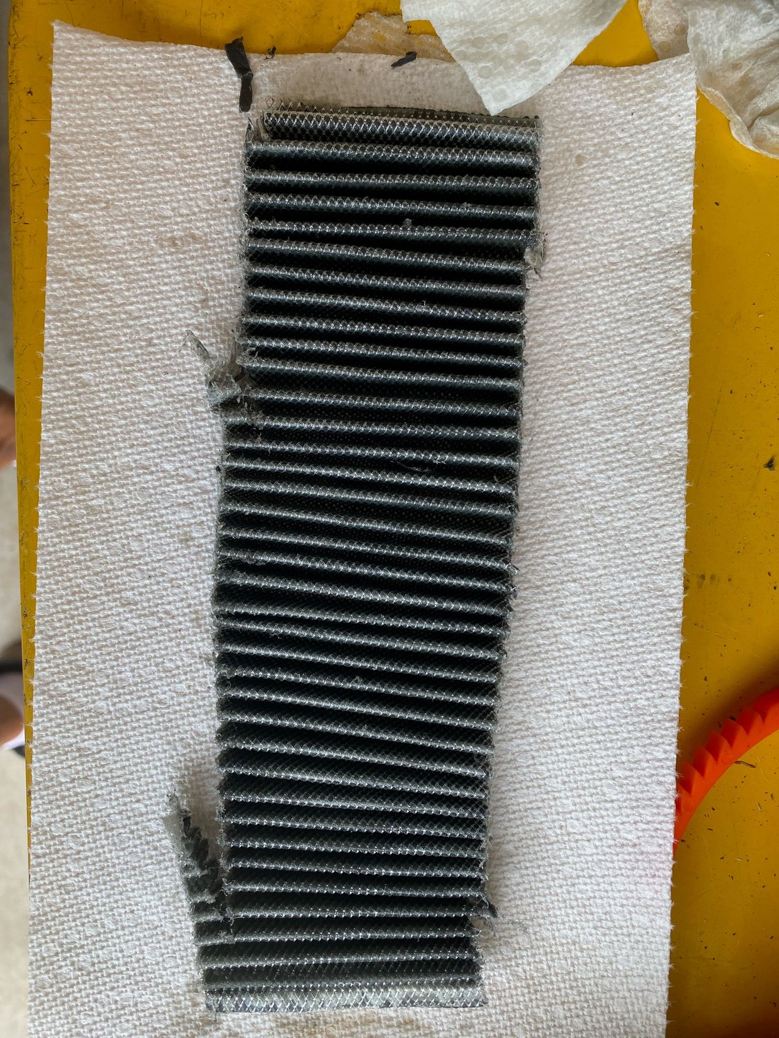

Going to disagree with bhvrdr. While you may have no large debris, the filter is clearly full of the small sintered-type materials that are showing on your white paper towel - that which you termed "debris that looks a bit like jewelers rouge polishing compound bits". If you let the element dry (or wash out the element) you'd be amazed at how much of that material there is. If I had pulled this filter at 2,900 miles I would be glad that I did before any further debris build up.

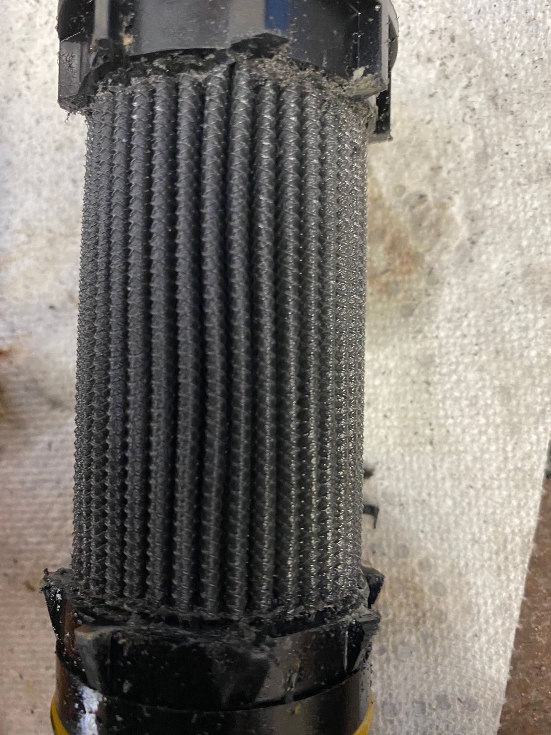

Here's mine from 2,500 miles. No transmission issues at this point. Followed the 1,500 mile break-in followed by increasingly spirited driving. Minimal city-type use.:
Exterior with cage removed ("Clean" side)
Exterior of element ("clean" side)
Inside of element ("Dirty" side)

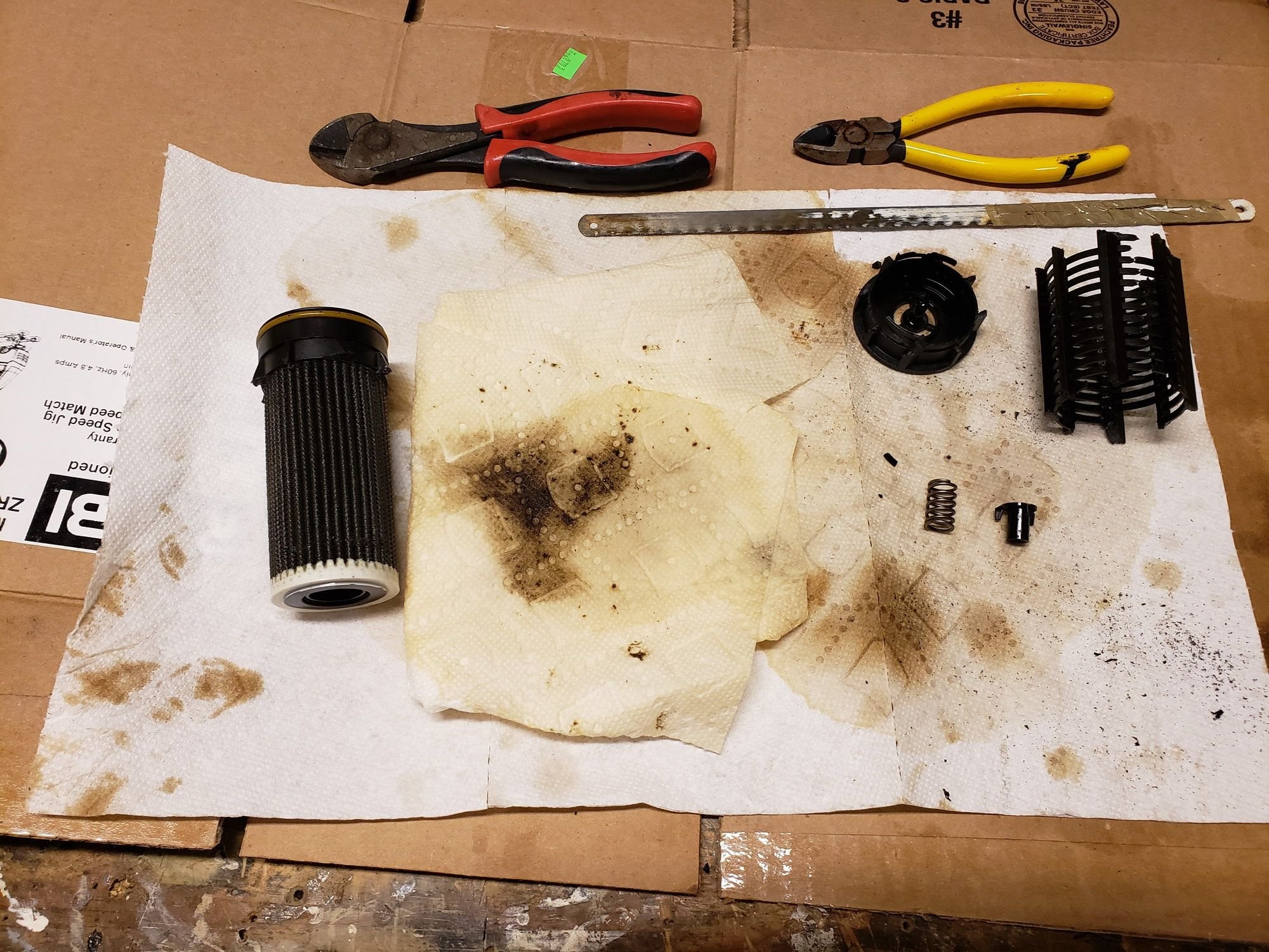

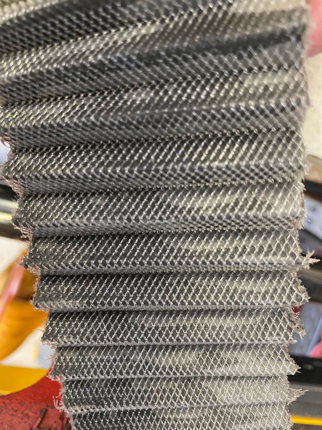

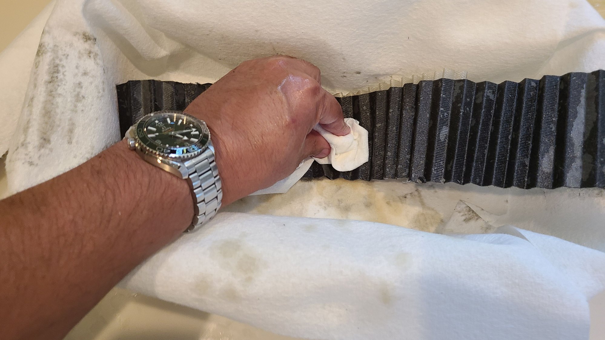

A new transmission was installed at 3,500 miles (case porosity) and here is the filter from that at trans mileage 2,000; vehicle mileage 5,500. Followed the 1,500 mile break-in procedure. Minimal city-type use:
End caps. No reason to believe that the relief valve had ever opened but it was very firmly "stuck" in the closed position. Made a point of exercising the valve on the new filter prior to installation.
Outside view ("Clean" side)
Inside 1 ("Dirty" side)
Inside 2 ("Dirty" side)
Inside 3 ("Dirty" side)

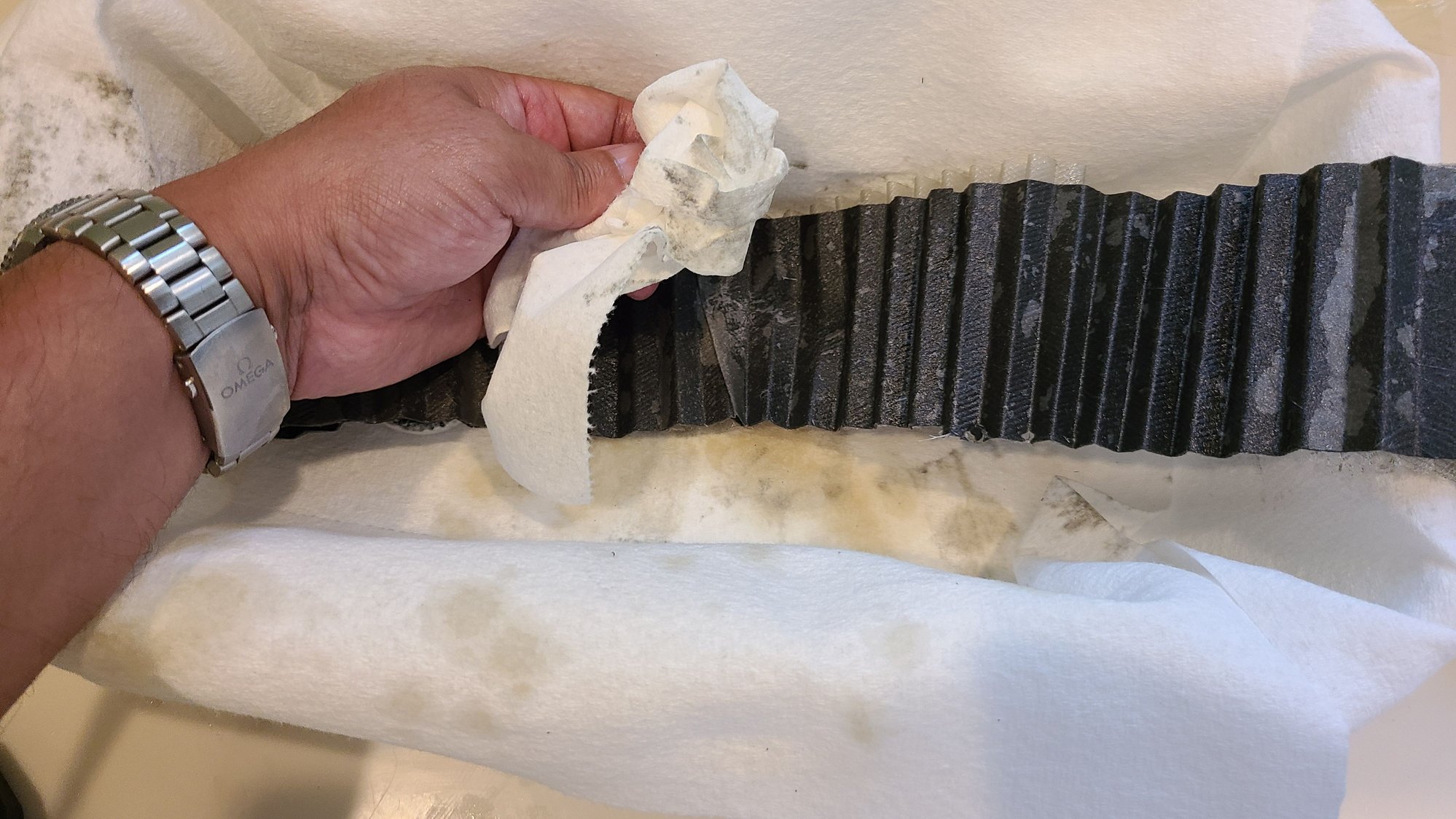

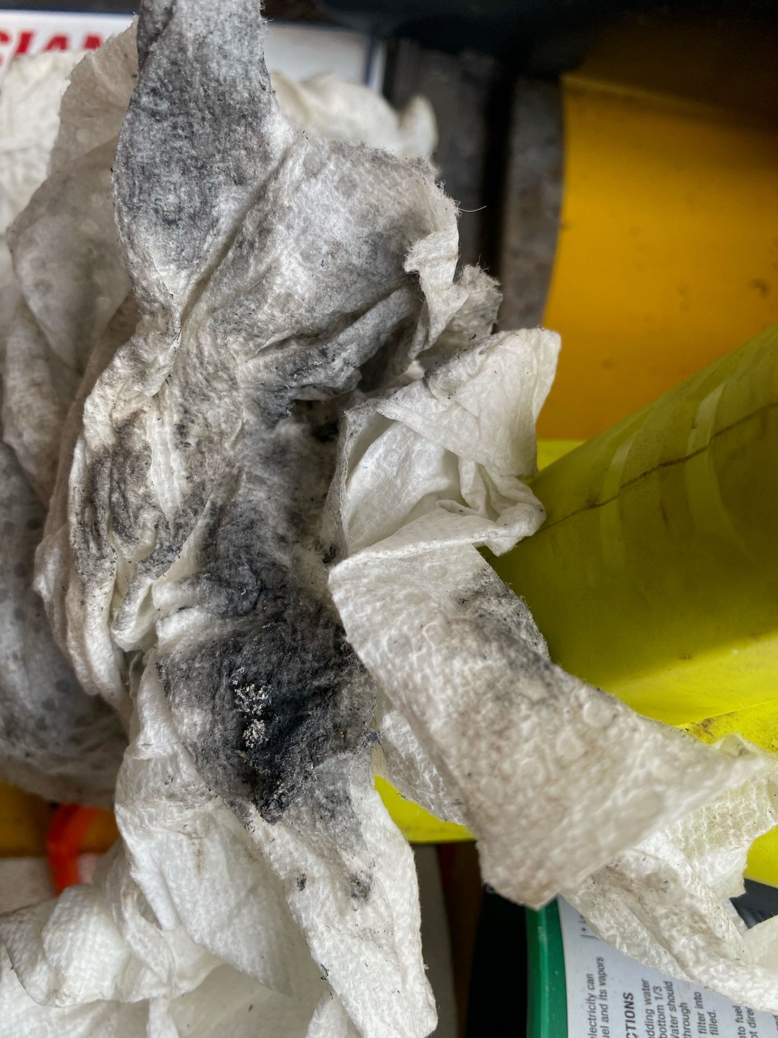

Example of how the fine debris looks after drying and how easy it becomes a fine powder that wipes away
What I personally observed on the second change was how easily the debris on the filter moved and that the way you handle the filter can impact what you "see" and the conclusions you draw. I included the three inside (dirty side) to try and show this. Each picture is of the same area but you can see that the debris in the filter pleats was displaced as I handled the filter and stretched it open. Much of it found its way into the container I was using and the paper towel is a wipe across that container.
My observations is primarily that the way you remove and handle the filter can significantly impact what you see.
  1. When you remove the filter canister the DCT fluid draining from inside the filter can start to wash any debris towards the lower part of the filter.
  2. When you remove the filter you need to keep it as upright as possible and place it in a clean, dedicated pan/container. If you lay it down or into an oil collection pan, there is a good chance that much of the debris will be carried out by the remaining, draining DCT fluid.
  3. When you open up the filter, what you see may not be what you get! The powdery debris seems to flow with the DCT fluid as it drains from the pleats and the mere act of opening up the pleats seems to encourage the movement of the debris from the pleats. So you need to look not only at the debris you can see on the pleats but also the amount of debris that has moved into the container. And the latter can be significant!

thank you so much for posting that!
For clarification
I removed the white plastic screen that covers the actual filter media. For your picture can you remove yours?
If i rub paper towel on the media that still has the plastic mesh on it i get no dark color at all.
I collected both the filter and the fluid dropped with it directly falling into a new clear bag. All fluid in the filter was retained in the bag
The fluid is clear and free of debris.
