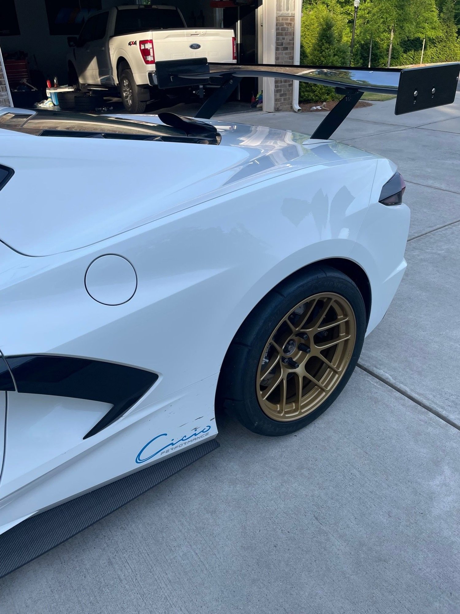

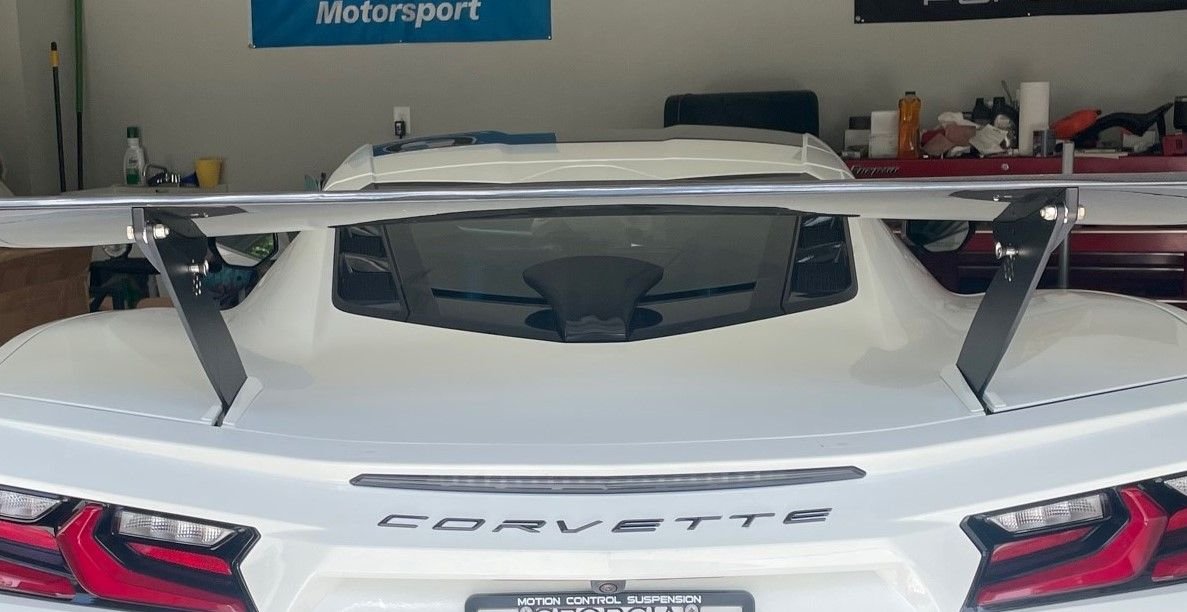

You arent going to meaningfully change the IAT's while still using the factory sideblades as your source for 'fresh air'. I dont know of anyone who has actually changed where the air is being sourced other than me.

You mean all the air that is needed is coming in at the your rear hatch window intake?

All the air needed by the engine comes through the throttle body, which is an area less than 10 square inches, so why not?

That’s pretty cool. Care to give more details and pics ? Especially if it works. Maybe a new thread on this mod

This is an old thread; the car has since been supercharged which changed the intake, the scoop is still utilized to get cool air into the rear to help with IATs, but now IATS are more controlled by the intercooler and ice box than they are the intake scoop. Regardless a ton of heat is generated by the SC so this scoop is still quite functional in that regard.
As for how it was before, i built a custom airbox that ducted to the scoop, the scoop was the only airsource. IATs saw a 6-7 degree drop all things consistent. Marginal results but results none the less.
