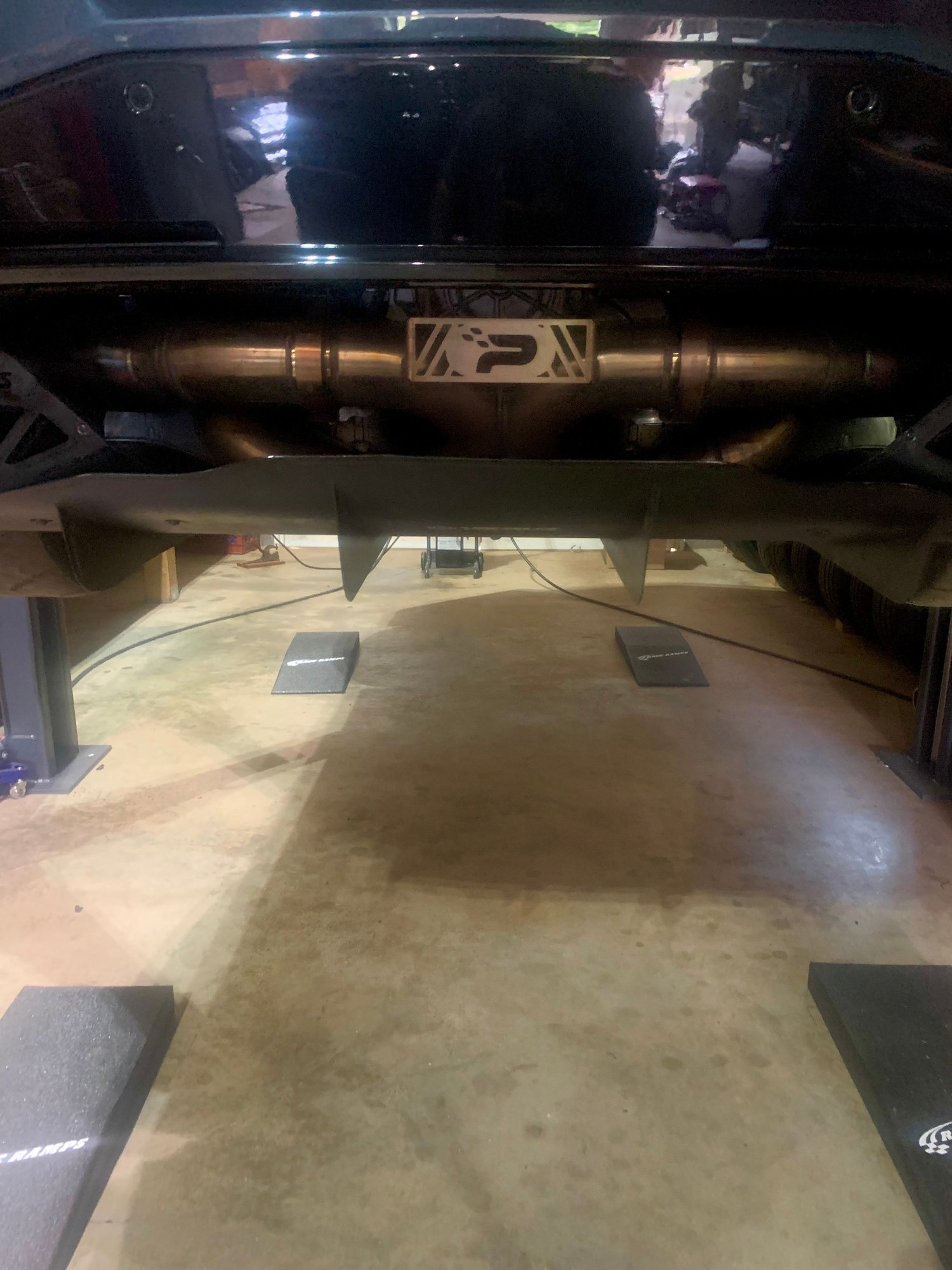

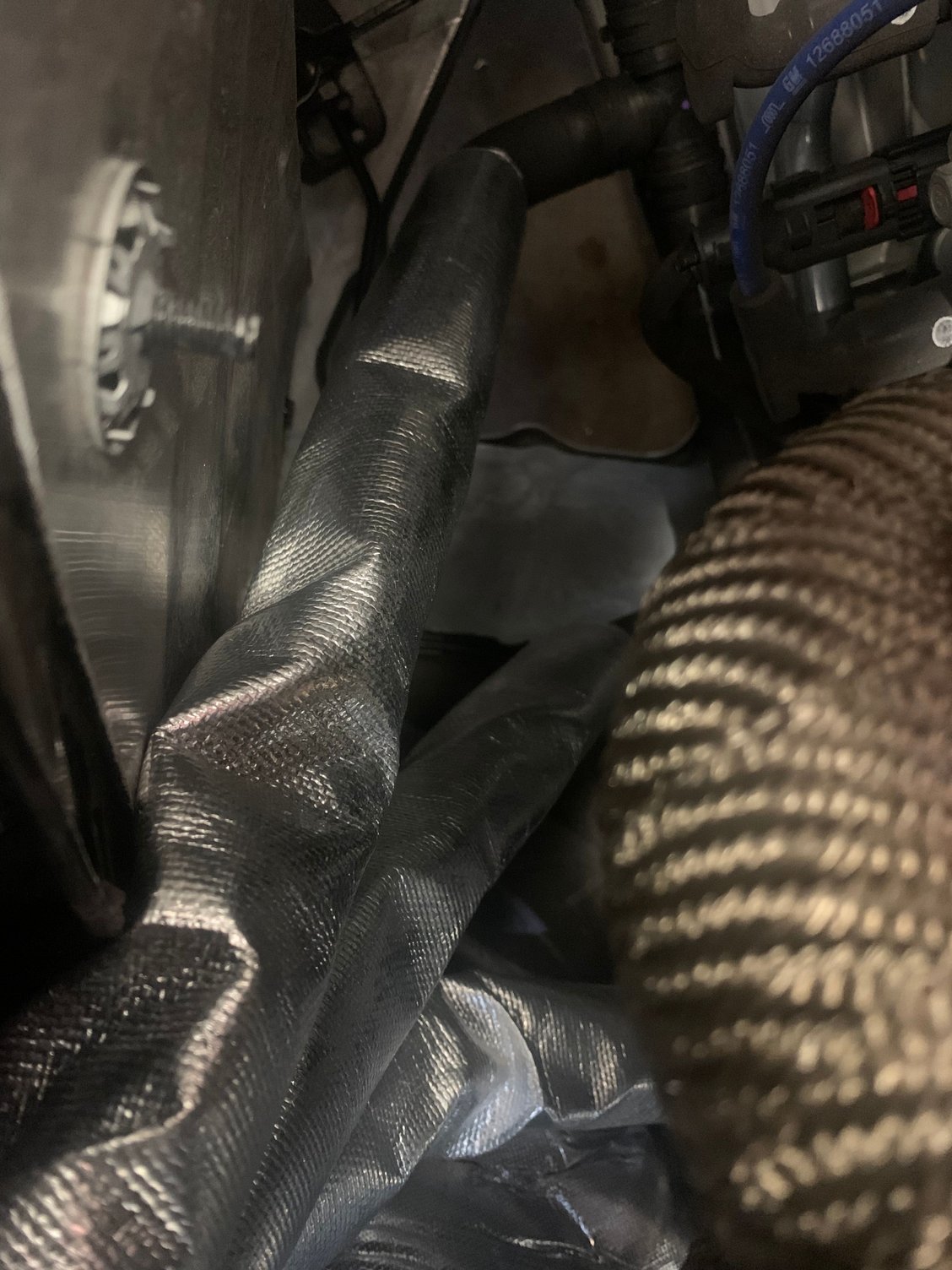

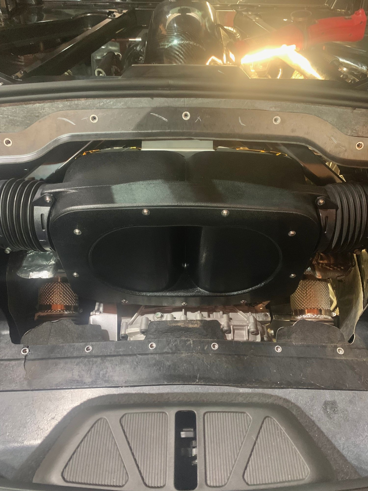

Here’s some ok pics. Sorry for not showing whole rear of the intake in all the gold foil.

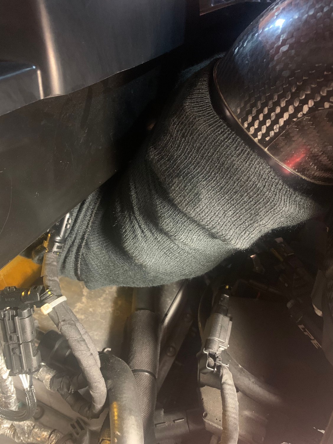

Here’s the Kevlar 24” sock. Pretty tough. Little pain to get on. Doesn’t want to stretch easy but it can be forced.

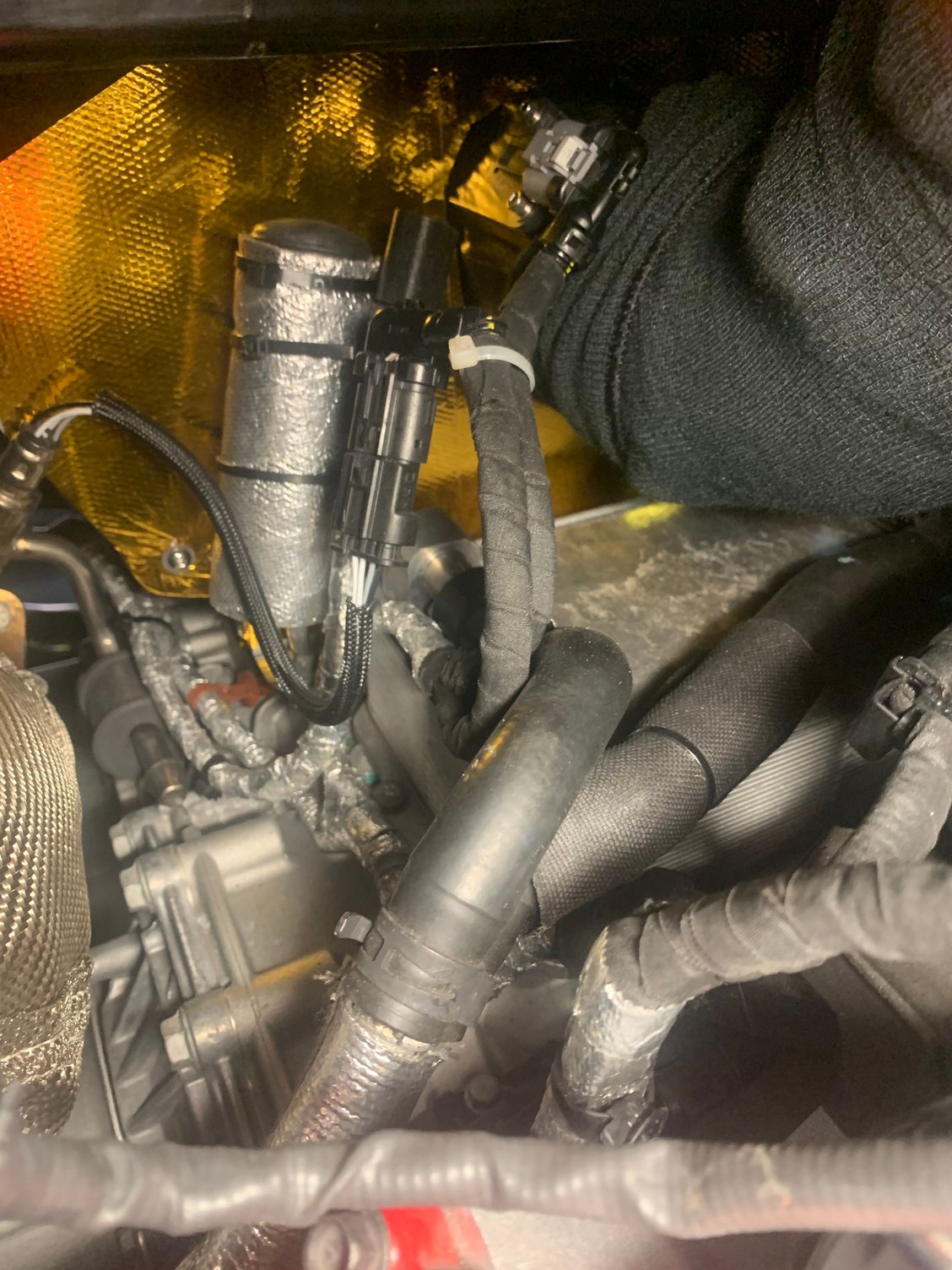

More shielding at the first section on the exhaust.

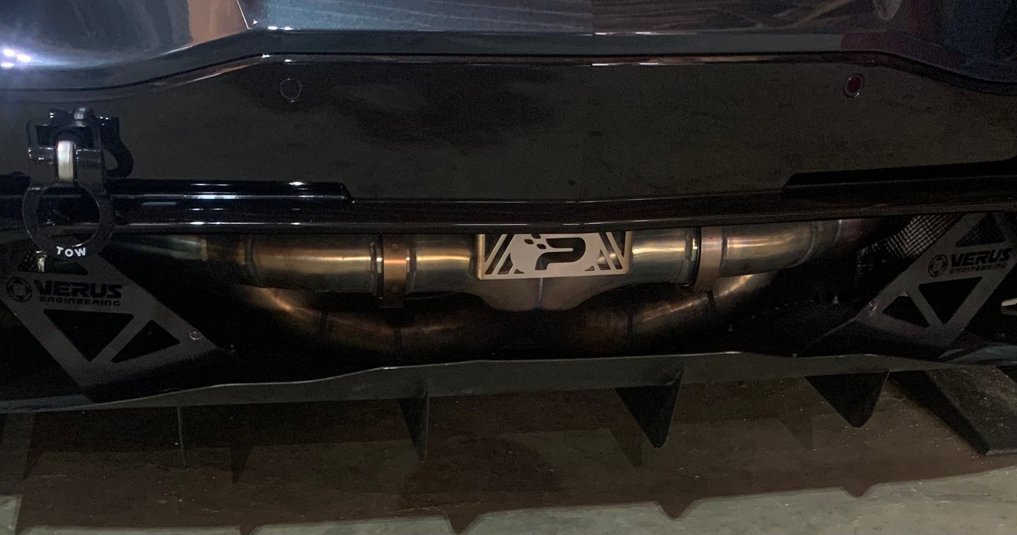

Rear lower valence removed. It was turning yellow and was getting a little brittle. Track heat was tell on a lot of things.

This intake made a deeper tone at idle and accelerations. Sounds really good. Wasn’t expecting that. There is defiantly a better throttle response and believe or it it feels smoother across the range. I did flip my throttle body based on a issue I, others, and Lingenfilter was having and this was their findings to help solve a turbulence issue at the track under certain conditions. So that and maybe the combined mods helped. Only did a 10 minute drive. But it feels a lot better. Just a hair of extra pep. Wife even notice how smoother it was.
My mini cat O2 extensions is slightly rubbing on the metal plate off the Halltech. It’s just closer. Order the 90° version to see if that will work to clear it up. If not. A little trimming will help.
