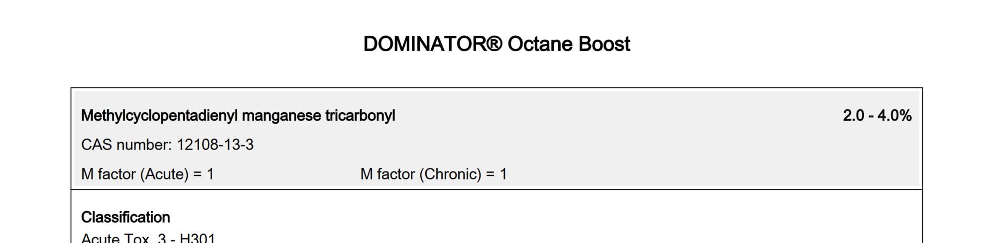

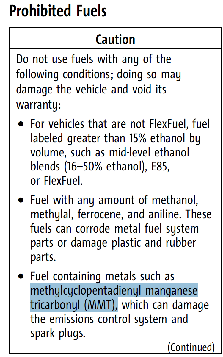

I will not add any fuel additive to my car other than what is recommended in the Owner's Manual. Some additives contain substances that can damage the engine. There is warning in the OM about fuels that can damage the engine and the substances that do so. One of those substances is methylcyclopentadienyl manganese tricarbonyl (MMT), According to the Safety Data Sheet (SDS) for Octane Boost, it contains methylcyclopentadienyl manganese tricarbonyl (MMT) which is listed under prohibited fuels in the OM.
The product "Octane Boost" is recommended by the manufacturer "high performance racing and off road use", and "collector automobiles, older off-road equipment and pleasure vehicles".
Owners Manual Warning:
Substance in Octane Boost from the Safety Data Sheet:

Based on the manufacturer's advertising, VP Octanium Unleaded contains MMT which is one of the substances listed under Prohibited Fuels in the Owner's Manual. The manufacturer appears to say that it is "safe" for emissions systems and catalytic converters when using the "safe blending ratio" provided in the "recommended mixing chart" that is provided. Use your own judgment if you choose to add this to your tank.

Yeah... the MMT does cause orange deposits on the plugs.... It takes a decent amount of use before that happens though.
