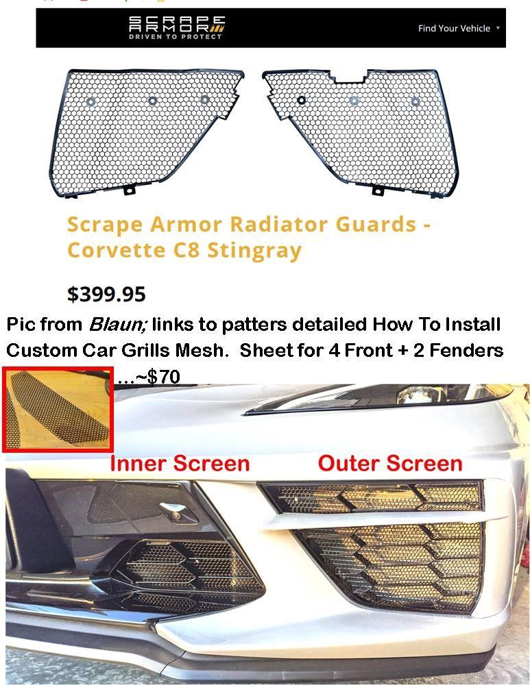

I looked at a lot of info and mesh for my now two-year-old C8 before settling on a mesh many have used with half the size openings as the GM "approved" mesh! Zero increase in coolant temps on 100F degree days in NE SC for two summers. If tracking in 100F Texas Track then consider the GM "approved" mesh size. This company, who specializes in AC Condenser rads, Custom Car Grills now offers that size as well for the same low price of $59 for silver and $69 for Black Power Coat that most used. That is for a cut your own which is enough to do all 4 needed for the font and IF you desired the rear fender sccops. If you don't want to cut your own they offer two kits of precut for the C* one what is needed the 4 fronts AND if you don't care about covering the exposed in rads in the center the two large end rads which is all the GM approved screens cover. The 4 precut ready to install are $99 versus ~500 for essentially the same mesh from the GM approved source
Pcs below and this recently revised PDF How To Install that includes links to info forum member blaun who gives even more detail and patterns for cutting all screens: http://netwelding.com/CF_Splitter.pdf
You can search as I did for various mesh and the % open area. You'll find for example flimsy window screen has less than 50% open area. Plastic uses thick width mesh so the open area is less than a company who specializes selling protective mesh for many Cars and Trucks, Custom Car Grills. They also supply at a low price the raw mesh sheet. It's made from thin aluminum to have the largest open area and thick depth to make the mesh very ridged, so it is keep in place with minimum supports.
Most of us used the top mesh in pic, which is as small as I would use. They have introduced the bottom pic mesh that is about the same size as the GM approved mesh. Lets thru too many bugs and would only use if Tracking in say TX on a 100F day. BUT YOUR CHOICE. There are now copies from China on Amazon and eBay but would not trust the quality. The company has lowered their prices and suggest buying from them directly and use this US made and proven product.

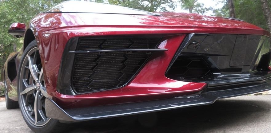

This is my Black Powder Coated mesh installed. My PDF covers installing as I (and many did) by removing the GM grill bar so NO black wire tire attachments are visible - all hidden. It also shows what the install video Custom Car Grill supplies with a few visible but makes a somewhat easier install. Both covered in the many pic/long cation PDF

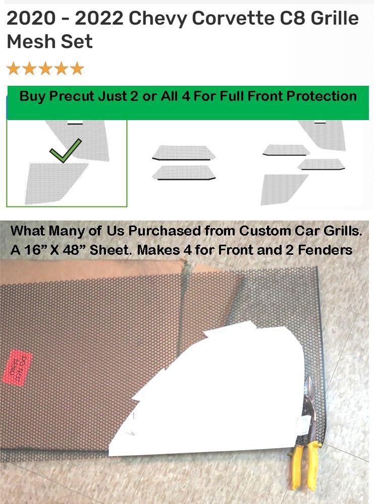

He asked for screens for the front, might as well buy the 4 front screens needed NOT just the two outer openings the GM "approved screens" provide, You can buy a 16" X 48" ridged full sheet of either the smaller 1/4" hex most of us used with no coolant temp increase for street driving OR NOW the same double size hex mesh (lets in twice the size bugs etc) as the GM "approved" screens that cover only the large outer openings NOT the inner front. If Tracking in TX on 100 F days the larger could be the choice. My PDF now includes links to member blaun detailed how too and patterns for all 4 screens if anyone wants to cover the rear scoops. Both mesh sheets are $59 for silver (they are aluminum NOT plastic) or $69 for what I bought, power coated black. This is the How Too: http://netwelding.com/CF_Splitter.pdf
Agree less need for the rear fenders but mesh is a close match the OEM lower rear bumper mesh!
Or if you want precut they have two sets for the C8, one for just the two outer and another for the full four front screens. Since you have to remove the front aero panel might as well be 100% not just 75% protected. Your choice.
Bottom pic is me cutting a front side mesh from a template (forum link a link provided in the PDF.) Cutting is no big deal and ALL edges fit behind the car grill so are NOT Visible.

FWIW, you can protect ~75% with the GM "approved mesh" or 100% for less than 25% the cost!
You can buy a 16" X 48" black powder coated aluminum sheet with the same large mesh size of the GM "approved" mesh that only covers the two outer large areas. Or better if you don't track on a hot day, half that size mesh most of us used with NO coolant temp increase in even aggressive street driving. Stops 1/2 the size bugs! If you don't want to cut your own you can buy 4 precut screens for the front for ~$100. The mesh edges are hidden all behind the OEM grill and NOT visible so the fact that they are not covered is a None Issue!
Both installs require removing the bottom aero panels and inserting behind the grill. If you don't want any wire ties to show you can remove the grill bar (as I and many did to hide them) which is required for the GM Approved mesh install. Your car your choice.
Full details in PDF, including recently added links to details by blaun download @ http://netwelding.com/CF_Splitter.pdf
Note the inner screens are on a slightly different geometric plane so must be installed separately.
