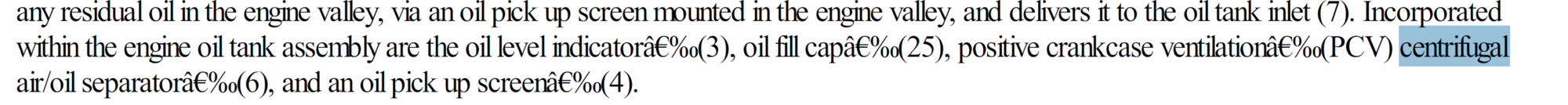

MY RESPONSE:
Yep but a race car dry sump is different!!

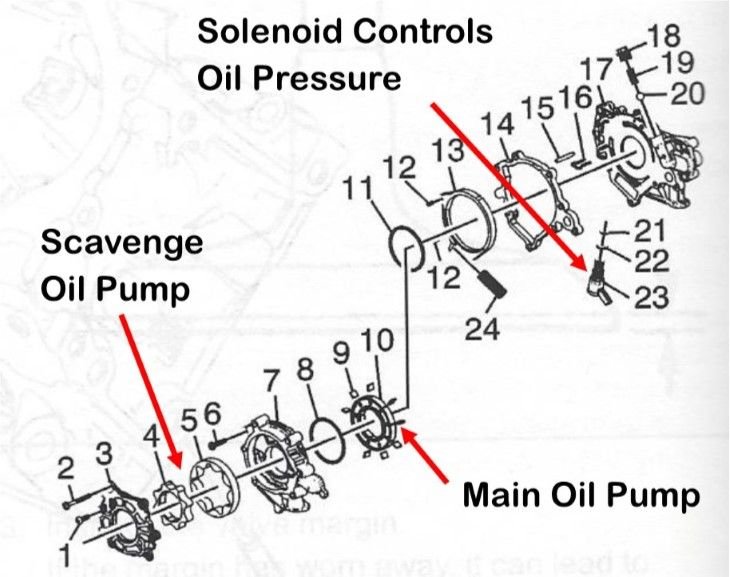

In a race car the scavenge pump pulls a lot of air along with the oil out of the crankcase. To get all the oil out it may have several scavenge pumps. (Note, that creates a partial vacuum that also helps increase power as the crack is spinning in a partial vacuum, less windage loss. In fact the C8 Z06 can achieve ~11 psi vacuum , i.e.only ~4 psi not 14.7 psi of air is in the crankcase so a significant help to reducing windage losses!) That crankcase air (with oil mist) in a race car is vented to the ambient air, no EPA rules.
With a passenger car dry sump EPA says, that air with some oil vapor is not just going into the ambient air! Have to make it go into the air intake. In the C7, if overfilled that meant a lot of oil not just oil vapor went into the air intake tube through the dry sump tank air vent hose! That went into the engine. NOT good. In some cases it just ran down the intake tube, soaked the air filter and dripped on the ground. Also not good.
The C8 has three oil/air scavenge pumps but the same issue. Can't just vent the large amount of air that comes from the scavenge pumps into the ambient air. In the C8 case don't know the path of how that air gets back to the intake but the EPA says it must be ingested!

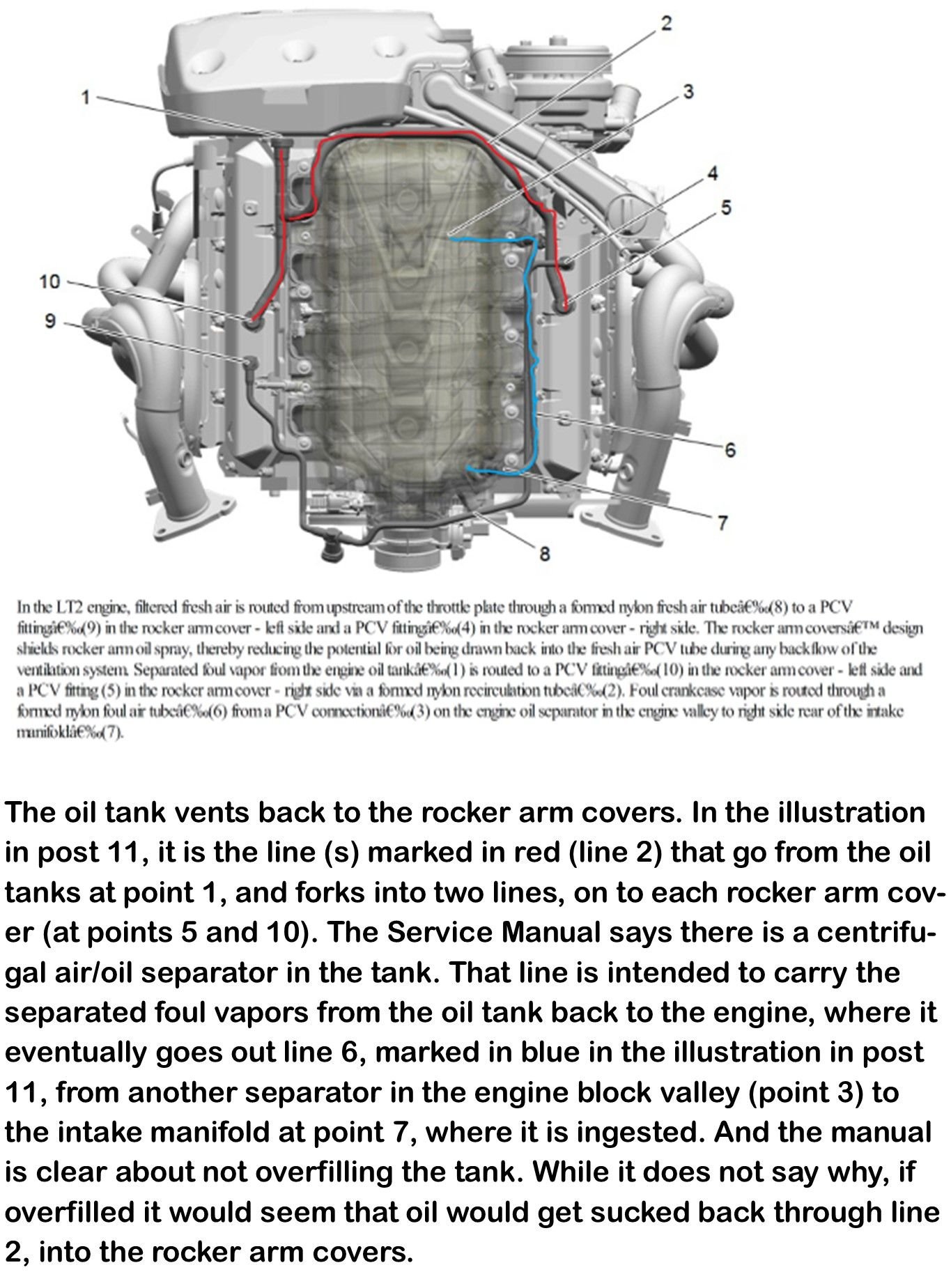

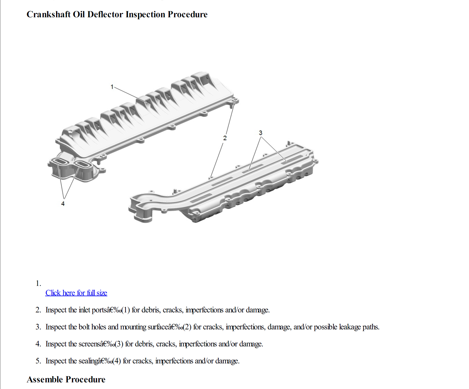

The oil tank vents back to the rocker arm covers. In the illustration in post 11, it is the line (s) marked in red (line 2) that go from the oil tanks at point 1, and forks into two lines, on to each rocker arm cover (at points 5 and 10). The Service Manual says there is a centrifugal air/oil separator in the tank. That line is intended to carry the separated foul vapors from the oil tank back to the engine, where it eventually goes out line 6, marked in blue in the illustration in post 11, from another separator in the engine block valley (point 3) to the intake manifold at point 7, where it is ingested. And the manual is clear about not overfilling the tank. While it does not say why, if overfilled it would seem that oil would get sucked back through line 2, into the rocker arm covers.

Thanks Andy. Your explanation helps but a bit hard to see the pressure difference that causes the "foul air" as GM calls it from one side of the manifold to the other. I'm sure it does from the description but not clear how.
Made a pic for future reference:
Made a
Yes - While the engine block pressure fluctuates, I would assume that an average negative pressure is maintained due to the final PCV connection, line 6, that goes from the engine block valley to the intake manifold (the intake manifold vacuum providing the average negative pressure). The "centrifugal air oil separator" in the tank may also produce some positive pressure in line 2 but that is pure speculation on my part. I looked up "centrifugal air oil separator" and found a patent for it, and some generic examples, but I have no info specific to the C8 on how it works. Note that fresh air to system is provided by line 8, which draws its air from upstream of the throttle plate. Its in the above illustrations from the Service Manual. Here is an actual engine photo - the detail of the those connections my be more clear than in the Service Manual illustrations. I don't have a coupe, so its not easy for me to directly examine or photograph these lines and their connections.

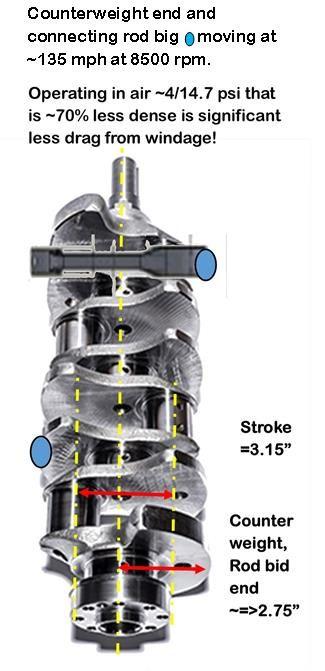

Thinking about the C8 Z06 LT6 and the quoted operating with ~11 psi vacuum or ~4 psi versus 14.7 psi calculated the MPH.
Considering the LT6 can operate at 8500 rpm, that means the end of the counterweight and the rod big end are moving at ~135 mph. Lots of air drag that wastes hp. Much less drag and hp loss in 70% less dense air!

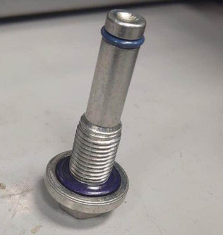

Suspect when draining oil that 'O" ring at the drain plug tip is sealing a passage from the dry sump tank to the pan and why all oil will drain quickly.
Right - to drain excess oil from the tank the engine could (and maybe should) be running so that the oil level in the tank is high. But I was responding to a suggestion that he could actually change the oil just by draining the tank through the dipstick tube. I don't think that would be a good idea.
That is a good point about that second gasket on the drain plug. Perhaps it does help to fully drain the tank when its removed. I never tried to check the tank level before running the engine, so I don't know how quickly it drains down. Also, this discussion makes we wonder how level the in the tank is "regulated". I assume its not. It must pretty much pump most of the oil out of the pan, so the majority of the oil is either in the tank. or in the engine oil lines. It looks like, from the pics attached, that the oil is picked up through a component in the pan called a "crankshaft oil deflector". You can see where it identifies an "oil pump gasket(1)" in the first pic. In the second pic it identifies some screens (3) and some inlet ports (1). Its probably raised slightly from the bottom of the pan so its doesn't quite get all of the oil.

There were two drain plugs in the C7 Dry Sump. One for the oil in the pan and the other for oil draining from the dry sump. Note oil pump is a sliding vain type and computer controlled variable volume (to save energy.) Similar in the C8 (and many modern cars) which is why you see a lower and occasionally step change in oil pressure. The oil scavenge pump is more gear type so oil can flow back when the engine is not running.
