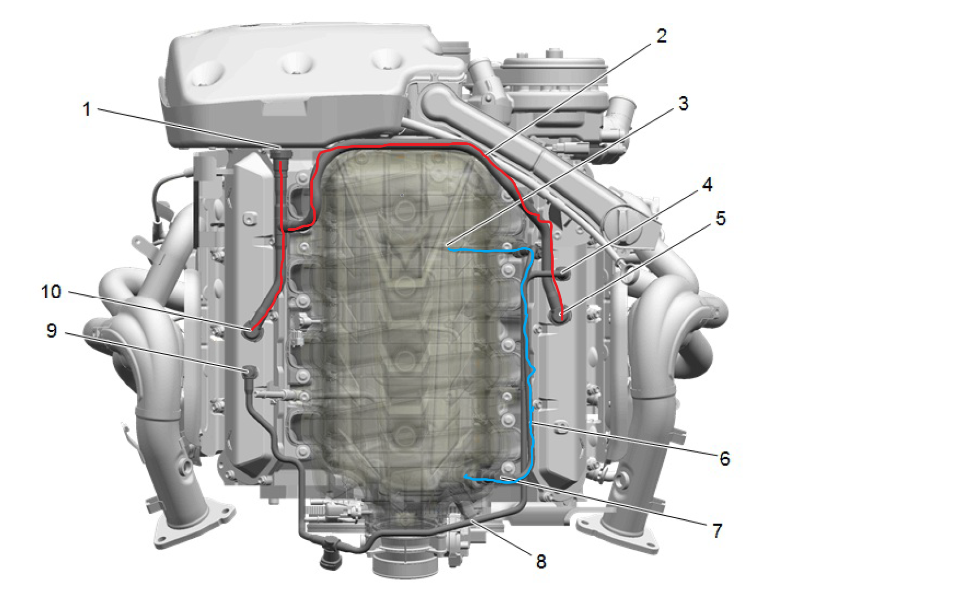

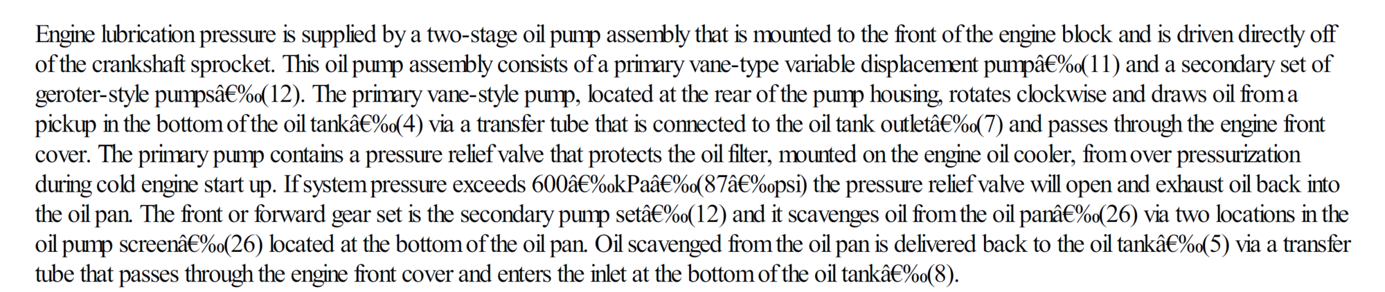

The manual is clear about not overfilling it, and yes, I would drain it (I have the equipment to do that). But I do have a question about the urgency of this. The dipstick is measuring the level of oil in the tank, right? Not in the engine oil pan (such as it is - not much to it). And the reason the oil must be measured when the engine is running is that an oil pump in the engine oil pan scavenges the oil and pumps back up into the tank, where it is then distributed back to the engine parts. When the engine is off, I believe some of the oil tends to run out of the tank at the top, so when measured with the dipstick, it appears that the amount of oil in the system is low, when it actually is not. But since the oil level being measure is in the tank, and not the crankcase, what is the harm if there is excess oil in the oil tank? I do know that there is something called a centrifugal oil separator in that tank, and also tube that is part of the PVC system that vents back to a valve cover. If the level in the tank was way too high, I suppose there could be an issue.

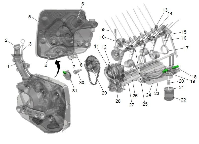

Here are some illustrations and a description of the lubrication system. The photos show the tank, and how the dipstick measure the oil level in the tank.

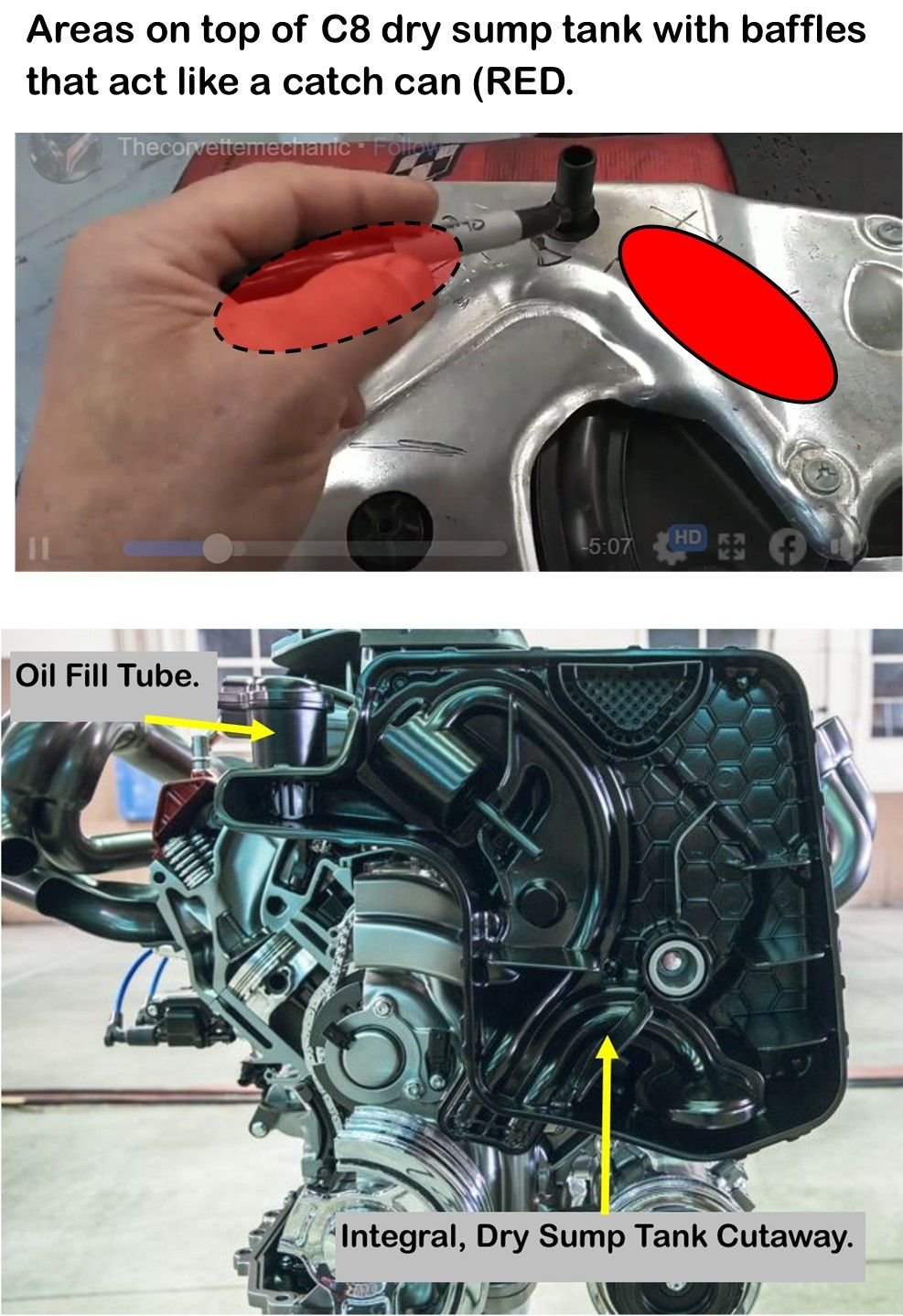

For the C8 the dry sump tank also contains baffles and air that comes in from the 3 oil/air scavenge pumps. Doubt there is a line to the air intake but there are baffles as well as an oil separator that acts as a bit of a catch can BUT has oil that came from the pumps with the air fall back into the tank. Same with some PVC stuff. So not an answer but an indicator of why excess is an issue. Probably not as critical as the C7 or a wet sump (where you need to keep crackcase oil kept below the spinning crack, i.e. why there are pan screens and scampers on my cars) but GM says don't do it so don't!

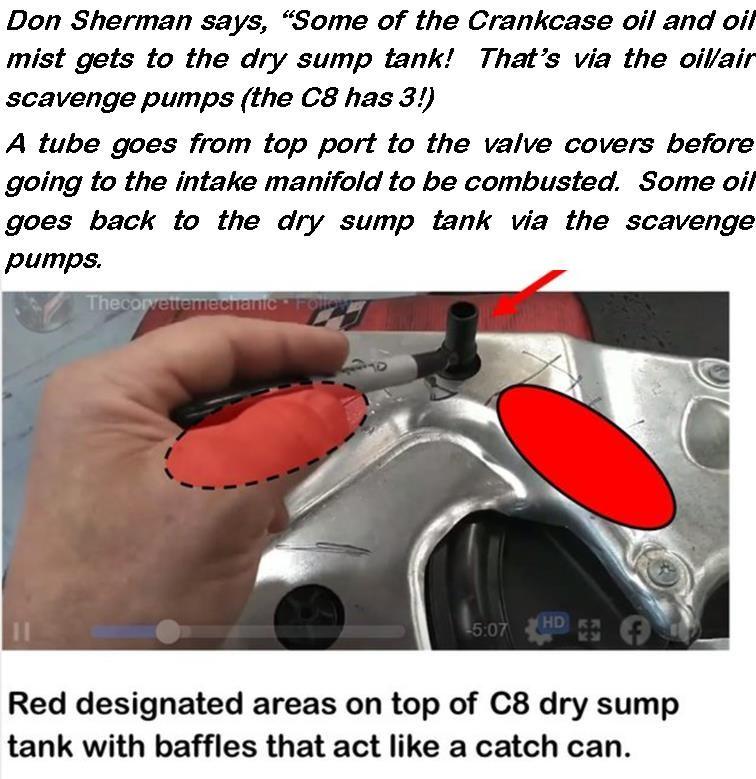

Don Sherman in an article (Great automotive writer, engineer, race car driver) said this re integrated dry sump tank.

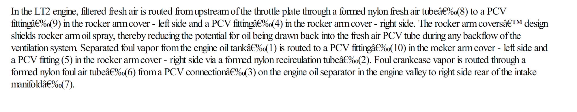

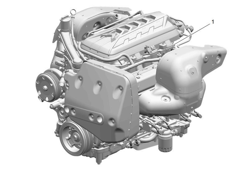

Jerry, thanks. Here are other lines. As I mentioned in my previous post, in the C8 there is a "centrifugal air/oil separator" tank and a tube (part of the pvc system) that goes from the tank, to the valve cover(s). I did not post images of that, but here they are. And yes, if the oil gets too high, something could go south with that. The centrifugal air/oil separator is item 6 in the image I included in post 9.
Here's the image of the tubing - red is the one that vents the oil tank to the rocker valve covers. The blue on is the one that goes directly to the intake manifold - I think it comes out of the "engine block valley". There is an oil separator there too. One more tube, I did not colorize is the one that gets fresh air from upstream of the intake and to the valve covers. Anyway, overfilling the oil tank will cause issues, but I was curious about how that differed from an overfilled crankcase - and you described some ways. Thanks.

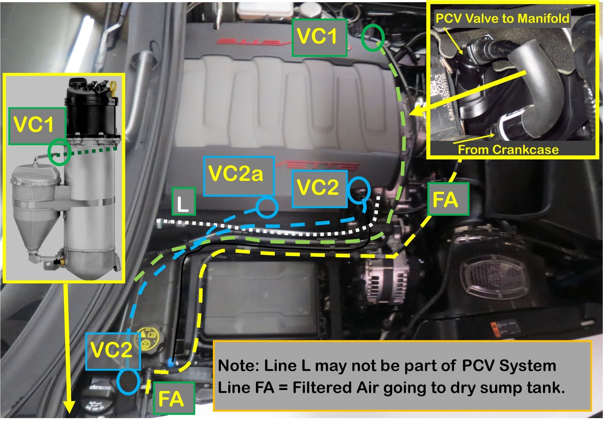

Pic below is what they did to "fix" the C7 dry sum in my 2014 Z51 that was just supposed to have mostly a cosmetic issue with "coking" (the build-up of carbon deposits on the intake valve stem in DI engines.) BUT the pic below is what I analyzed on my 2017 Grand Sport that CHANGED PCV system! Frankly was concerned about installing the "Catch Can" I removed from my 2014 Z51 where I was collecting over 1 oz of stuff (mostly PCV crankcase oil mist) but the lines had changed dramatically. In fact, instead of an obvious extra line delivering clean air to the crankcase to purge blowby etc, that line was not there! Had to block that opening in my aFe air intake tube!
Finally figured all the lines out and where the clean filtered air was coming from so I installed the "catch can" as determined it would do no harm (note I just used a one outlet connection in the PCV line to the intake manifold NOT two- don't Track so not needed.) I was collecting less than 1/2 of what I had been so removed it! I'm confident GM did an even better job on the C8. In fact, Tadge's comment about the Camaro having a built-in air/oil separator that returns condensed oil vapors from the crankcase to the oil tank is one thing they have done.

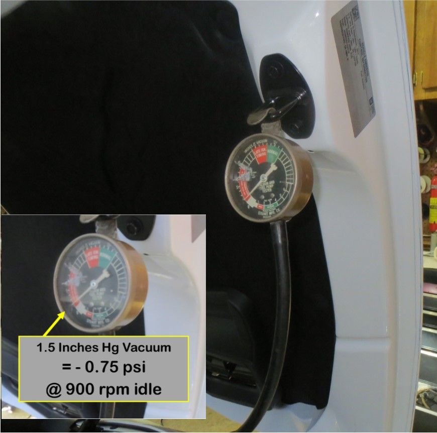

The C8 Z06 LT6 engine is even more interesting, at high rpm the oil/air scavenge pumps, have the crack rods and pistons are spinning in ~11 psi of vacuum! Low windage drag. The 6 scavenge pumps in the LT6 are doing far more than putting oil in the dry sump tank!
Also installed a Vacuum/Pressure gauge and defined where the clean air going to the crankcase was located!

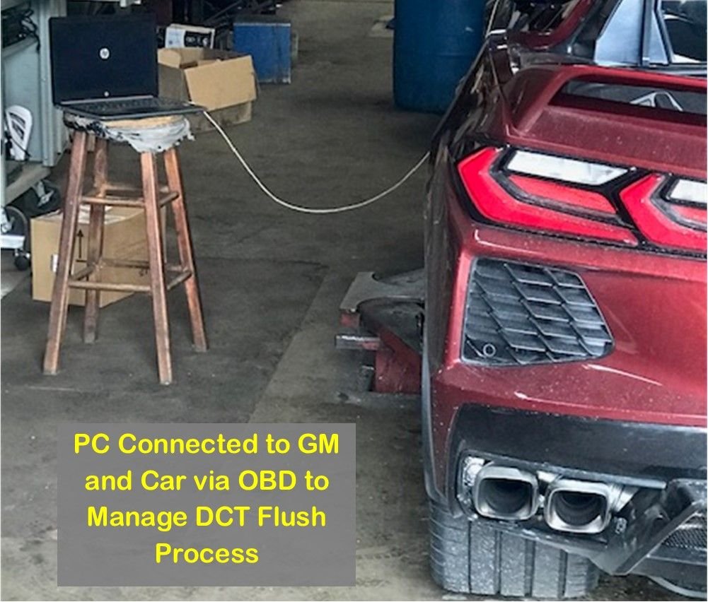

I had him change the DCT filter as well and he did what can't be done on a DIY and specified by GM before the filter change- a flush. Connected to my OBD and GM's Service Computer via WiFi. With the engine running could hear something happening and after ~10 minutes his PC screen said "flush completed" and he changed the filer.

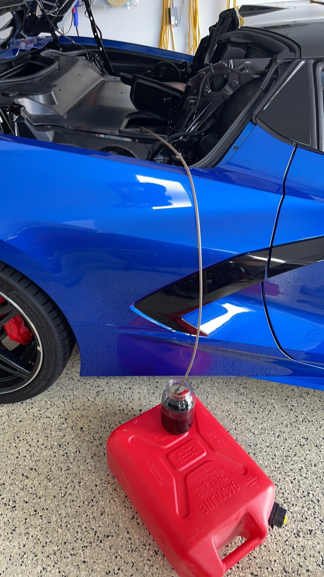

Update- I got the car on ramps and drained about 2/3 of a quart. Its now sitting nicely in the hash mark region. Feels a lot better than overfilled. Amazed at how easy it was- just like a gmc acadia or chevy malibu.
