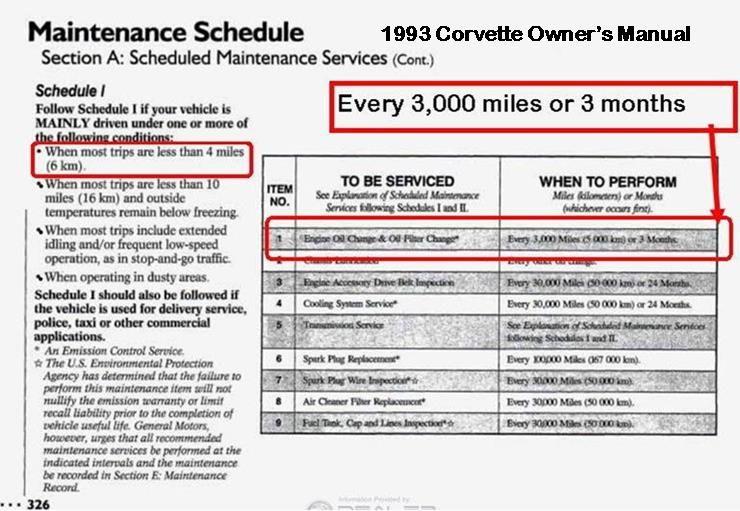

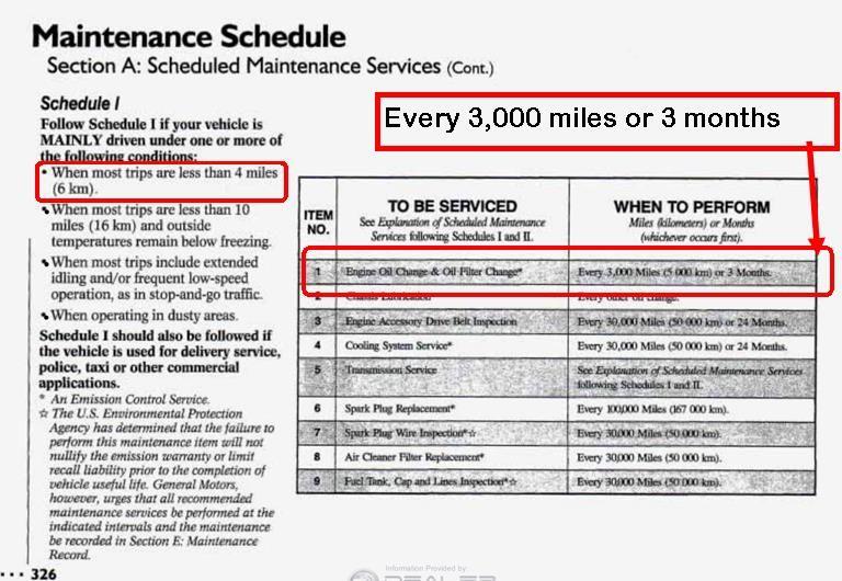

Perhaps what it said in my 1993 Vette Owner's Manual will put that in perspective. Without a very sophisticated OLM all they could say was IF most drives were less than 4 miles CHANGE OIL AT 3000 MILES OR 3 MONTHS WHICHEVER OCCURED 1ST! (SEE manual page below.)
From 1993 Owner's Manual before the OLM was used for Vettes. C8 OLM monitors oil temp after cold starts and IF it does not get hot enough long enough to evaporate much of the water, a major combustion product, it will shorten that 12 month change requirement.

Hmm, you are NOT changing oil because it's warn out at 12 months if you put on say 3000 miles. BUT before the OLM my 1993 Vette said IF most drives are less than 4 miles change oil ever 3 months! How does that hit you!
You are changing min 12 months due to:
  1. Contamination
  2. Depletion of additives
My 1988 and 1993 Vette said change at xxxx miles or 12 months whichever occurs 1st! Miles are actually a silly indicator, are those good highway miles of bad city miles with lots of starts stops etc?? But it and time is what we had.
My 1993 tried to deal with the worse contamination, cold starts and NOT allowing the engine oil to get hot enough long enough to evaporate much of the key product of combustion the passes the cold pistons WATER. In addition the fuel/air mixture is rich to keep combustion going until the ~2500F combustion temps heat and expand the pistons and allow a leaner mixture. One key product that forms is sulfuric acid as water combines with sulfur in oil and fuel! Stuff is corrosive when car is just sitting!
The OLM actually measures the oil temp after a cold start and IF IT DOES NOT GET HOT ENOUGH LONG ENOUGH will lower that 12 months! BTW, the OLM although miles may be an indicator is also using total revolutions a much better indicator. In fact if you look you can actually see the total revolutions number!
