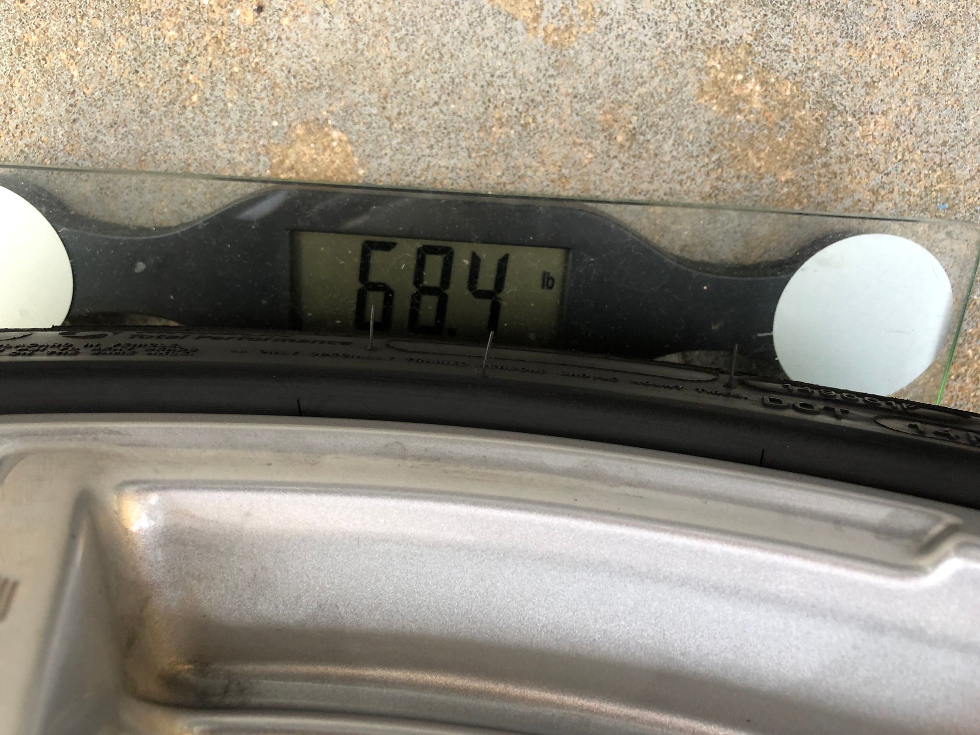

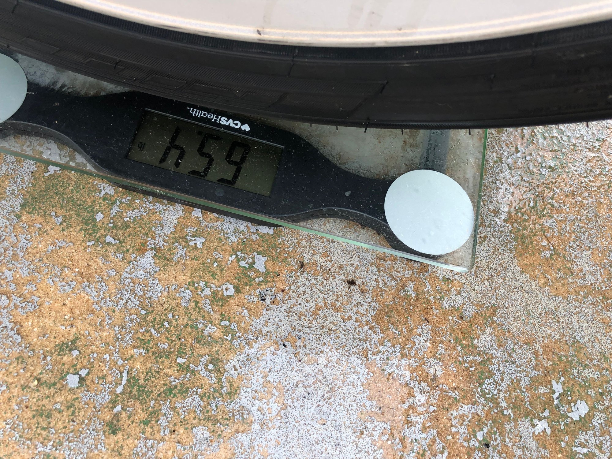

Just adding. The stock weight for my rear all season tires 68.4 lbs. My nitro 305 NT05 tires and wheels are. 65.4 lbs. 3 lb savings. Softer tire. I’ll be at the drags in a couple weeks when it cools down to try the tires. Let you know how they work.
