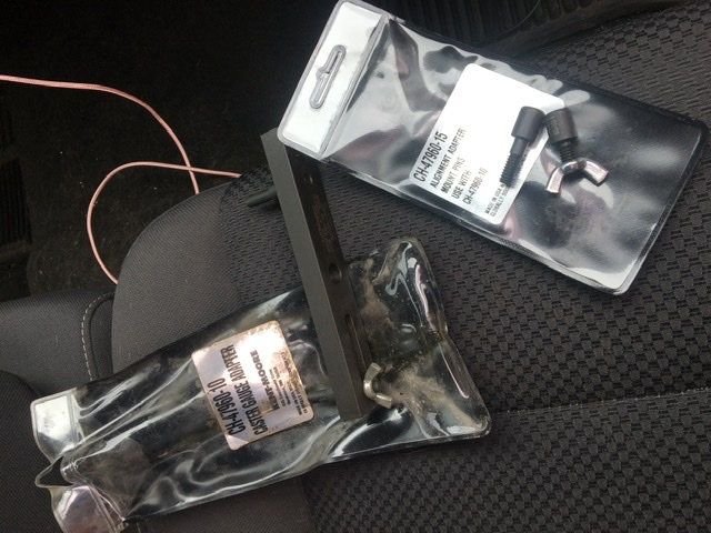

When Wheel Alignment is done on a C8 a Rear Caster tool is needed. Alignment Machines Can Not measure or Display Rear Caster so you will need this tool if Rear Camber is changed.
GM Caster Tool and Pins need for a C8
I ain’t smart, but there is no caster adjustment on the rear suspension of the C8.
Old Oct 21, 2022 | 12:45 PM
c5racr1's Avatar
c5racr1
Joined: Feb 2000
Posts: 3,426
Likes: 568
From: new orleans
Default Caster
There is absolutely a caster adjustment on c8 and c7. If it’s too wrong the car drives like a$$. It can be adjusted by the bottom cam bolts front and rear.
Old Oct 21, 2022 | 07:38 PM
C8gofast's Avatar
C8gofast
Joined: Mar 2005
Posts: 410
Likes: 288
I’ve spent several hours the past couple of weeks working on alignment after replacing the coil overs and 3 hours today under the car with a Hunter laser alignment machine dialing in the camber , toe and front caster.
can you explain how caster is adjustable in the rear? Or why any car would want caster in the rear?
There is no adjustment of the upper a-arm, only the lower. Therefore there is no pivot point to create caster. I suppose you could “not”set the camber bolts the same on the lower a-arm and create a tinny tiny bit of caster, but the camber and toe would be totally whacked.
I’m not trying to argue. I just don’t see how it can be done and GM does not have a spec for rear caster on the C8 .
