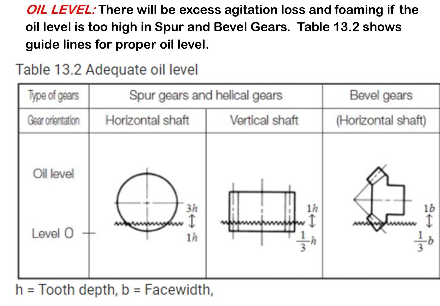

Just a comment and info to ponder, r.e. your statement about why add two extra quarts. Been following this issue since I got my early 2020 Z51. Don't Track but live in a rural area, have 25 mile trip to town and take all back roads where there are sections where there is often, no traffic, there are no homes, or people where I can achieve high lateral "g" turns, safely.
First there is no need for all gears to be bathed in fluid. In fact the specified fluid level for a gears is low as once they start spinning there are lots of oil particles all through the case in a big cloud of oil! See pic below for details. The issue is the DCT uses high pressure fluid to engage its two clutches, the hydraulic actuators that move shift forks, eLSD components, etc in this essentially two 4 speed standard transmissions. The oil pick-up for that high pressure pump is located at the bottom of the case just above the small removable pan.
There has been speculation r.e. high lateral "g" force having DCT fluid move away from under of the DCT Fluid pump, including by myself initially. BUT GM has not said that is the reason! Only a semi official statement was reported at a seminar in Carlisle PA. A GM Rep said the reason is "IF TRACKING AND GOING DOWNHILL AND TURNING THE DCT FLUID MAY MOVE TOWARD THE TOP OF THE CASE." Assume he means away from the fluid pick-up.
Since we have no hills in NE SC I am never in that situation! So even the 1.3 lateral "g" recorded the other day on my PDR (in one of my favorite safe turns,) does not fit his description! To reinforce, in a recent video the Corvette Marketing Manager, Harlan Charles said with the C8 Z06 they changed the oil pan configuration and IT IS NOT NECESSARY TO ADD THE EXTRA 2 QUARTS with the tires that come with the car. That includes the Cup 2 tires and the high lateral "g" they can achieve! He said IF you use racing slicks you might want to add.
BTW Tadge Juechter ,the Corvette Chief Engineer, in an early comment said there no need to remove the extra fluid after Tracking. He said it does cause some extra drag that has a small effect on mpg. Note he never said why they required the addition.
Here are some pics I have used over the past two years that reinforce why I did not and will not add the extra fluid unless it's clear why it's needed. GM says add for Tracking so it should be added. BTW I don't Track, I make many high "g" turns but not sustained or where there are back to back turns as in a Track etc.
GM's method of adding is not cheap as you have to remove the Trunk liner and intake air housing etc to access the high oil fill plug. One tech quote 2 to 3 hours. IMO it's an obvious afterthought and last-minute decision as they could have put the fill plug further back and a simple cover in the truck bottom would be all that was needed to access. Also they did NOT provide a way to check the fluid level with the extra 2 quarts or refill the small amount of fluid when changing the DCT filter.
A reported knowledgeable YouTuber said GM found someone doing sustained foolish donuts (like a NASCAR winner!) That would cause a sustained high lateral "g" force. But I take that comment as strictly roomer. It is possible they discovered an issue making sustained lateral "gs" when measuring on a skid pad? Or perhaps it was not until they were testing at Laguna Seca that has a unique turn called the Corkscrew where you crest a hill then go down a very twisty road while turning?
Lots of pic with comments. Just Sayn!
Per the comment by the GM Rep at Carlisle PA seminar, IF Tracking and going down the Corkscrew at Laguna Seca with it's turn at the bottom or jumping your C8 - add fluid will help!
Good info on what lubrication in a gear transmission looks like! Banks found when developing a dif case cover to provide more fluid for cooling the design was very important to prevent foaming that reduces lubricating properties.
Below top pic shows the fluid level needed for gears. You don't want those spinning gears immersed in lub! In addition to adding drag, it can cause foaming, which is not good for lubrication.
This pic is from the other day on a "safe place" driving home from town. No cars, no homes, no people. Only farm fields. I'm not concerned about the 1.3 "g" I hit in that turn causing lack of fluid or pressure!
