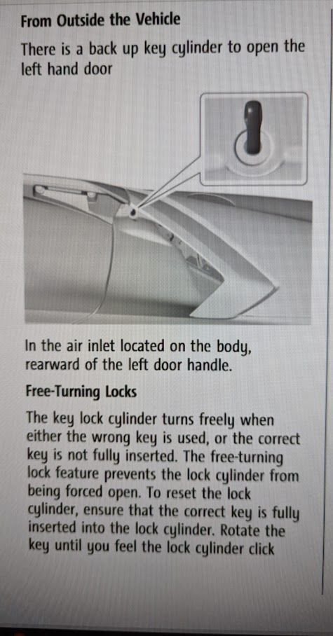

The key into the side intake has to work; its mechanical, not electrical.

Tell that to my car. I insert it and apply pressure in every direction and nothing happens

Have you tried both doors; both keys (you should have two fobs)?
Try the key(s) for your trunk (the access hole is under the plate for a 20, 21 and I think the 22 (no access beneath the plate for a 23).

Try lightly jiggling the door in and out (may have to have another person help) while turning the key.

The manual also says to lube the cylinder locks regularly.
Old Nov 6, 2022 | 08:52 PM
wrecker3's Avatar
wrecker3
Joined: Nov 2003
Posts: 2,843
Likes: 1,862
From: NEW WINDSOR NY

When my 22 SR bricked on OTA download a month ago, I laid on my back and reach up into the driver door cylinder with manual key and small flashlight. Easier to see key hole. You have to twist clockwise pretty hard and use left arm/ hand to press exterior door button at same time. It was tricky but will open.took 2 attempts and the door opened. Positioning your body to get to the cable under the brake pedal was even harder. Used a soft mat for knees and worked my body between seat and brake area. Used a 3-4 inch long, 1/2 inch ratchet extension to put through loop in cable to help pull cable. I could not do it with my finger as the cable wants to tear into your finger. After getting frunk opened, jumped battery, took for 30 mile drive to charge up battery. After several days downloaded OTA a second time and it worked. No problems since.

Have you tried to lubricate the side vent door lock? That is the one that baffles me. Makes me want to go out and try mine. 2020 with 20k miles, and I have never tried it. I have used my trunk mechanical lock, so I know it works.

I would continue to try getting in using key under driver's door air vent.
