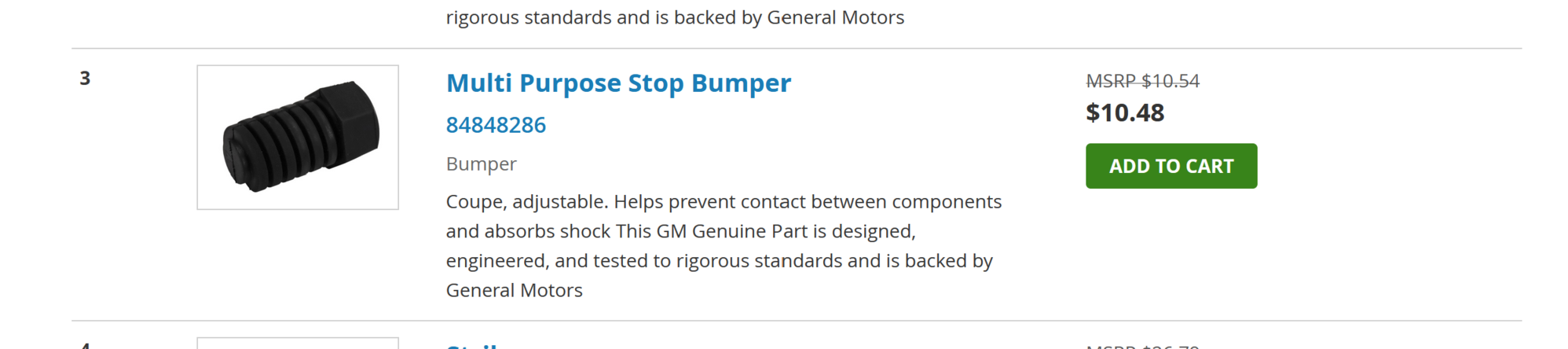

I'm not saying that this would correct your problem - I see you indicated that you dont want to put pressure on the lid - but I ran across this in the parts listings while looking up other stuff - apparently those bump stops are adjustable, at least according to the parts list description. The base looks like a coiled plastic spring - I think maybe that base must be turned to install and adjust it. Here is the parts listing - and you can see what it looks like not installed. I think if may be more to provide the correct pressure on the lid so that it pops up enough to open it with your fingers rather than being to adjust the height of the lid when its closed. Someone in another thread had that problem where it would not pop open enough - and fixed it by adjusting these stops.

Interesting, something for thought.
