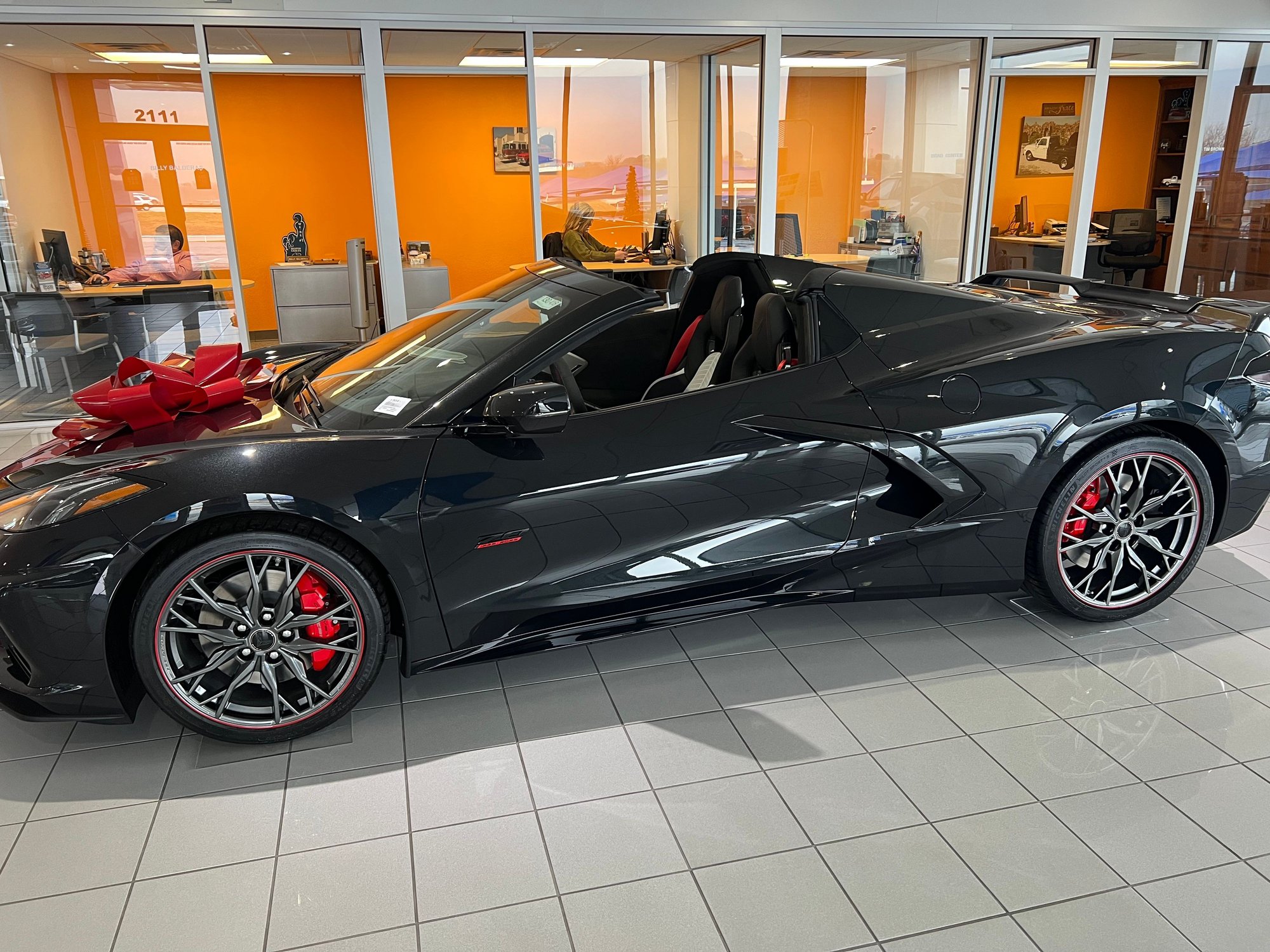

Hey all! I’m picking up my 70th anniversary Stingray on Tuesday.
First ‘vette for me!
I will be doing a fair amount of tracking her and I’ve heard about the “have the dealer add two quarts to the trans” issue.
I’ve told them to do that Monday before I pick it up but my question is this:
should the ask them to drain and verify a full (+ 2) fill? I’ve heard several people say they didn’t get a full full from factory.
I plan to put some hard track miles on her and i want to get this right up front.
What’s the best practice? Thank you!!!
