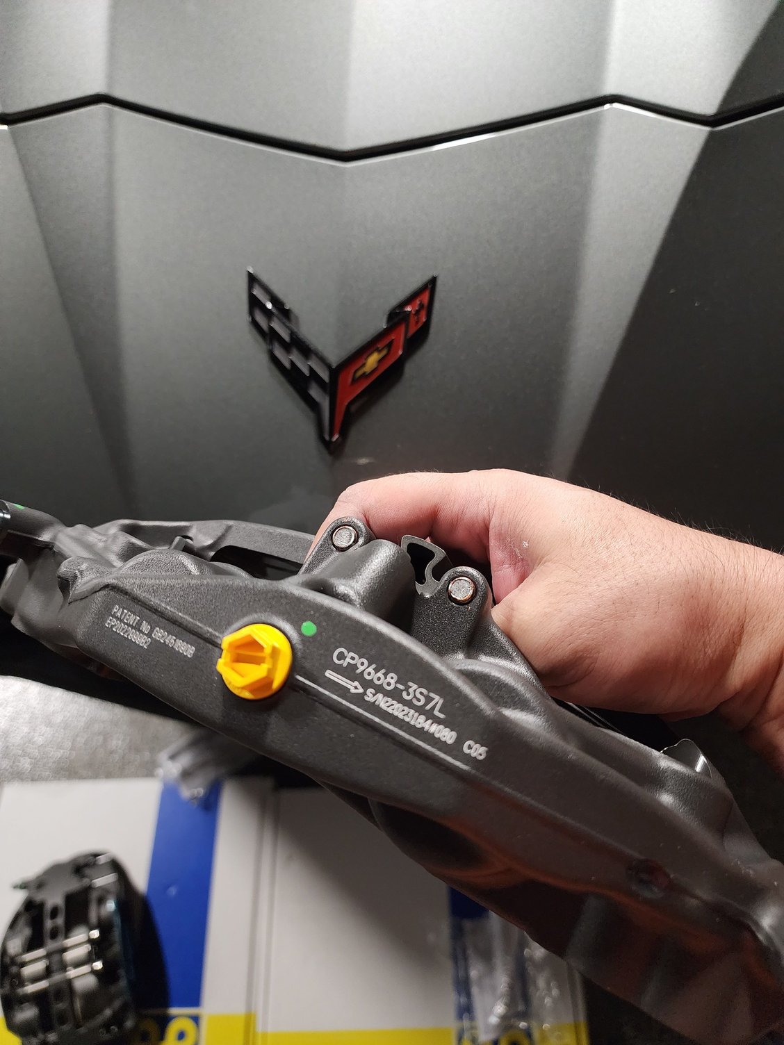

I use xp12 and 2 sets of stock rotors and same issue. I got tired of it and ordered the AP competition kit 9668 today and will get it Friday. I am tired of dealing with warp rotors
