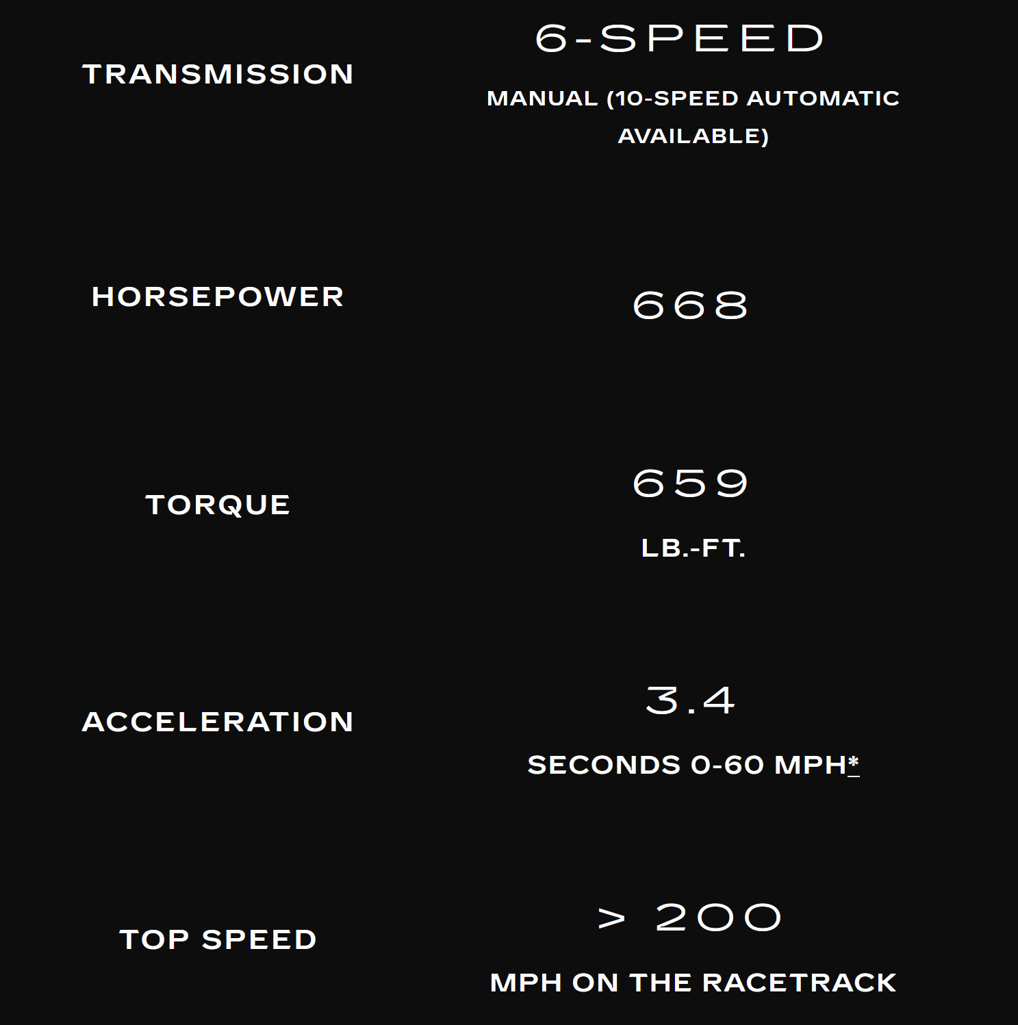

Cadillac claims the CT5-V Blackwing has a top speed "greater" then 200 mph on the track, with 668 hp.
