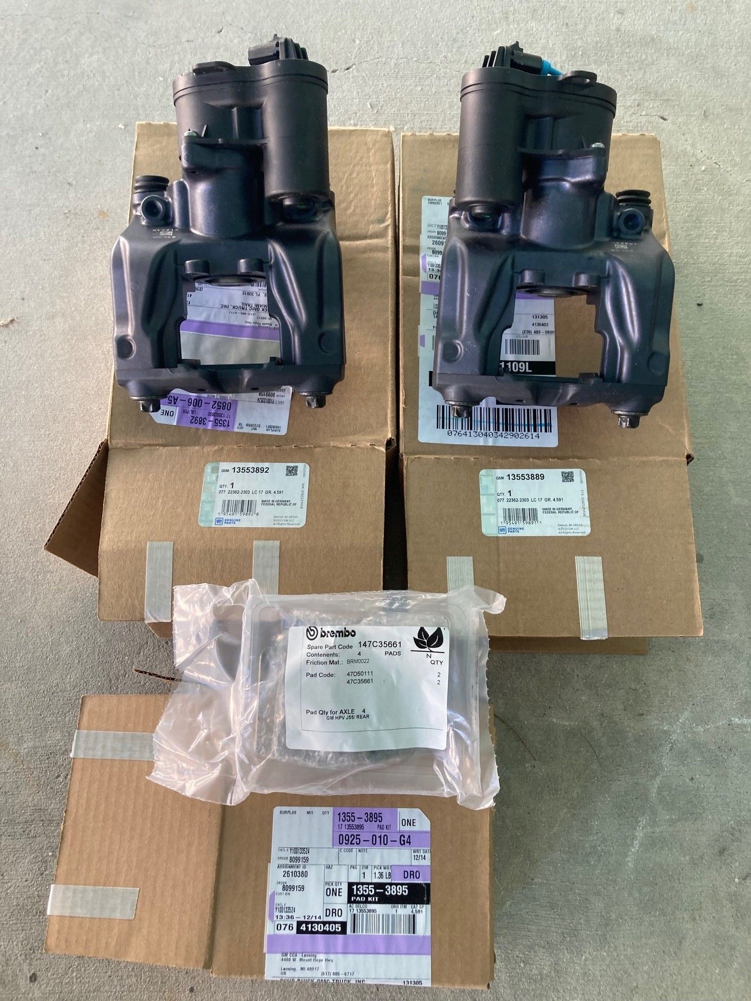

The wife was over in Ft. Myers this week and picked up my parts. I have e-brake calipers, e-brake pads, rotors (they are huge), brake lines and shields. Only thing I'm missing are the pin and springs for the e-brake calipers, again why the hell aren't these shipped with the calipers???. I wasn't able to order before, will check again. I may pull the rear wheel off my car to see if somehow the base C8 stuff might work. Honestly, I'm not hopeful. This my slow down the install.
I need to get more fluid and find some instruction on bleeding the brakes. I did buy a pressure bleeder some time ago but have never used it so need to research that as well.

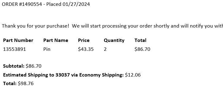

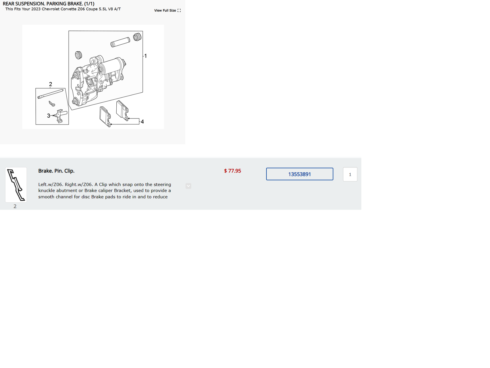

Fricking e-brake caliper pin kits. This was response I got from a reliable online seller I've bought quite a few parts from after ordering yesterday. As a sidebar, https://parts.gmparts.com/ GM's online parts house doesn't even show a pin kit and doesn't list 13553891.
Thank you for choosing GMPartsDirect.com and placing your 1490554 with us.
This order is on hold awaiting your response.
Part number 13553891 is currently on back order from GM and it has been removed from your order. GM does not have an ETA for the part to be released off back-order.

I'd guess that those pin kits would be compatible across models, and you should be able to use it from your base/Z51 e-brake caliper.Looks like they don't sweep the whole rotor anyway, and the only difference is their offset due to rotor diameter differences across models. I bet the pads would be same, too.

So did a bit of research this morning. I can't seem to find any aftermarket e-brake pin kits for the Z06. That said, Dynamic Friction Disc 340-16007 is made for the base and Z51(and 1000 other cars) and at $22 shipped is worth a try. Note also both sides included for $22 unlike GM.
The rotor on the Z06 appears to be about 8-10MM wider than the base and Z51 which may present some issues. The pins in all the pictures I see look to run long so they may be finei, not so sure about the spring. We'll see.
Standard e-brake from ebay.
