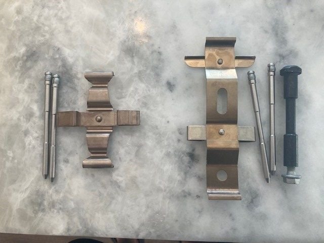

Small update, just received the pin kits for the front and rear caliper. I didn't know if I needed one or two pin kits,, I now know I needed two of each. An awful lot of money for what it is and why the hell didn't they come with the calipers?
Rear kit on left, front on right

Edit: That pin kit looks identical to C7 stuff, and I think I only paid $20-30 at the time... That pricing is definitely unacceptable : (

WIll do brother. I suspect the front may be the same as some of the C7 parts. I almost ordered one but chickened out. The rear caliper I believe is new so probably only one that would work.

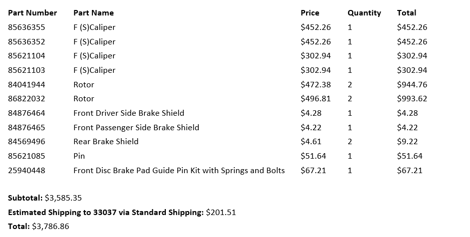

One last post. As best as I can tell at this point I've bought everything less brake fluid and the pin kit for the e-brake calipers (more on that later). Based on my new spreadsheet, I'm at $5174.

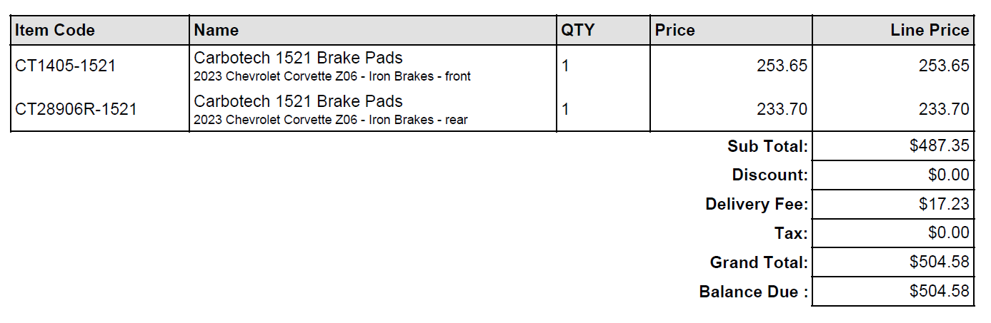

I did receive the second set of pin kits for the regular calipers, what a rip off. I also got the CarboTech pads from KNS.
